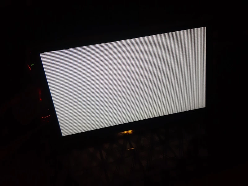

Using  0xD0000000 and
LTDC_PIXEL_FORMAT_RGB888 / DMA2D_INPUT_RGB888 / DMA2D_OUTPUT_RGB888
instead of
DMA2D_INPUT_ARGB8888 / DMA2D_INPUT_ARGB8888 / DMA2D_OUTPUT_ARGB8888
I see these vertical lines
Tesla DeLorean
Guru
Apr 24, 2024 10:03 PM UTC
Ok, but it's just reading, or failing to read, a consistent pattern from the Frame Buffer.
Not really convinced that the SDRAM or running it at full bandwidth. Can you dump in a Memory View in debugger?
Is the system still hanging when you write to the Frame Buffer?

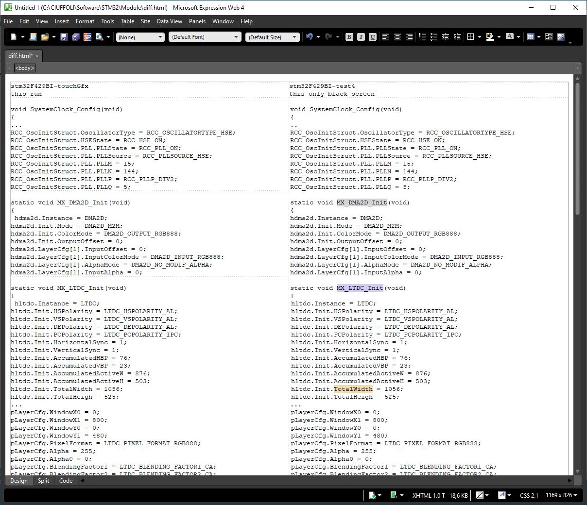

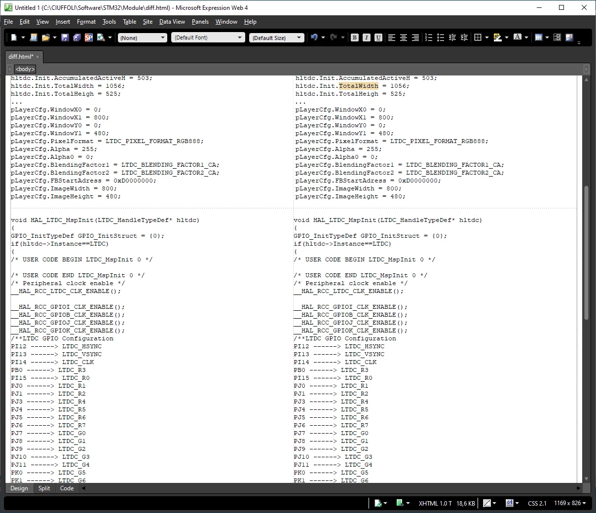

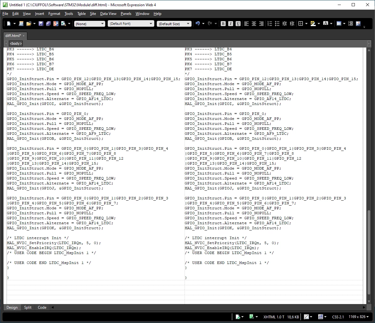

A new info, starting from TouchGfx project I have made 2 simple modifications
//MX_TouchGFX_Init(); <<<<<<<<<<<<<<<<<
BSP_LCD_Init(); // add now
BSP_LCD_Clear(0x00FFFF00); // add now
void StartDefaultTask(void const * argument)
HAL_TIM_PWM_Start(&htim4, TIM_CHANNEL_2);
//MX_TouchGFX_Process(); <<<<<<<<<<<<<<<<<
and now I see only vertical lines like in previous project
so the problem could be in the BSP_LCD_Clear()

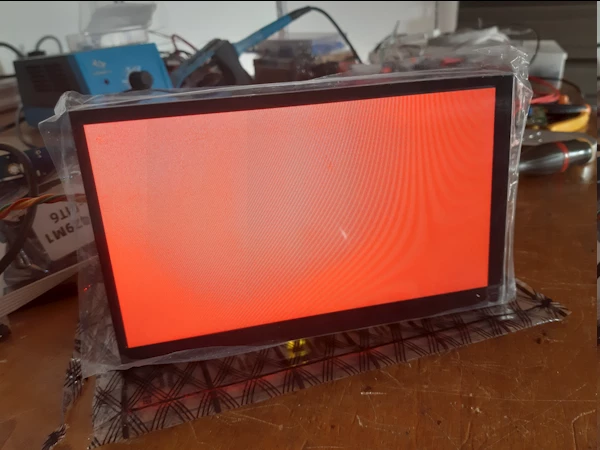

Apr 25, 2024 3:55 PM UTC
Now Work!
Changed from
DMA2D_OUTPUT_RGB888 / DMA2D_INPUT_RGB888 / LTDC_PIXEL_FORMAT_RGB888
to
DMA2D_OUTPUT_ARGB8888 / DMA2D_INPUT_ARGB8888 / LTDC_PIXEL_FORMAT_ARGB8888
This set
#define HBP 80
#define VBP 40
#define HSW 1
#define VSW 1
#define HFP 190
#define VFP 22
#define LCD_Width 800
#define LCD_Height 480
#define LCD_Pixels 800*480
#define LCD_MemoryAdd 0xD0000000
hltdc.Init.HorizontalSync = HSW - 1;
hltdc.Init.VerticalSync = VSW -1 ;
hltdc.Init.AccumulatedHBP = HBP + HSW -1;
hltdc.Init.AccumulatedVBP = VBP + VSW -1;
hltdc.Init.AccumulatedActiveW = LCD_Width + HSW + HBP -1;
hltdc.Init.AccumulatedActiveH = LCD_Height + VSW + VBP -1;
hltdc.Init.TotalWidth = LCD_Width + HSW + HBP + HFP - 1;
hltdc.Init.TotalHeigh = LCD_Height + VSW + VBP + VFP - 1;
PeriphClkInitStruct.PeriphClockSelection = RCC_PERIPHCLK_LTDC;
PeriphClkInitStruct.PLLSAI.PLLSAIN = 60;
PeriphClkInitStruct.PLLSAI.PLLSAIR = 2;
PeriphClkInitStruct.PLLSAIDivR = RCC_PLLSAIDIVR_2;
