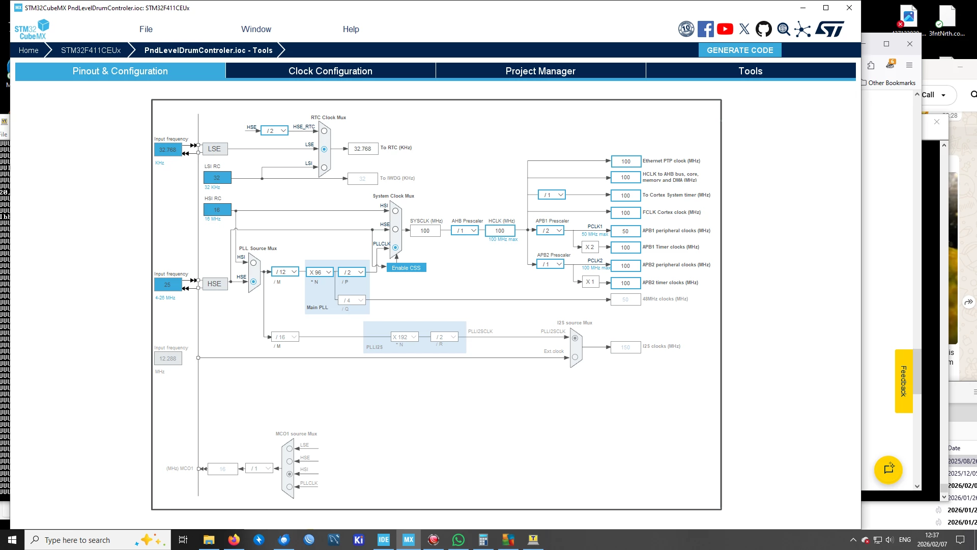

erastusCAuthor
Feb 7, 2026 10:54 AM UTC
Hi Peter,
Thanks for the info. What I understand is this configuration selects the Crystal for the RTC.
Am I doing something wrong?
The line of code according to the documentation should either increase or decease the clock.  The Freq on the Oscilloscope remains 490Hz no matter what I do to the 0x1F0 value.

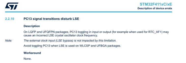

Feb 7, 2026 9:36 AM UTC
... or the LSE circuit is badly disturbed by the calib-out signal.
PS. [rant mode on] Couldn't errata be proof-read? Those references to packages are a mess.
erastusCAuthor
Feb 7, 2026 10:55 AM UTC
Thank you for your response.   DO you suggest Once I do the calibration I disable PC13 pin as it might affect the crystal osc?
EThom.3
Senior II
Feb 12, 2026 4:27 PM UTC
The way I read the errata sheet, you can't even use PC13 for calibration, as (ironically) the signal you use in the calibration process may disturb the very clock you want to calibrate.
