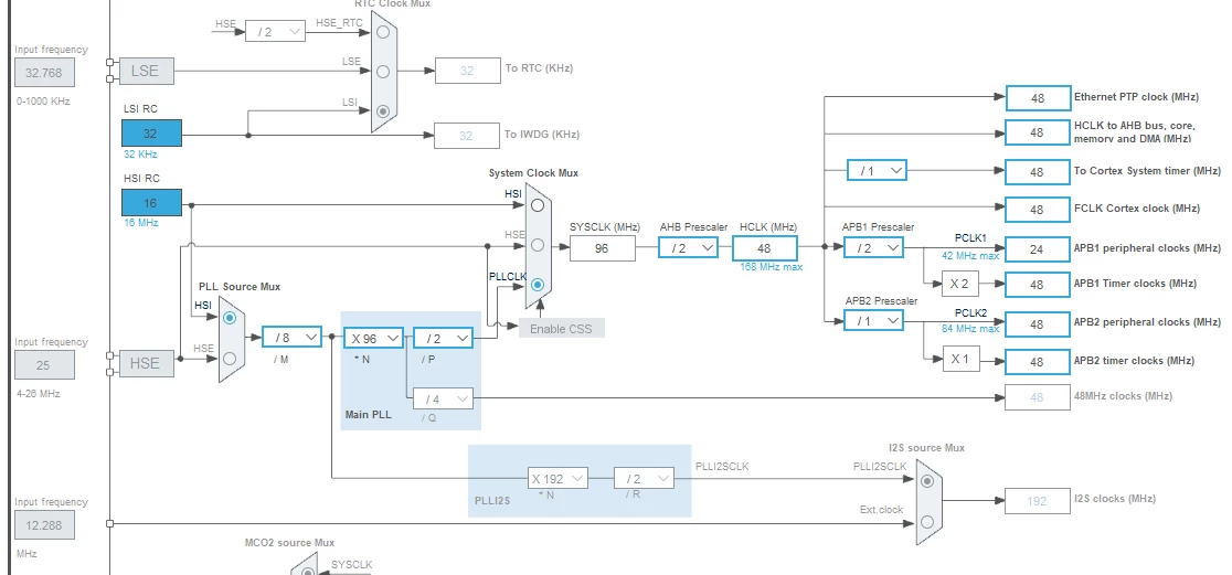

1.Clock configuration
I have decided to use TIM2. According to the STM32F407 Block diagram (STM32F407 Datasheet ) , this Timer connects to AHB/APB1 hence I have set the APB1 to 48MHz to achieve the required Clock frequency for the neopixels.

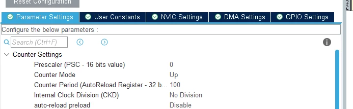

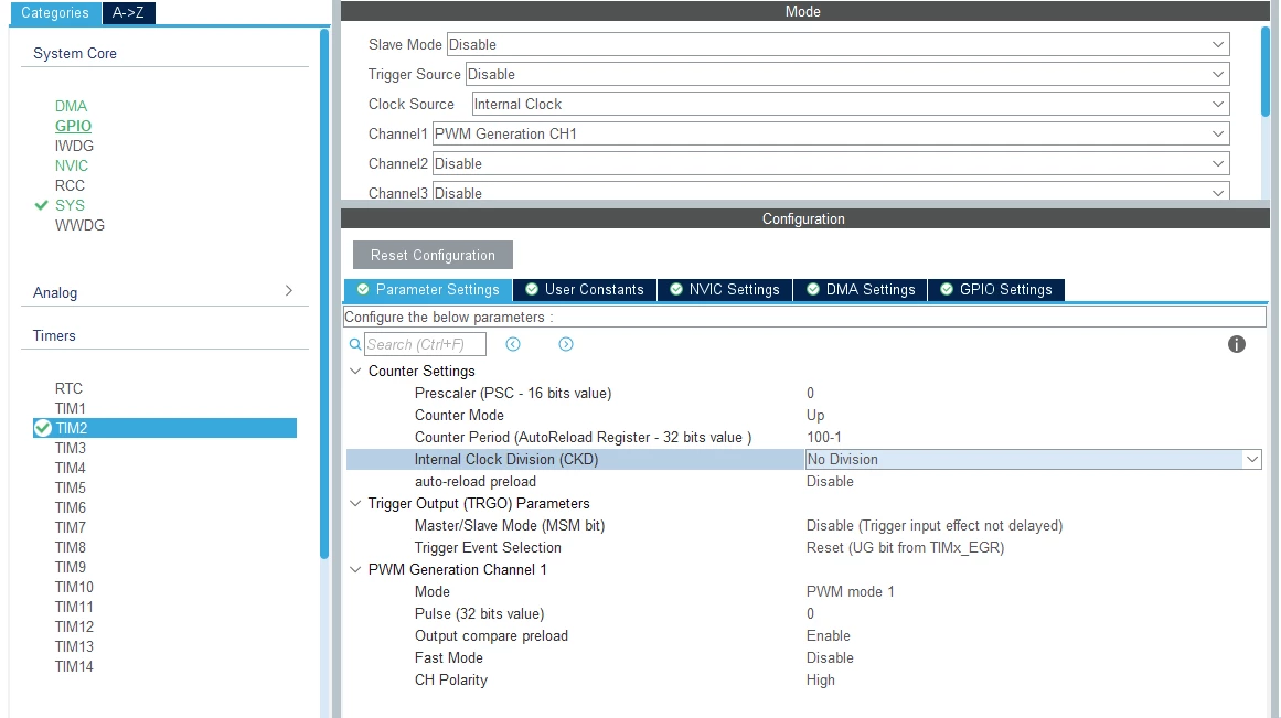

2. Timer configuration:

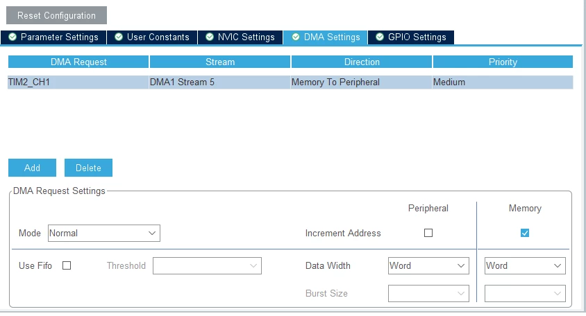

3. DMA configuration:

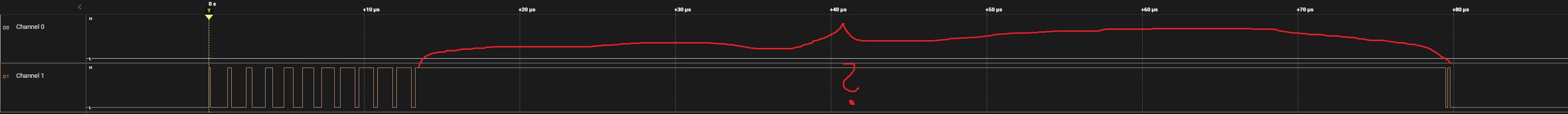

I have connected a logic analyzer to the data line and I have also placed a breakpoint before the following function:
HAL_TIM_PWM_Start_DMA(&htim2, TIM_CHANNEL_1, (uint32_t *)pwmData, 24);
to inspect the pwmData.
The pwmData is as following:
pwmData[0]	uint16_t	0x13
pwmData[1]	uint16_t	0x13
pwmData[2]	uint16_t	0x13

However, when I look at the data line through logic analyzer it looks as following:
which does not match the pwmData at all..

Other questions:
1. What is the correct Length to pass to the HAL_TIM_PWM_Start_DMA in my particular example?
Since I only want to send 24 bits ( 3 bytes ), I should call I pass 3 or 24 as length? In the example post that I initially refered the guy is using 24 but I am slightly confused.
2. What is the correct DMA data width. Currently, I have set to Word but I am not fully certain that this is correct.

  1. The correct length to pass to the HAL_TIM_PWM_Start_DMA function would be 24, since you are sending 24 bits of data.
  2. The correct DMA data width would be half-word (16 bits) since the data being sent is 16 bits (2 bytes) per LED.

  1. The correct DMA data width would be half-word (16 bits) since the data being sent is 16 bits (2 bytes) per LED.
How did you come up with that conclusion? For each Neopixel LED I need to send 3 bytes (not 2).

My DMA settings:
Mode: Normal
Direction: Memory To Peripheral
Data Width: Word
My timer settings (Clocked at 84MHz)
In my code, I simply try to generate 8 waveforms with increasing duty cycle:

The result:
As you can see from the waveforms above, it appears to be sending 11 pulses with increasing duty cycles, then it stays HIGH for a long time before finally going DOWN.
1. Why does it send more pulses than I want to? (I only want to send 8 pulses)
Data width in the above experiment was set to Word. Does it have to match the pwm_data data size? What if I create a variable instead of uint32_t pwm_data[8] -> uint16_t pwm_data[8];
In that case,  Word data width will no longer be correct or what?
March 4, 2024
After the "last" pulse, it will continue to send that pulse until something changes the value. I suspect your pulse complete callback, or similar, is eventually changing things. In this example, add another value such as 0 or 100  (depending on if you want it low or high) to the data set, disable callbacks, and try again.

If you want to send uint32_t values, the DMA has to be set to word width. If you want to send uint16_t, it should be half word.
waclawek.jan
March 4, 2024
It's not just matter of "you want". TIM2 is 32-bit, its registers are word-accessible. If you write 16-bit values to its registers (regardless of whether via DMA or processor, except that it would require extra work with casting if you'd do it by processor), the AHB/APB bridge doubles the halfword into both halves of the word, resulting in surprising behaviour.
Callback plus whatever Cube/HAL threw in.
[rant mode on] In the last month, I've seen here 3 similar attempts to throw Cube/HAL at the addressable LEDs, with the same results - lack of control. In one of the attempts the OP drew the clear conclusion that DMA in 'F1 is broken. Details matter, so accept that you have to learn and understand everything you didn't want to learn at the first place, and spend time and effort you've tried to avoid when started clicking in Cube. If you want to stick to Cube/HAL, accept, that it is now part of your program and it's your responsibility what's in there, even if you did not write it. Cube/HAL is a tool to satisfy "typical" requirements by clicking, and to sell chips to managers who want to hear "quickly and cheaply". This may work out, or not; in the latter case you're worse off than if you'd never started with Cubes, because they are psychologically almost impossible to unlearn. [rant mode off]
Add a zero length pulse at the end of your pulsetrain, that will solve the problem with extra pulses. Whatever comes after it, and whatever defect may be at the beginning of the pulse train, may need to be doctored through understanding of how the timer works and what's written in Cube.
