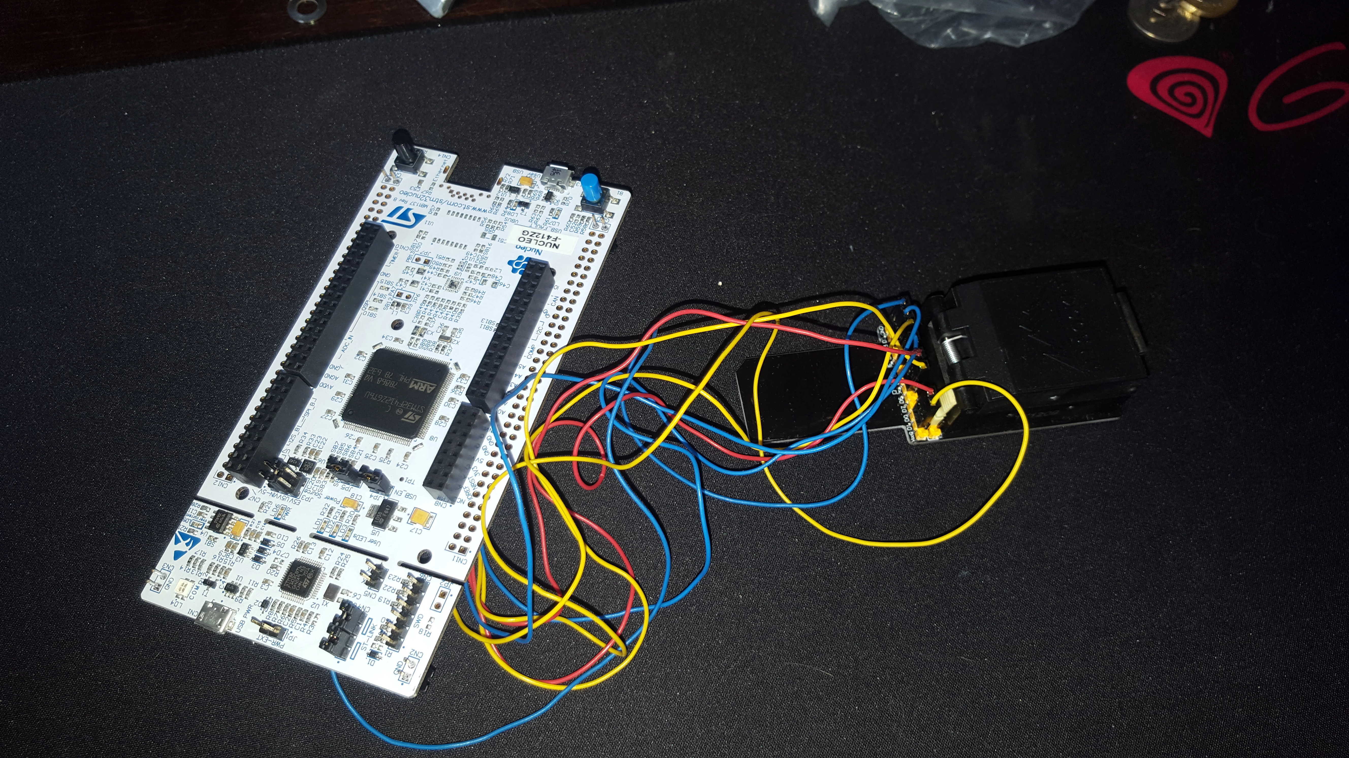

Hello there,
I am writing in regard to those 2 topics:
https://community.st.com/thread/49792-sm32l4-interface-with-an-emmc
I am using an STM32L452 chip and trying to fully utilize the SanDisk 8GB eMMC memory (
SDINBDG4-8G
). I have found out that the is no eMMC HAL written for the L4 family. Because of that, I tried STM32F412, as it uses SDIO not SDMMC peripheral (the same thing but other name?), and it has HAL written. I have found out however, that as pointed out here
it doesnt work. There are no examples of eMMC usage in STM32Cube_FW_F4_V1.0. From the code it also seems that it only supports memories up to 2 GB. Trying to use the code I was unable to write anything to the momory, like the mentioned topic, even though over a year passed since it was posted.
At the moment I have a serious design dilemma. I cannot afford the time to write the driver from scratch or try to fix the existing one. Could I please ask for an explanation what is the state of the eMMC driver for each STM32F4 and STM32L4 devices, do they indeed not work? Is there a way to make them work? Also, what is the real difference between SDIO which F4 utilize and SDMMC peripherals which L4 utilize? I would appreciate all help.

For my tests I have used
http://www.st.com/content/st_com/en/products/evaluation-tools/product-evaluation-tools/mcu-eval-tools/stm32-mcu-eval-tools/stm32-mcu-nucleo/nucleo-f412zg.html
  and
https://www.amazon.com/dp/B076HTDH2J
Like I described the initialization code seems to work. What does not is writing to the memory (returns errors) and reading I cannot tell, since I cannot write, but I assume it works. Also I am concerned about maximum of 2 GB capacity. Even thought you say that its just about instruction set, maybe the MMC 4.2 standard which STM32 uses is not compatible with higher capacities?
