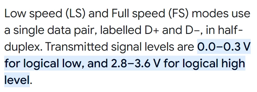

I'm not 100% sure, but I think that the differential USB data line is working with 3.3V, so there's no need to use more than the typical ESD protection.

LCE is right. USB signals are max 3.6V, so no protection is needed.

DP and DN are no problem because they are lower than 3.6V.
