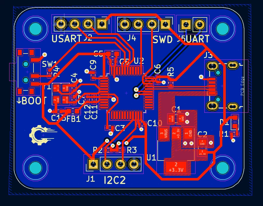

I found this schematic and layout with a stm32f103c8t6. I ordered it and wanted to programm it.

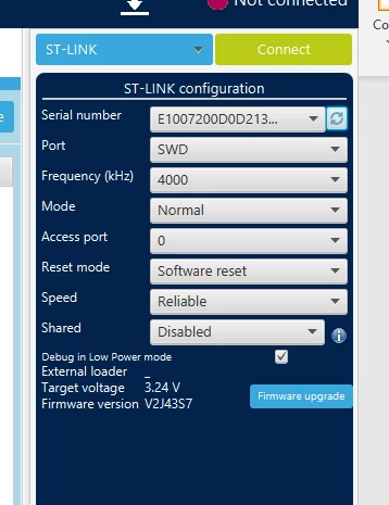

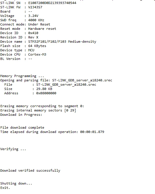

With stm32cubeprogrammer I detect the stm32 no problem via ST-LINK.
Same with stm32cubeide I can download successfully the code.

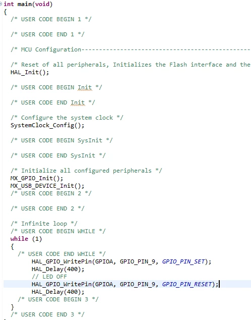

But now the problem is that eventhough the code is downloaded successfully the simple program to blink a pin to which I attach a diode is not working and I don’t see why.

If you see any problem in the design please tell me.

Which LED you want to flash?
I don't see any LED on PA9 that you are trying to control with your code?
JTAPIEAuthor
Jan 28, 2025 1:02 PM UTC
It is a LED connected to the pin A9 and to GND, i checked that the diode was working when connected to +3.3V to GND it is the case so the diode is not the problem.

/* USER CODE BEGIN Header */
 * @file : main.c
 * @brief : Main program body
 * @attention
 * Copyright (c) 2025 STMicroelectronics.
 * All rights reserved.
/* USER CODE END Header */
#include "main.h"
#include "usb_device.h"
/* USER CODE END Includes */
/* USER CODE BEGIN PTD */
/* USER CODE END PTD */
/* USER CODE BEGIN PD */
/* USER CODE END PD */
/* USER CODE BEGIN PM */
/* USER CODE END PM */
/* USER CODE BEGIN PV */
/* USER CODE END PV */
/* USER CODE BEGIN PFP */
/* USER CODE END PFP */
/* USER CODE BEGIN 0 */
/* USER CODE END 0 */
 * @brief The application entry point.
 * @retval int
int main(void)
 /* USER CODE BEGIN 1 */
 /* USER CODE END 1 */
 HAL_Init();
 /* USER CODE BEGIN Init */
 /* USER CODE END Init */
 SystemClock_Config();
 /* USER CODE BEGIN SysInit */
 /* USER CODE END SysInit */
 MX_GPIO_Init();
 MX_USB_DEVICE_Init();
 /* USER CODE BEGIN 2 */
 /* USER CODE END 2 */
 /* Infinite loop */
 /* USER CODE BEGIN WHILE */
 while (1)
 /* USER CODE END WHILE */
	 HAL_GPIO_WritePin(GPIOA, GPIO_PIN_9, GPIO_PIN_SET);
	 HAL_Delay(400);
	 // LED OFF
	 HAL_GPIO_WritePin(GPIOA, GPIO_PIN_9, GPIO_PIN_RESET);
	 HAL_Delay(400);
