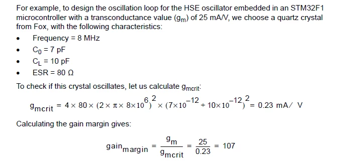

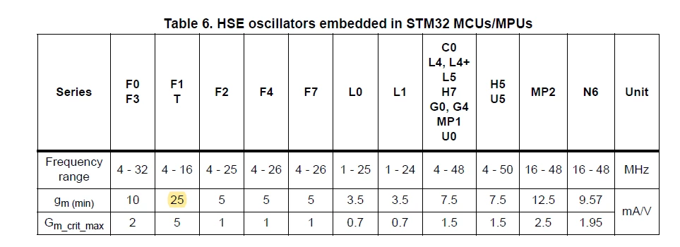

Let's do a calculation based on what AN2867 says.
The rule is to have gain margin > 5 (a condition that lets the oscillation to start).
Where:
gm is given by product in the table 6 in the application note:
gm crit formula is provided in the 3.4 Oscillator transconductance section:
In your case:
CL= 20 pF, C0 = 3 pF, ESR = 80Ω
-> gmcrit = 4 x 80 x ( 2 x pi x 8.10 6)² x (3.10-12 + 20.10-12)²  = 0,42 mA/V
An example of calculation has been provided in the same application note:
So in your case gain margin = 25 / 0,42 = 59 > 5
Normally it should work.
Hope that answers your question.
