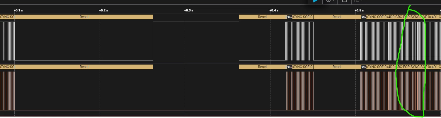

By the way, when I watch the MCU's communication with the Computer with the Logic analyzer, I see that it constantly gives this table Dec:
name type start_time duration value   (Numbers are seconds)
USB LS and FS v1frame -0.000000083 0.000000667 SYNC
USB LS and FS v1frame 0.000000583 0.000000667 PID SOF
USB LS and FS v1frame 0.00000125 0.000000917 Frame # 0x166
USB LS and FS v1frame 0.000002167 0.000000417 CRC OK 0x0D
USB LS and FS v1frame 0.000002583 0.00000025 EOP
USB LS and FS v1frame 0.000999917 0.000000667 SYNC
USB LS and FS v1frame 0.001000583 0.000000667 PID SOF
USB LS and FS v1frame 0.00100125 0.000000917 Frame # 0x167
USB LS and FS v1frame 0.001002167 0.000000417 CRC OK 0x12
USB LS and FS v1frame 0.001002583 0.00000025 EOP
But if I press the reset button, a different result comes out:
After NRSTAfter NRST
I think the MCU is trying a connection in the marked field;

Like that, I didn't quite understand the situation I was in, but these are the findings I was able to get, I want to overcome this situation because there aren't too many different options for changing the design of the MCU.
By the way the system gets its power from Vbus line and there is nothing on D+, D- lines, traces are short and of equal length. I also tried many different combinations but the result is always the same.
Thank you.
