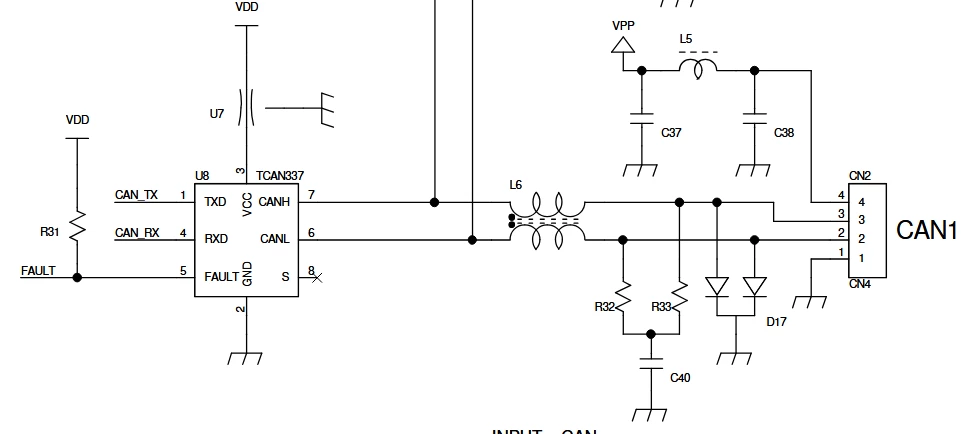

I have an issue with the CAN bus on STM32F042G6 µC.
For the moment I just want to receive Frames from an other controller (STM32G0B1) and it doesn't work at all.
I am using PA11 as Rx Pin and PA12 as Tx Pin Pins.

I don't understand why but it is impossible for me to go in the HAL_CAN_RxFifo0MsgPendingCallback function when a message is received. I checkes the RX Pin with an oscilloscope and the CAN frame is correct on this Pin.
I already found this topic https://community.st.com/t5/stm32-mcus-products/stm32f042g6ux-can-issue/td-p/675078 and follow what was said but nothing works. I don't have any filters, I enabled interrupts for CAN on NVIC menu and in CAN menu. My Rx pin is set to Pull-Up and both my µC have the same exact configuration.
I send a the configuration of my CAN, NVIC and GPIO in .ioc file on attached image.
Do you have any idea why it doesn't work ?

Hello, I'm using a STM32F042G6U6.
I'm also using STM32CubeIDE with STM32Cube MCU Package for STM32F0 : Version 1.11.5
My other µC used to send the frames is a STM32G0B1CBU6
In attachment, here's my hardware connection. CAN TX is directly connected to PA12 and CAN RX to PA11
