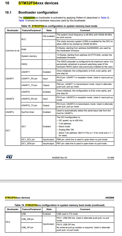

Having consulted AN2606, it lists the following ports as used by the bootloader in the STM32F04:
- PA11 (USB-)
- PA12 (USB+)
- PA9 (USART1 TX)
- PA10 (USART1 RX)
- PA14 (USART2 TX)
- PA15 (USART2 RX)
- PB7 (I2C1_SD)
- PB6 (I2C1_SCL)
However, the TSSOP20 package for the STM32F04 doesn't expose PB6, PB7 or PA15, and though it does expose PA10 and PA9 (for USART1), these pins are replaced by PA11 and PA12 when USB is enabled, so they're effectively unavailable too. I can confirm USB DFU works fine.
The chip does also offer USART2 on PA2/PA3 and I2C1 on PF0/PF1, but these are the ports I'm trying unsuccessfully. Does this mean that as per AN2606, these pins are not enabled by the bootloader for those functions? And as such, the only interface on the TSSOP20 package available for the ROM bootloader is the USB port?

Hello @DiamondPaws and welcome to the ST Community :smiling_face_with_smiling_eyes:.
The USART1, USART2,I2C1 and USB DFU are available for Bootloader only throw the Pins mentioned on the Table 19 of the AN2606:
You can't use the same interface for bootloader but with other Pins. So, if the pins mentioned on the Application note are not available on the package you are using, then you can't use this IP. In your Case, the Open Bootloader may be a good solution. take a look here for more details.
Best Regards.

Sep 6, 2024 7:52 AM UTC
Perfect, thank you for confirming! Yes, I'll now investigate if there's a drop-in solution or even just roll my own RAM-based update mechanism to work around this issue :)
