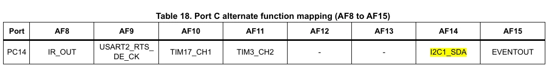

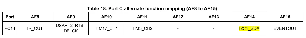

I'm trying to configure pin PC14 to be used as SDA signal as it stated in the datasheets STM32C031C6 and STM32C031G4:

 which is almost the same code that we can find here.
If I configure another pin to work as SDA (PB9 or PB7) the system works perfectly and I can communicate using the I2C protocol.
Is there any configuration that I am missing for that specific pin?
