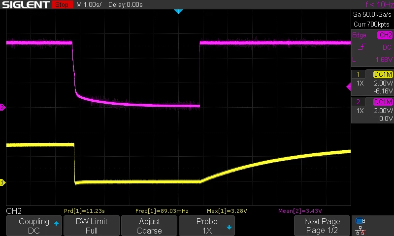

dodonnyBest answer
Jan 11, 2021 10:13 AM UTC
I put a 100uF capacitor between NRST and GND. Take 5 sc to charge. And boot fine with that !
(take care to the base time on the image below. Screen width take 14sc).
Same connection as previous. Top is VSS and bottom is NRST
0693W000006IAZLQA4.pngEDIT: Removed the 100uF capacitor (was only for testing) an removed the 100nF capacitor between NRST and GND and work fine now...
So i'll let it like that.
That was my 100nF capacitor (between NRST and GND) which is the faulty one. Was here to protect RESET button and debonce NRST signal. But seems too big.

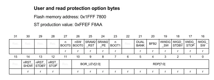

waclawek.jan
Jan 7, 2021 11:56 AM UTC
> (15) pc (/32): 0x1fff4956
That's in the bootloader.
Consult AN2606 and chapter Boot configuration in RM. They are slightly contradictory.
 BFB2 bit in the user option bytes is set how?

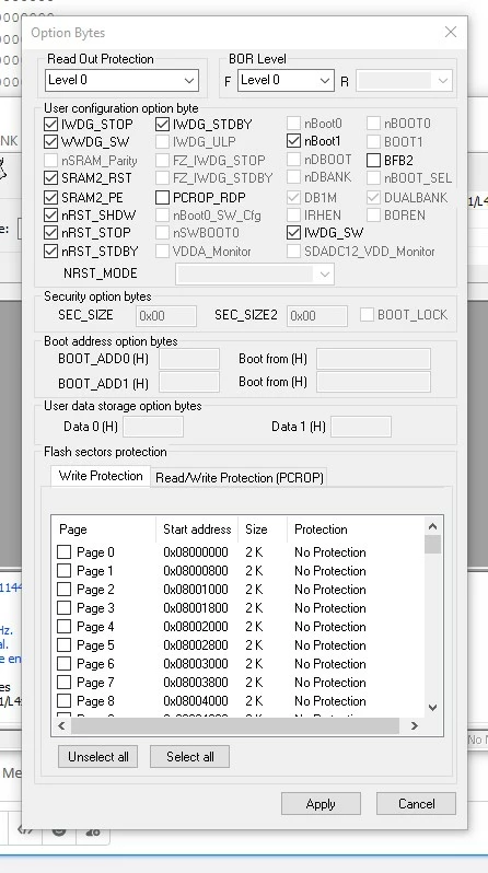

dodonny
dodonnyAuthor
Jan 7, 2021 12:23 PM UTC
0693W000006HpyFQAS.jpgThanks again !
BFB2 is LOW (see picture).
And double checked, BOOT0 is shorted to GND. Measured value : 0V from GND and -3.3V FROM VCC. (is not floating)
waclawek.jan
Jan 7, 2021 10:56 PM UTC
This IMO looks good.

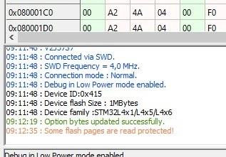

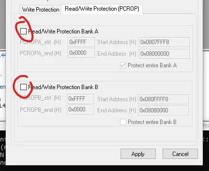

dodonny
dodonnyAuthor
Jan 8, 2021 8:20 AM UTC
And mutliples times I get the BANK A and BANK B locked (even, if i never wanted to, and never check that option). So I had to set PCROP_RDP bit to 1 and switch security level from 0 to 1 to zero again... as explained in error message.
