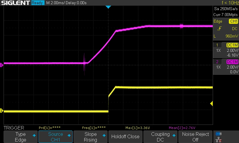

dodonny
dodonnyAuthor
Jan 11, 2021 9:13 AM UTC
Here is a typical power up voltage trace. On top (RED one) you have the VDD signal and the bottom the RST signal voltage. Still not booting.

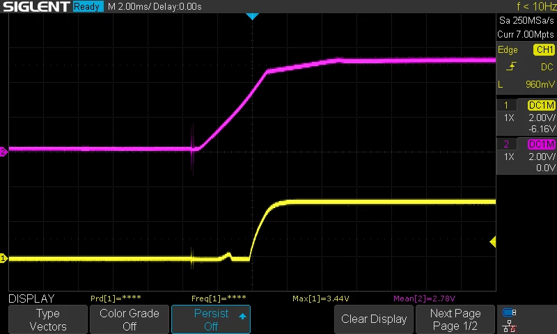

dodonny
dodonnyAuthorBest answer
Jan 11, 2021 10:13 AM UTC
I put a 100uF capacitor between NRST and GND. Take 5 sc to charge. And boot fine with that !
(take care to the base time on the image below. Screen width take 14sc).
Same connection as previous. Top is VSS and bottom is NRST
0693W000006IAZLQA4.pngEDIT: Removed the 100uF capacitor (was only for testing) an removed the 100nF capacitor between NRST and GND and work fine now...
So i'll let it like that.
That was my 100nF capacitor (between NRST and GND) which is the faulty one. Was here to protect RESET button and debonce NRST signal. But seems too big.
dodonny
dodonnyAuthor
Jan 11, 2021 10:25 AM UTC
Without my 100nF capacitor. This is the voltage trace of VDD and NRST
Not so far from the first one. But enough to prevent it to boot.
