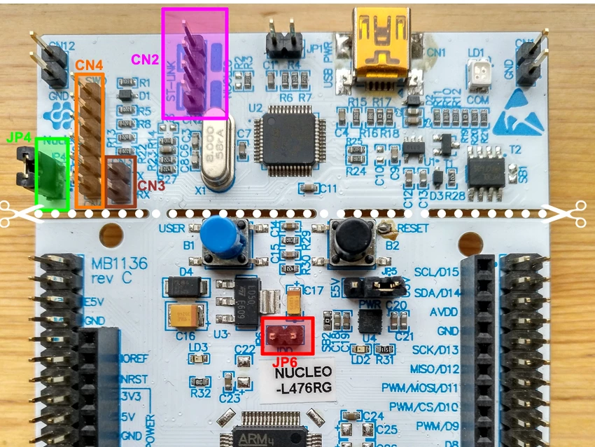

Apr 3, 2024 4:06 PM UTC
Any Nucleo 1. cut upper debuger and on your board only CN counterpart required.
MM1_0-1712160110595.pngBOOT0 isnt used with SWD, but  what other tools do I need to make the USB programming possible = CubeProgrammer sw
2.you ask MCU as minimum you need choice one with USB when USB com is your plan without debuger.
3. CubeIDE ...
