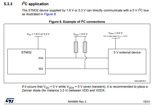

we use the STM32G474 with a single supply voltage of 3V3 at the VDD Pins.
At the moment we investigate defective microcontrollers. The Microcontrollers are defective after several hours with the 3V3 VDD voltage supplied. The defective is an increase current consumption and not working i2c-interfaces.
We connect two i2c-Interfaces with Pullups to 5V and at the moment we discuss if the 5V could be the rootcouse of the defective.
For i2c1 we use PB9 (FT_f) and PB8 (FT_f)
For i2c2 we use PA8 (FT_a) und PA9 (FT_fda)
The FT I/O structure should be 5V Tolerant.

For the I2C Interface we use the microcontrollers  Alternate Function Modules and it think the alternate function module configures the I/Os as Open-Drain Output or Input.
Am i right that it it is not allowed to interconnect with a 5V I2C-Interface because the I2C-SDA is partly configured as Output Mode ?

That App Note does show using a 5V I2C bus as an example of a 5V tolerant application - even with the STM32 running at 1.8V:

The point about the 5V tolerance not applying in output mode is when the output is actively driving high.
An open-drain output never actively drives high - so that shouldn't be an issue here.
This is discussed in the comments on that Knowledge Base article:
https://community.st.com/t5/stm32-mcus/what-is-the-maximum-input-voltage-that-can-be-applied-to-my/tac-p/49621/highlight/true#M284
Note the point there about power supply sequencing: you need to ensure that the STM32 is powered-up before you apply external voltage to the pins - whether 5V tolerant or not ...
Jan 21, 2025 2:13 PM UTC
Thanks for all replies.
We have identified a scenario when the STM32 is placed in our function-tester where VDD of the STM32 is 0V an the external Pullups of the i2c-interface are supplied with 5V. Maybe this is the rootcause of the damage.
I wonder the recommendation in the application-note "chapter 5.3.3" to pre-assign the VDD with a zener-voltag even for transient szenarios. The current flow of the 5V to the STM32 IOs is limited to only a few milliamps due to the pullups that are exepected to be in the kOhm range.
