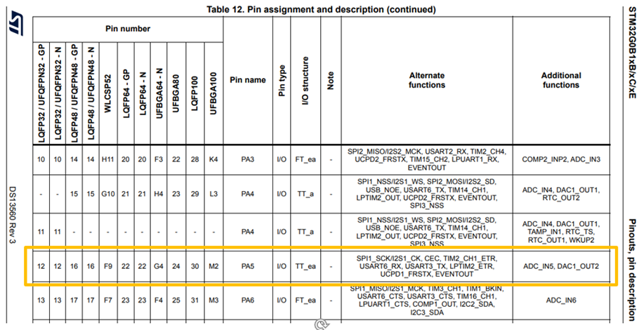

Using the table below, we can see that PA5 has I/O structure TT_ea:

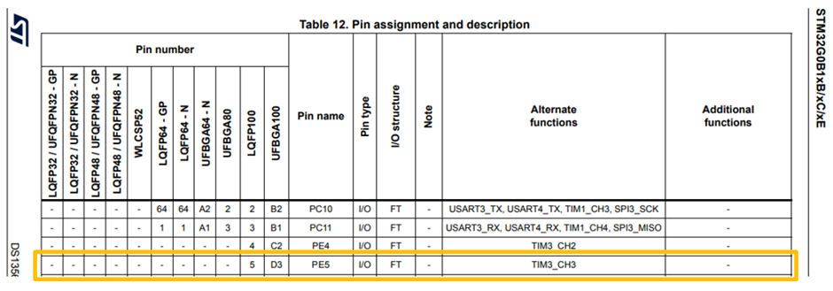

Using the table below, we can see that PE5 has the I/O structure FT:

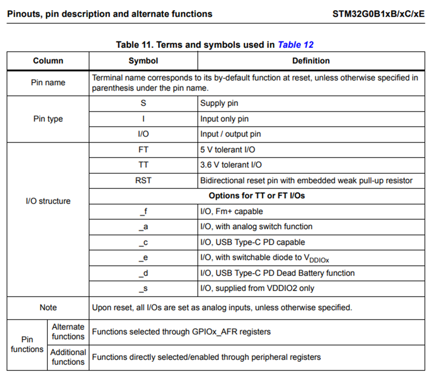

Step 2. Several GPIO structures are available across the range of STM32 devices, and each structure is associated with a list of options. You will want to locate the terms and symbols table or section within your device’s datasheet which summarizes the GPIO definitions and abbreviations applicable to STM32 products.
In the STM32G0B1’s datasheet, the legend to use to decipher the I/O’s structure in Table 11 as shown below:
Step 3. Using the determined I/O structure in step 1 along with I/O structure legend in step 2, decipher the GPIO’s voltage tolerance and if applicable, options.
PA5’s I/O structure is TT_ea. Referring to the table in step 2, we can determine that PA5 is a 3.6V tolerant I/O with both analog switch function and switchable diode to VDDIOx.
PE5’s I/O structure is FT. Referring to the table in step 2, we can determine that PE5 is simply a 5V tolerant I/O with no additional options.

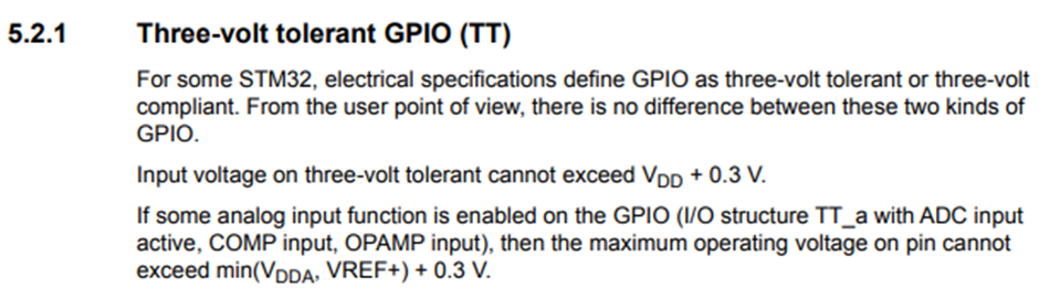

3V tolerant / compliant GPIOs (TT):
In general, the input voltage on 3V tolerant GPIOs cannot exceed VDD+0.3V. Furthermore, this holds true if the pin is used as a GPIO input or as some digital alternate function input (e.g. USART_RX).
However, if some analog input function is enabled on the GPIO (e.g. I/O’s structure is of TT_a with an ADC input active, COMP input, or an OPAMP input), the maximum voltage applied must be less than VDDA (respective of VREF+) + 0.3V. Otherwise, there will be injection into VDDA or VREF+.
The injection current is forbidden because the injection occurs inside the ADC through small parasitic diodes not capable of handling the current.
This voltage maximum information can be found in AN4899 within the 3V and 5V tolerant section:

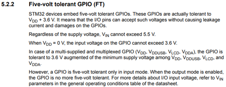

5V tolerant GPIOs (FT):
These GPIOs are tolerant to VDD + 3.6V, meaning that the I/O pins can accept such voltages without causing leakage current and damages on the GPIOs. Furthermore, this holds true if the pin is used as a GPIO input or as some digital alternate function input (e.g. USART_RX).
However, if some analog input function is enabled on the GPIO (e.g. I/O’s structure is of FT_a, FT_fa, FT_ea, etc. with an ADC input active, COMP input, or an OPAMP input), then the maximum voltage applied must be less than VDDA (respective of VREF+) + 0.3V. Otherwise, there will be injection into VDDA or VREF+. The injection current is forbidden because the injection is inside the ADC where small structures reside and injection current is limited (through small parasitic diode).

Very helpful article, however it doesn't help me understand what the voltage tolerance is for a FT pin that is configured as output (open drain). AN4899 instructs me to refer to the Vin parameters of the datasheet which still shows the same 5V tolerance.
Stefanie LAU
Hi Daniel,
Thanks for your feedback! Agreed on your point as we're currently working with our documentation team to bring up this issue. Hopefully we can add in some additional notes regarding voltage tolerance for a FT pin that is configured as output (open-drain).
To answer your question "what is the voltage tolerance for a FT pin that is configured as output (open-drain)", five-volt tolerant is only in input mode, and a FT_a pin cannot be permanently set to 5V DC in open drain output mode. In this case, the maximum acceptable voltage on an open drain output mode is 3.3V.

Thanks for the quick reply! So no margin at all? Not able to handle VDD+0.3?
Stefanie LAU
Hi Daniel,
You're welcome! From the initial question to our design team, it seems like 3.3V is the maximum acceptable voltage and there is no margin. However, I'm double-checking just to be sure on your ask and will let you know as soon as I hear back from them.

Thanks! I think it's worth noting that AN4899 actually shows an example of these pins being pulled to 5V for an I2C application (5.3.3) which I would think is using an Open-Drain configuration. It seems odd that it's okay for that application but not for mine
Stefanie LAU
Hi Daniel,
I got some more clarification from our design team on this point, please see below:
- When VDD = 0 (STM32 unsupplied), the maximum acceptable voltage on PB0 is min(VDD + 3.6, 5.5) = 3.6V (even in open-drain mode)
- When VDD = 3.3, the maximum acceptable voltage is then 5.5V
What's important to note is the 5V management:
  1. If VDD Is present before the 5V on your pin, then it should be OK
  2. If VDD is ramping up at the same time as the 5V, then there is no issue either
  3. However, if VDD is coming after the 5V then this could cause damage
Hope that helps clarify!
Best Regards,
ST MCU Support Team

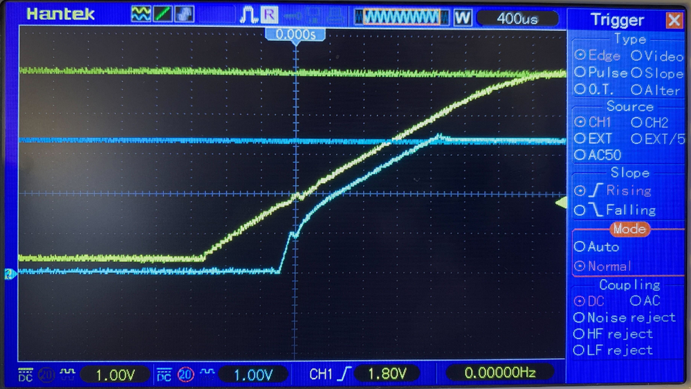

Konami
Senior II
Thanks, that's very helpful! It seems like our worst case is about 2V on the IO while VCC is still 0V. After that, the delta between VDD and IO is only less, and never exceeds the maximum 3.6V.

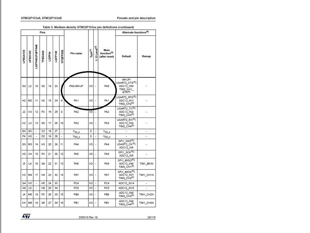

Hi, ST MCU Support Team,
In the Datasheet - STM32F103xB, March 2022, PA0 - PA7 are not under FT or TT, but with a "-".
Could you advise the meaning of this "-"? Does it mean "TT" or others?
Thanks.
Lan
On the STM32F103, "-" means not 5V tolerant. The datasheet has specifications for non 5V tolerant pins. No need to bring definitions from other datasheets onto the STM32F1 datasheet. Each stands on their own.
