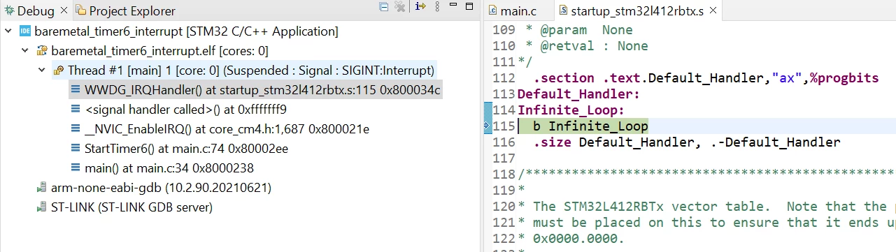

I am using STM32L412 microcontroller and doing baremetal programming for timer interrupt. I am using Timer 6 and base clock of 4MHZ is used as HCLK. However my interrupt is not firing below mentioning my code. count variable is also not updating
int main(void)
LedConfig();
StartTimer6();
  /* Loop forever */
while(1)
count=1;
void LedConfig(void)
/*Enable Clock for Port B. */
RCC->AHB2ENR |= (1U<<1);
/*Configure GPIOB_13 as general purpose output*/
GPIOB->MODER |= (1U<<26);
GPIOB->MODER &= ~(1U<<27);
void StartTimer6(void)
RCC->APB1ENR1 |= (1U<<4);
TIM6->PSC = 1000;
TIM6->ARR = 4000;
TIM6->EGR |= (1U<<0);
TIM6->DIER |= (1U<<0);
TIM6->CR1 |= (1U<<0);
NVIC_EnableIRQ(TIM6_IRQn);
void TIM6_IRQHandler(void)
if(TIM6->SR & (1U<<0))
GPIOB->ODR ^= (1U<<13);
TIM6->SR &= ~(1U<<0);

    When I tried with Timer 2 this code is working as expected, LED blinks at 1 second interval. Is the Timer 6 of STM32L412 has any additional configuration to made in order to work like this.
    This is what I get when I debug.
    KnarfB
    Feb 14, 2023 7:24 AM UTC

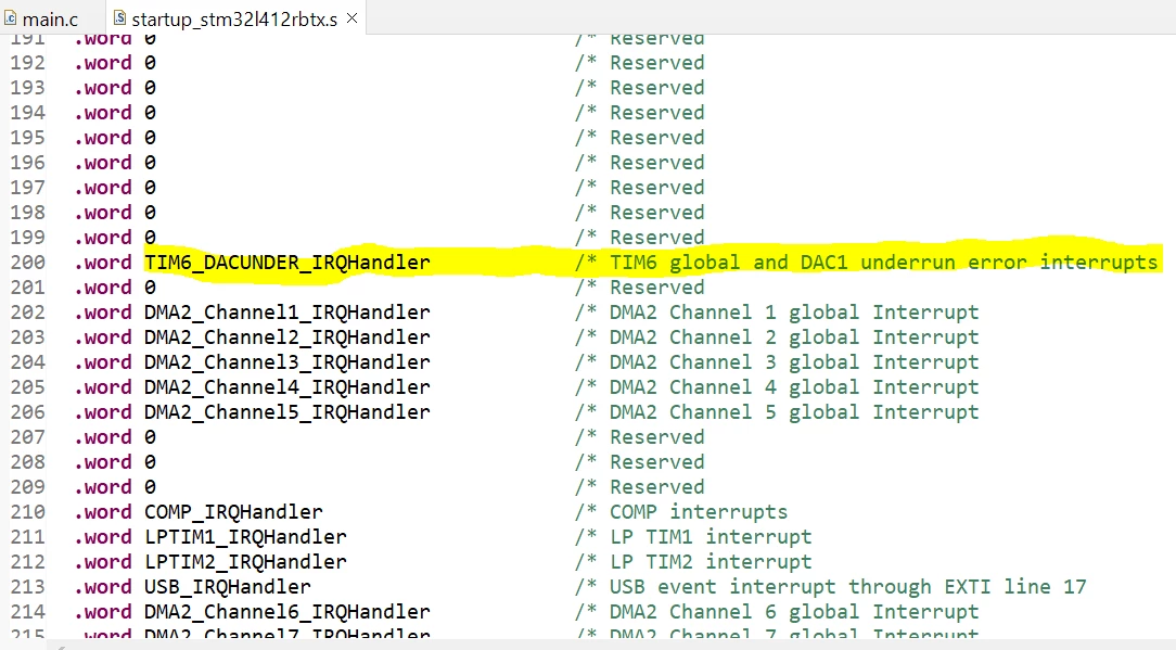

    This happens when the specific IRQ handler is not implemented. See the interrupt vector table in the startup code for the proper names. Guess: TIM6_DAC_IRQHandler?

    when I tried the debug mode startup_stm32l412rbtx.s was autoloading because of the error, it was in the debug folder under projectname.elf -[arm/le]. I got the Handler name from this file.

    Thanks @KnarfB as you said IRQ handler was different the actual one is TIM6_DACUNDER_IRQHandler. After I changed the handler name the code started working
    KnarfB
    Feb 14, 2023 10:48 AM UTC
    Glad it works. To add some confusion: stm32l412xx.h (ARM CMSIS) and others contains a line
    /* Aliases for __IRQHandler */
    #define TIM6_IRQHandler TIM6_DAC_IRQHandler
    which covers that error up. But you don't seem to use that.
