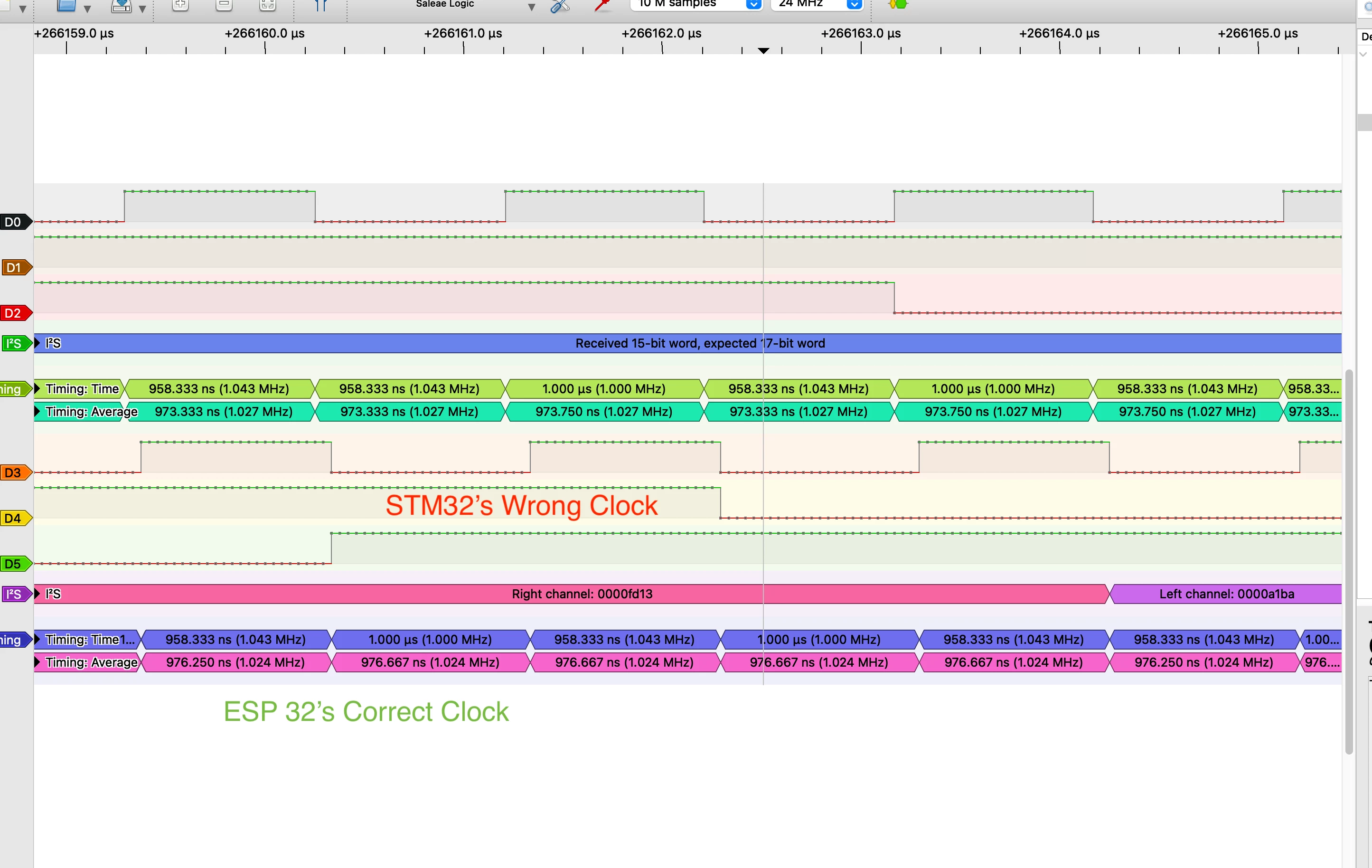

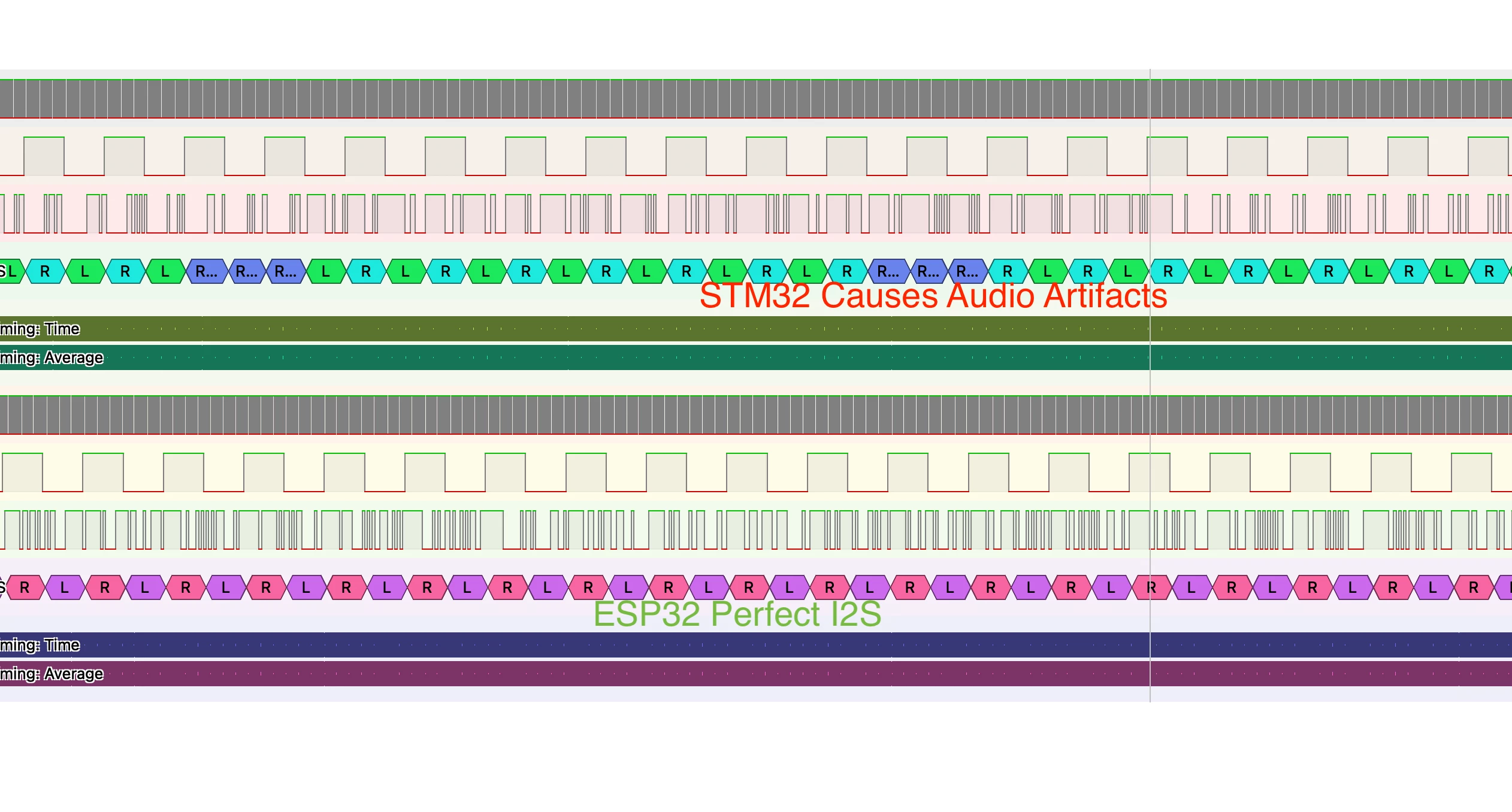

Opened up PulseView to check the clock between another connected device...
Much to my surprise, the STM32 is actually outputting 1.027 Mhz average clock pulses instead of the ESP32's 1.024 Mhz.

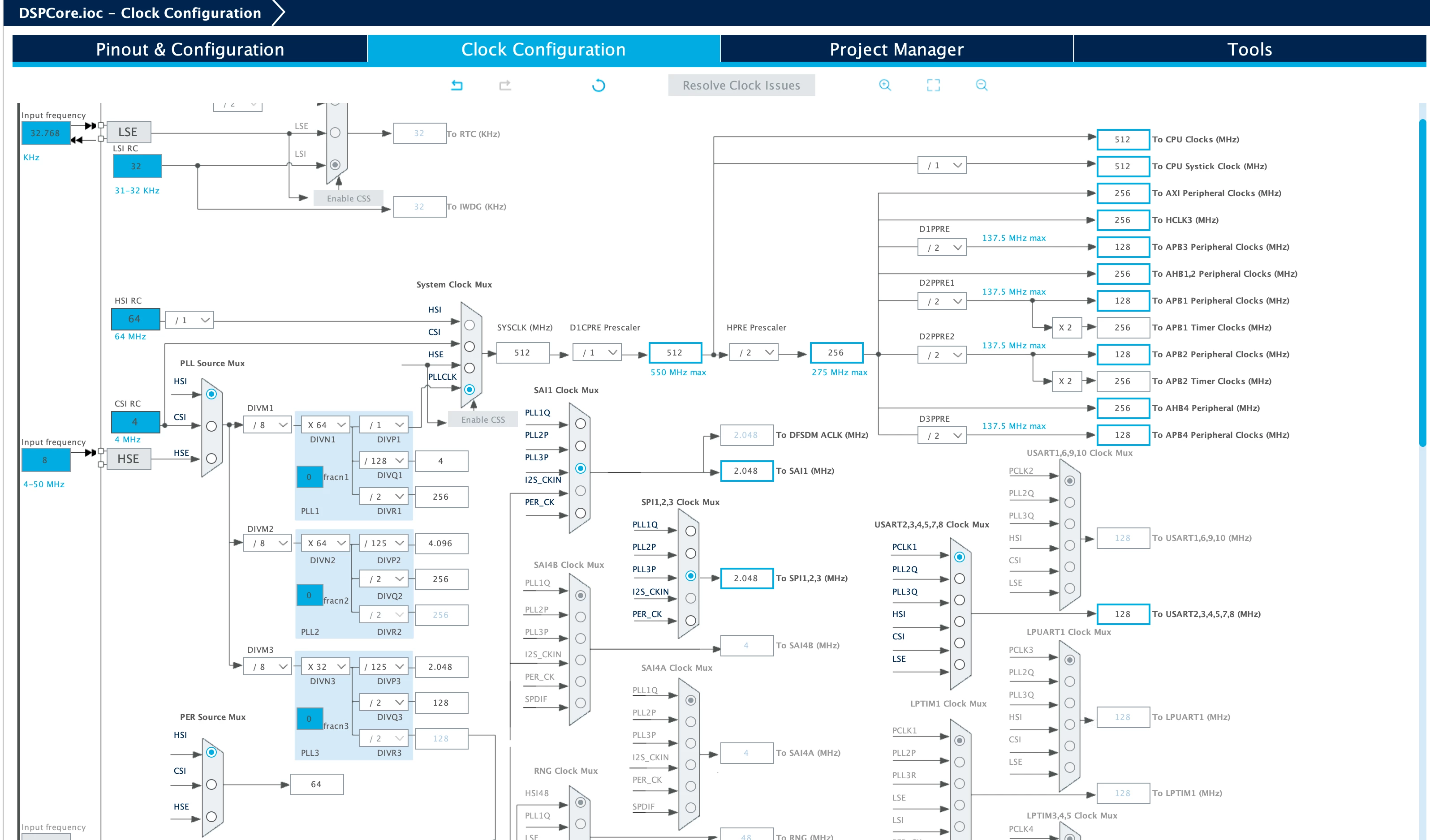

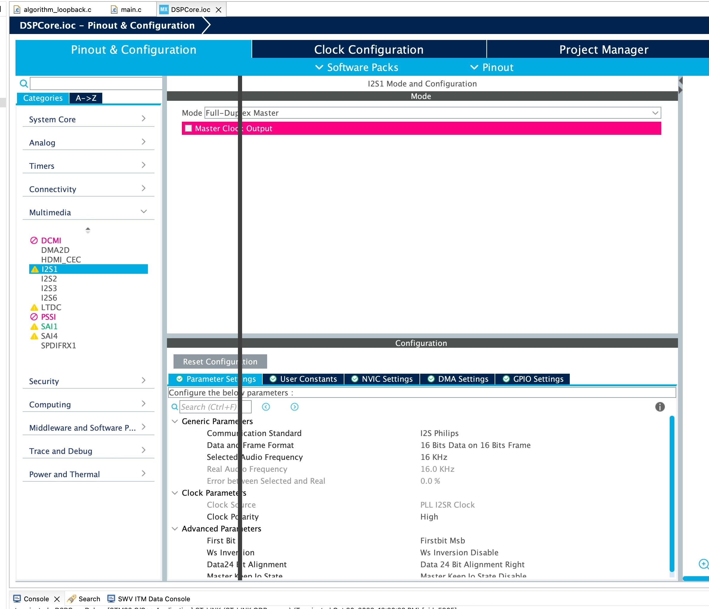

Checked the Clock in STM MX, shows 0% error and an input clock of 2.048 Mhz which is divisible. Tried also 20.48 Mhz with no change. There appears to be no divider settings. Any reason for this wrong output clock?

There are many "Expected 16 bit word, received 17 bit" etc, with varying bits because of the wrong clock. Expected is 16 bits.

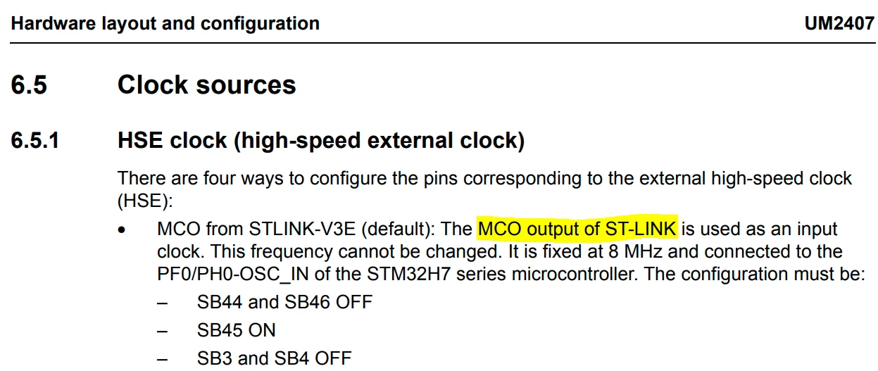

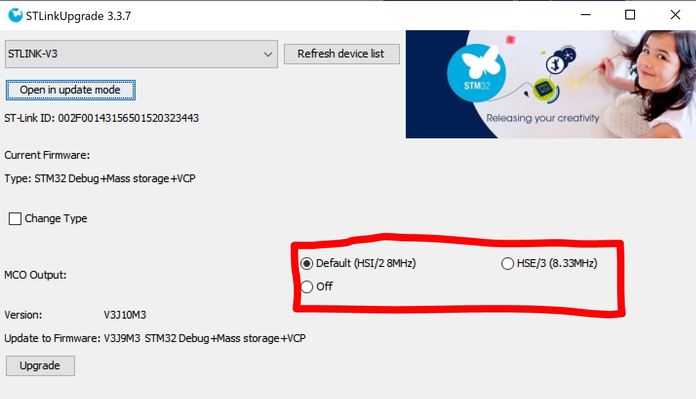

You're using the HSE bypass as clock, which is clocked from the HSI on the ST-Link chip. Yes, it's 8 MHz nominal, but not accurate to what a crystal would be. ±0.3% is well within the guaranteed accuracy range.
Despite what the user manual says, you can change this from the default HSI output to HSE output at 8.333MHz if you open the st-link in update mode and choose that option. You would then need to update your clock tree based on this new value.

What board are you using?
Be aware that the ST-LINK/V3 doesn't output a pure 8 MHz normally, typically around 8.333 MHz based on it's 25 MHz clock, and DIV3 on the MCO pin feeding the target MCU

Using the Nucleo H723ZG... According to the PDF I found here, the HSE looks to be 8Mhz.

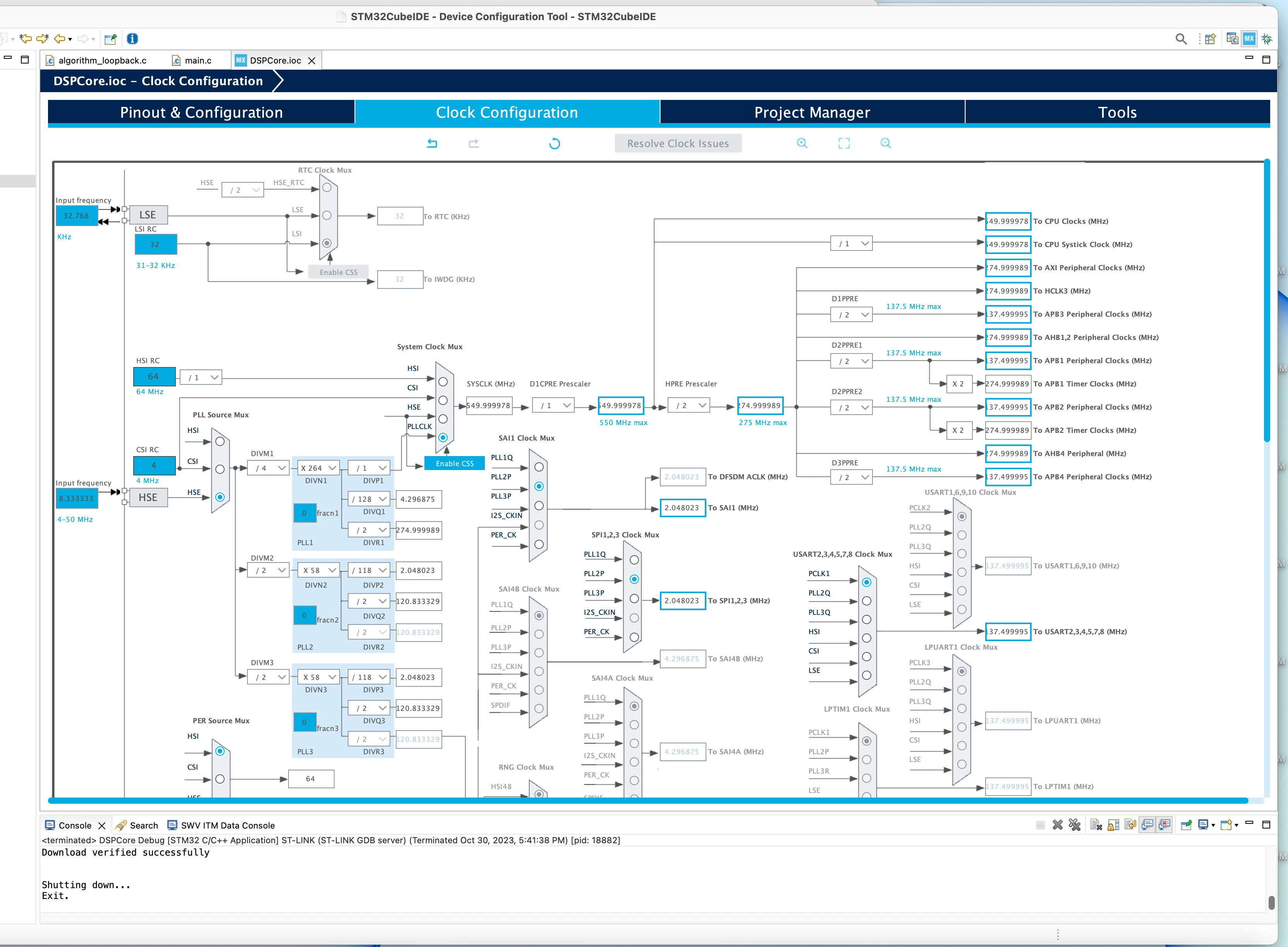

Here's the clock config with the HSI. It looks like its off even more now, at 1.029 Mhz pulses.

Also be aware that ±0.3% is well within the tolerance of the HSI. HSE will need to be used to be more accurate.
October 30, 2023
Okay, I'll try to change it to 8.33 the 8.33 option. Do you know the decimal places on this "8.33" or is it 8.33333333.
Edit: The only problem is there isn't a PLL combination I can come up with to output an accurate 2.048 signal now for the SAI bus (PDM mic) bus...
October 30, 2023
It's 25/3 MHz.

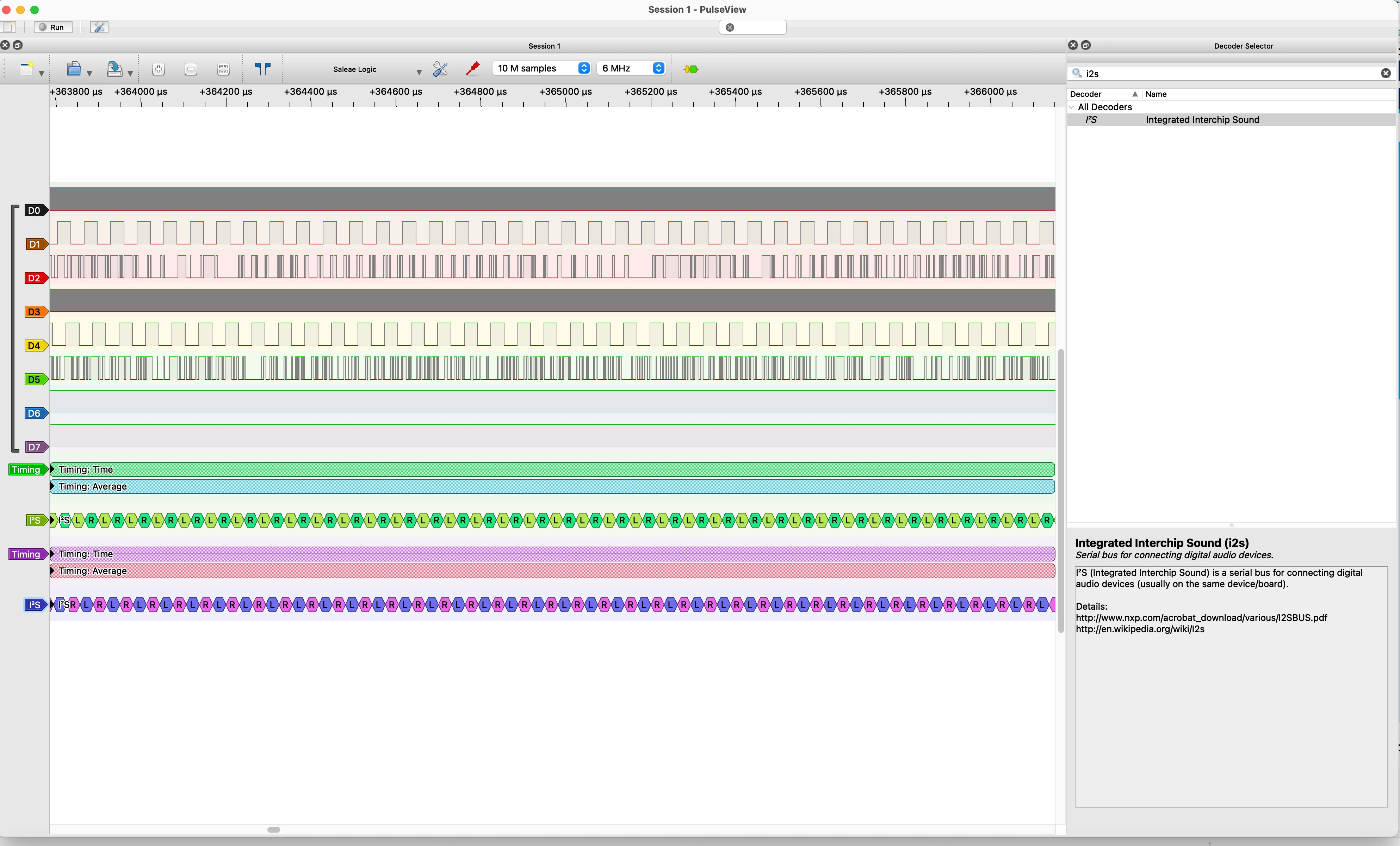

I2S, SPI and I2C have a clock signal, on which the data is sampled, and therefore those are synchronous interfaces. And for such interfaces a specific frequency doesn't matter. For I2S the SD is sampled on the rising SCK edge. That means the SD and WS must be changing at the falling SCK edge. In your second picture the ESP32 signal is correct, but for the STM32 signal either the SD or WS is changing on the rising SCK edge, which is wrong.
P.S. Full information about the STLINK-V3 provided MCO output:
https://community.st.com/t5/stm32-mcus-boards-and-hardware/how-to-change-the-stlink-v3e-mco-hse-frequency/td-p/218882

I don't like these 8.333 MHz... but these are much better than the HSI, which is unusable for audio >= 16 bit resolution.
BUT, there are the FRACN registers for each PLL for fine tuning, which get you close enough to the frequencies you need. (Even better, these can be modified on the fly.)

The targeted 16 kHz sample rate in the screenshots points to this solution not requiring a Hi-Fi audio. Anyway I would avoid using PLL in fractional mode unless actually necessary. I the latest screenshots the author has already found the best rational fraction for PLL, which deviates from the ideal frequency by +11 ppm. Humans can detect a pitch variation of 0,3 % (3000 ppm) at best. And that is for a variation, not a constant offset! In other words - there is absolutely no point in using a fractional PLL mode and increasing the jitter unnecessarily.
