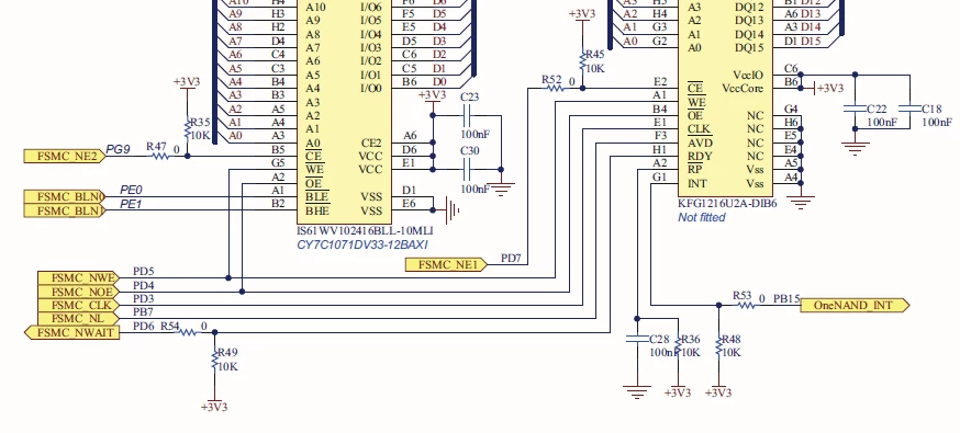

    Posted on March 27, 2014 at 03:21 I'm using STM32F107 and NAND flash from samsung K9F1GXXX.... I can't see R/B pin on the code....so I don't know where I'm going to connect this pin to STM32 chip I have...... Or I just Ignore it ? Thanks Please have a look to the code :

    Posted on March 27, 2014 at 12:08
    which one is R/B ?
    I don't have PG6, could it be PD6 ? what's PG6 for then ??
    I attached the schematic and Nand Flash chip datasheet, what do you reckon ? thanks

    FFS it's the WAIT pin, in this case a GPIO Input on PD6, providing a BUSY (B) or READY (R) signal. It's presumably a GPIO because the signal is not sufficiently compatible with the FSMC, or that's it's not appropriate to stall the CPU waiting for a slow memory device.
    The interrupt mode would only be appropriate if you have some stateful implementation

    am I defining the pin on code into the board correctly ? Please have a look on the code :
    /* CLE, ALE, D0->D3, NOE, NWE and NCE2 NAND pin configuration */
    GPIO_InitStructure.GPIO_Pin = GPIO_Pin_11 | GPIO_Pin_12 | GPIO_Pin_14 | GPIO_Pin_15 |
    GPIO_Pin_0 | GPIO_Pin_1 | GPIO_Pin_4 | GPIO_Pin_5 |
    GPIO_Pin_7;
    GPIO_InitStructure.GPIO_Speed = GPIO_Speed_50MHz;
    GPIO_InitStructure.GPIO_Mode = GPIO_Mode_AF_PP;
    GPIO_Init(GPIOD, &GPIO_InitStructure);
    CLE = PD11
    ALE = PD12
    D0 = PD14
    D1 = PD15
    D2 = PD0
    D3 = PD1
    NOE = PD4 = RE ? <==On NAND Flash board
    NWE = PD5 = WE ? <==On NAND Flash board
    NCE2= PD7 = CE ? <==On NAND Flash board
    /* D4->D7 NAND pin configuration */
    GPIO_InitStructure.GPIO_Pin = GPIO_Pin_7 | GPIO_Pin_8 | GPIO_Pin_9 | GPIO_Pin_10;
    GPIO_Init(GPIOE, &GPIO_InitStructure);
    /* NWAIT NAND pin configuration */
    GPIO_InitStructure.GPIO_Pin = GPIO_Pin_6;
    GPIO_InitStructure.GPIO_Mode = GPIO_Mode_IPU;
    D4 = PD7
    D5 = PD8
    D6 = PD9
    D7 = PD10
    NWAIT = PD6 = R_B ? <==On NAND Flash board
