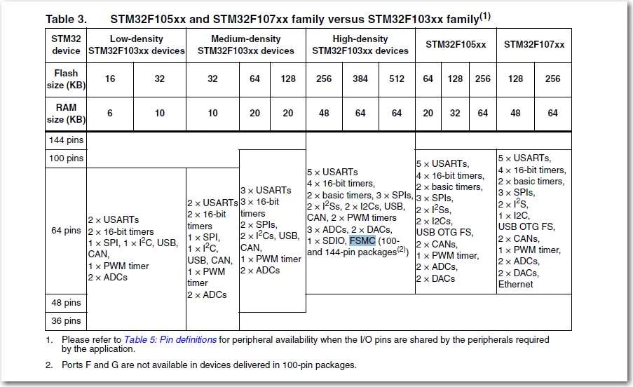

Guys,
Does R/B pin on Nand flash needed on the software ?
I can't find R/B pin on GPIO definition,
Anyone knows ?
thanks

    I'm using STM32F107 and NAND flash....
    Look I'm not familiar with your design, or the software surrounding it, it's not my project. Does the 107 Connectivity Line even support the FSMC external bus?
    If you enable the clock bit for the FSMC in the AHB clock register does the bit stay set, or does it remain clear?

    Posted on March 31, 2014 at 11:19
    I think this table from datasheet is giving me a clear answer, thanks for the clue clive...
    It's working already, thanks for helping,
    How can I use FatFS with NAND flash ?
    Nand Flash INIT BEGIN!
     Nand Flash INIT END!
     Nand Flash ID = EC,F1,00,95  Type = K9F1G08U0B
