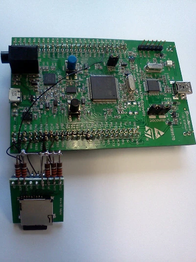

Hi everyone,
I am trying to send some bytes of data on a sd-card (8GB) using SPI.
I started with wiring the sd slot and configuring the spi but I have nothing, not even the clock...
I have followed what's explained in the file spi.h and seen other post about spi but I still don't see where I am wrong.
I'd really appreciate if you can help me with it ! Thank you.

Getting garbled data back from the card is indicative of a connection issue, or a clock that is too fast, you could reduce the speed, ie SDIO_TRANSFER_CLK_DIV
cagibomber
August 10, 2012
Posted on August 10, 2012 at 17:22
Ok, very useful ! I just forgot about the transfer speed.
I have a class 6 card, so I just configured my clock at 6MHz which I verified on oscilloscope.
Is it normal that my clock is not square but more of a sinusoid ?
For my wiring,
I use this socket >>
https://www.sparkfun.com/products/204
I plugged the 4 data lines(D0, IRQ, P9 and CS as D0, D1, D2 and D3 in SDIO), the CMD line (DI), VCC at 3.3v, COM and GND to the ground and CD on PC2 as Card Detection.
I don't think I need to plug WP so I left it unwired...
Thanks a lot !

Do you have the pull-up resistors?
cagibomber
August 10, 2012
Posted on August 10, 2012 at 18:33
Hardware you mean ?
If so, no I don't.
Should I put some for the data lines ?
Tesla DeLorean
Guru
August 10, 2012
Posted on August 10, 2012 at 19:42
Yeah, the ones I told you about 6 or so posts ago on this thread.
And several other threads around the SDIO/SD Card topic within the last couple of weeks.
[DEAD LINK /public/STe2ecommunities/mcu/Lists/STM32Discovery/Flat.aspx?RootFolder=/public/STe2ecommunities/mcu/Lists/STM32Discovery/STM32f4-Discovery SDIO problems&FolderCTID=0x01200200770978C69A1141439FE559EB459D75800084C20D8867EAD444A5987D47BE638E0F&currentviews=123]https://my.st.com/public/STe2ecommunities/mcu/Lists/STM32Discovery/Flat.aspx?RootFolder=%2Fpublic%2FSTe2ecommunities%2Fmcu%2FLists%2FSTM32Discovery%2FSTM32f4-Discovery%20SDIO%20problems&FolderCTID=0x01200200770978C69A1141439FE559EB459D75800084C20D8867EAD444A5987D47BE638E0F?tviews=123
Five pull-up on DATA and CMD lines, of the order 33K or 47K. Without them stuff fails.

Sorry about that, when you told me about the Pull Up resistor, I thought about the GPIO...
Thanks a lot, I'll try that tomorrow ! Your read me.txt is really helpful !
I thought the wiring couldn't be wrong since with my own code I manage to write in the Card and read it back with the stm32. I thought my problem was just FatFs !
Thanks again !!

I've put the pull-up resistors and checked my wiring again, still nothing. I've read the post you linked
If I just try to open/create a file in the sd card, it returns FR_OK, if I try to write in it, it returns FR_DISK_ERR (which is logic since no file has been actually created if I check the sd card on my laptop).
The clock frequency is 6MHz (for my class 6 SDC). The VDD is 3v...
I don't understand. Could it give FR_OK when creating file if it can't create it ?
Thank you.
cagibomber
August 16, 2012
Posted on August 17, 2012 at 00:37
I finally found something !
I had changed the ''1b'' of the bus width for ''4b'' in the error function instead of  init function...
Now the ''SD_Init()'' function returns ''SD_START_BIT_ERROR''.
I have followed the code and arrived at a function that returns this error if the SDIO_FLAG_STBITERR != RESET.
My SDIO CLK is stuck at 400kHz even if I don't divide it...
Any idea of where it comes from ?
Also, should I Enable the SDIO_ClockBypass ?
