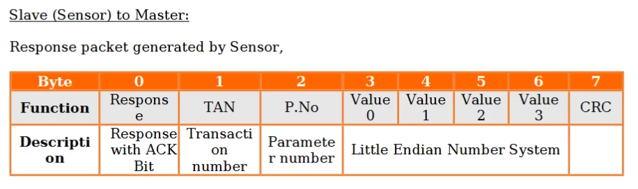

Communication Protocol
The protocol for the communication is as follows.

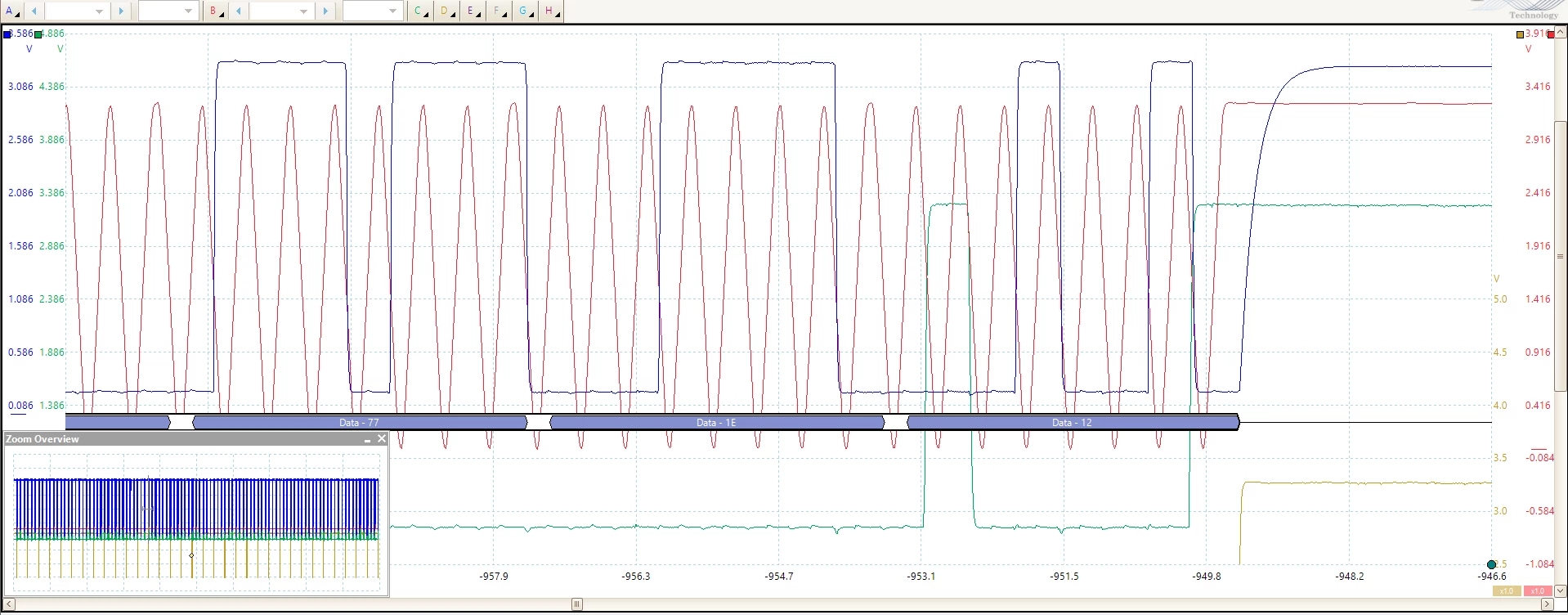

From the above picture (measured data from picoscope), the decoded SPI message from the MISO line is as follows,
0x34 0x6F 0x00 0x12 0x38 0x77 0x1E 0x12

If I observe the 7th byte -> 0x1E -> 0001 1110, 1-bit shift happened towards the left, as the expected value was 0F -> 0000 1111. This bit shift happens at the 8th byte (CRC) as well.
12 (invalid CRC) -> 0001 0010 (measured) -> 0000 1001 (expected) -> 09 (valid CRC).

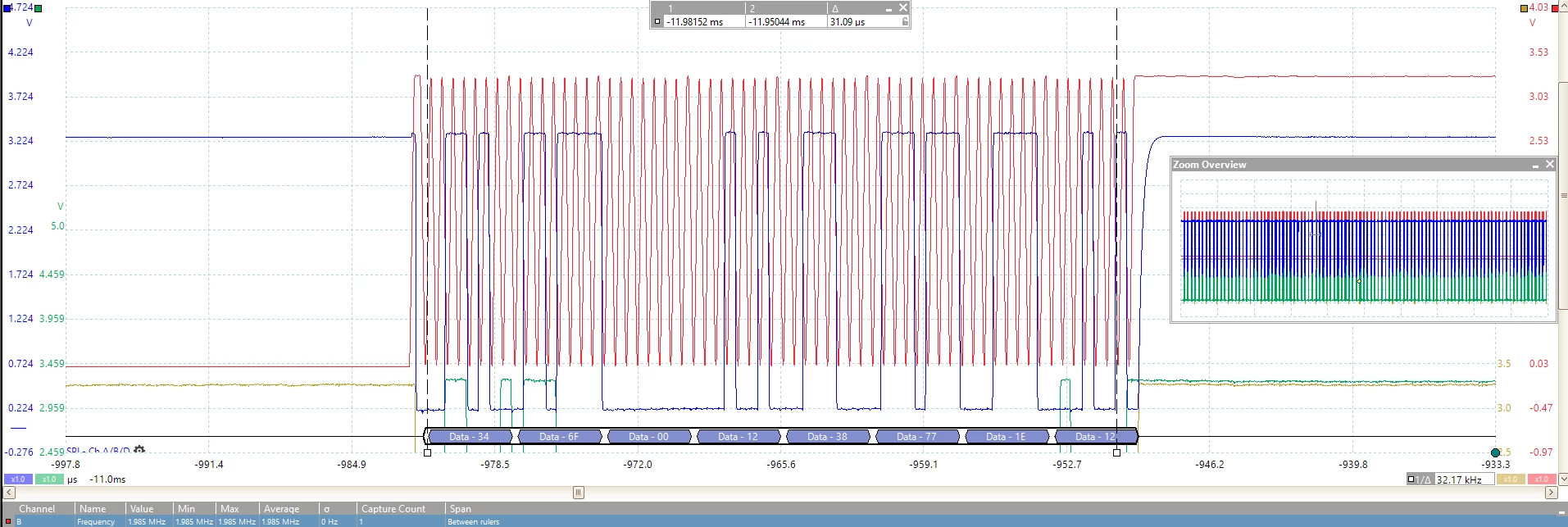

For example, take a look into the above highlighted transaction.

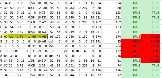

The decoded MISO message is 0x60 0xAC 0x01 0xF0 0x01 0x96 0x04 0xAE. The complete packet is shifted to the left by exactly 1-bit. If I shift the message by 1-bit to the right, I receive the following message -> 0x30 0x56 0x00 0xF8 0x00 0xCB 0x02 0x57. This is a valid transaction and the message holds true.

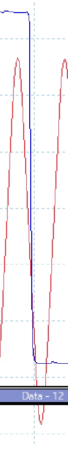

The bit shift is most likely caused by the 'STM32 "seing" an extra clock; that this happens "when current consumption is on a higher range" indicates suspected noise/common ground issues.
The depicted SCK slew rate is suspiciously slow.

I did almost the exact measurement you suggested. I used special shielded cables, which were directly soldered onto the SPI connectors, with GND shield connected to the microcontroller GND. The bandwidth of the oscilloscope I used is around 70 MHz (12-bit resolution).
BLUE -> MISO
RED -> CLK
GREEN -> MOSI
Even I suspected such a "glitch" on the CLK line might be the culprit, but I was unable to capture this on the scope. There, the CLK signals looked fine. Even if we consider that such a glitch occurs on the CLK line, it should affect not only MISO but also MOSI. Right?

SCK is generated by master, so it's output (MOSI) is probably derived from internal version of SCK and unaffected (in STM32 it's not this way and MOSI is generated from a feedback from the SCK pin, but that's IMO a deviation, I've never met this approach before).
The SCK is suspiciously slow. slower than MOSI. Is there any way to make it's slew rate higher, maybe a pin setting in a master? Is there any extra hardware on SCK?

For a signal at 2 MHz, the edges in your plot look awful. I wouldn't expect an RC filter with a cutoff at 340 MHz to have any affect on them.

In the above snip the falling data edge starts out later but arrives before the clock edge
One thing that may work is an RC filter on the data input to match the slew induced delay in the clock signal.

The error occurs only during a certain "high power consumption" mode (approx. 8 error messages out of 300) and the rest of the time, this error doesn't happen. Wouldn't the RC filter affect the normal operations as well?

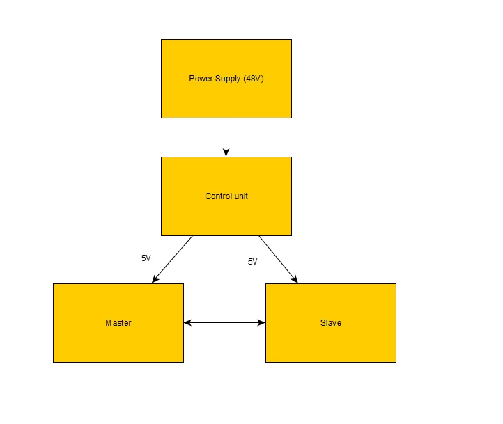

Can you shed more light on the mystery 35A load and how is the power adjusted and switched ?
Clearly the the load or its controller is creating some sort of pulse interference.
RE: control unit is consuming high amount of power
Is your control unit a high power (1600W) computing device or a motor drive ?
 Also in the above block diagram the slave should take 5V power and ground from the master
