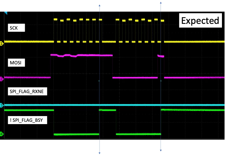

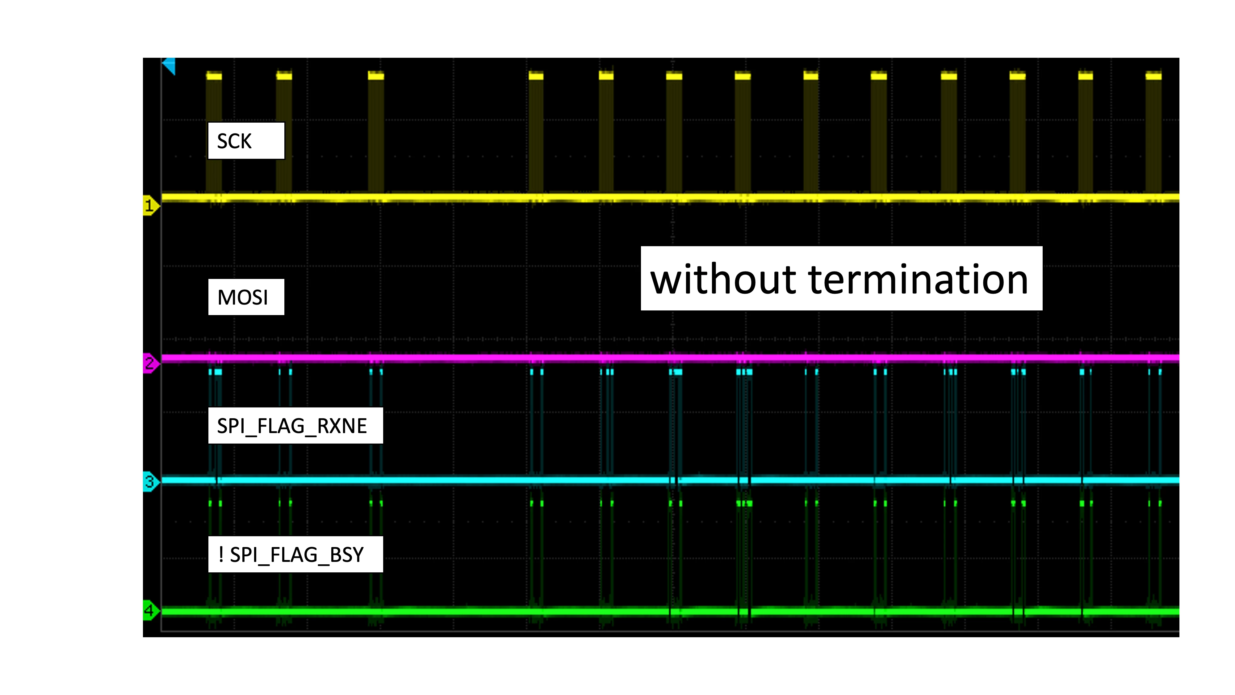

I have an jetson xavier driving STM32F407G-DISC1 on SPI1 default pins : PA4/5/6/7 .
The SPI_FLAG_RXNE flag behaviour is very strange, resulting in wrong values being received.
Config used:
/* SPI1 parameter configuration*/
hspi1.Instance =         SPI1;
hspi1.Init.Mode =        SPI_MODE_SLAVE;
hspi1.Init.Direction =   SPI_DIRECTION_2LINES;
hspi1.Init.DataSize =    SPI_DATASIZE_8BIT;
hspi1.Init.CLKPolarity = SPI_POLARITY_LOW;
hspi1.Init.CLKPhase =    SPI_PHASE_1EDGE;
hspi1.Init.NSS =         SPI_NSS_HARD_INPUT;
hspi1.Init.FirstBit =    SPI_FIRSTBIT_MSB;
hspi1.Init.TIMode =      SPI_TIMODE_DISABLE;
In these plots CH3 is connected to a gpio that tracks SPI_FLAG_RXNE, while CH4 is connected to !SPI_FLAG_BSY .
What I expect to see is SPI_FLAG_RXNE firing with the rising edge of SCK on the reception of the 8th bit like this:

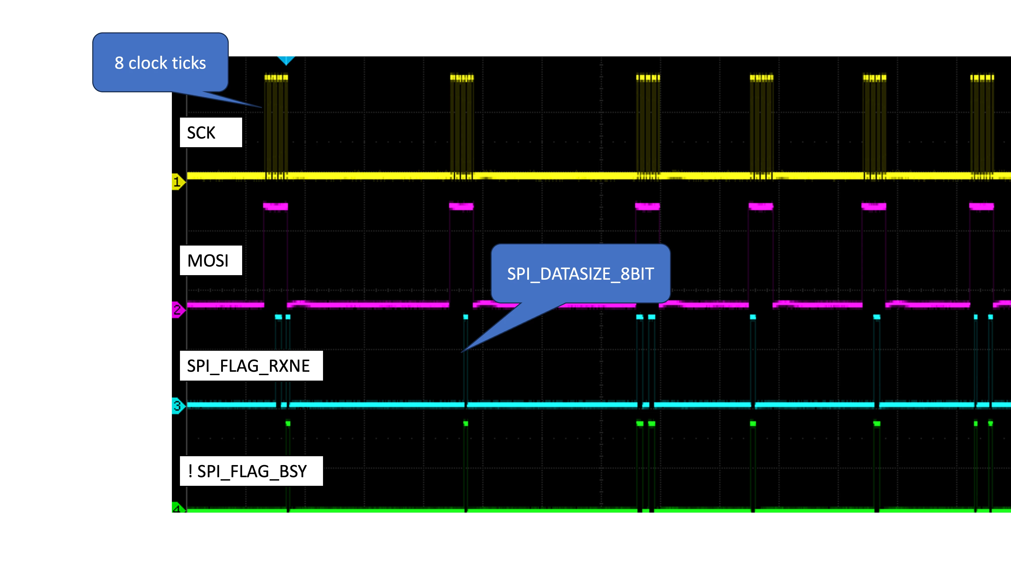

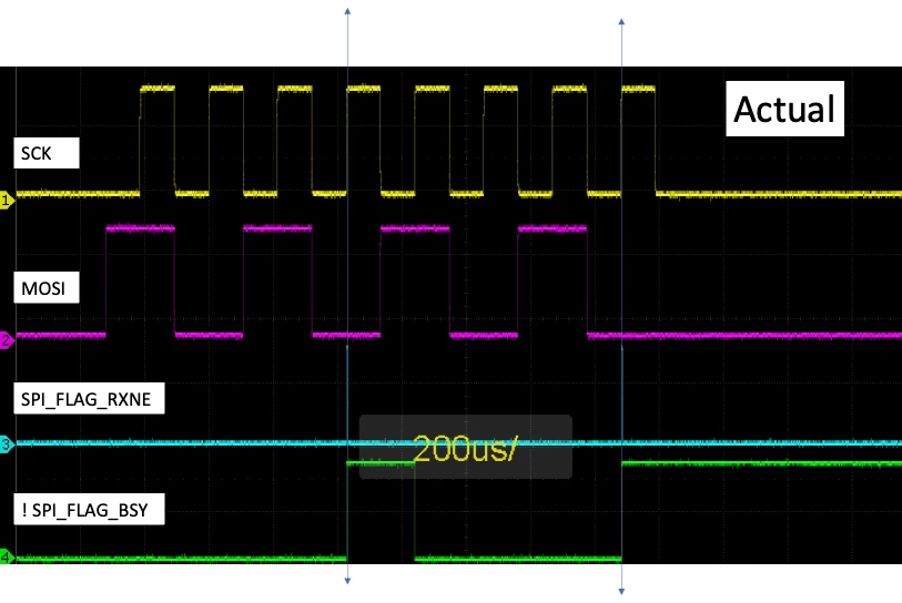

 However with this SPI driver the SPI_FLAG_RXNE signal seems to look like this:
Result is wrong data received.  This happens independent of SCK speed.  Validated the STM32 slave inputs using a simple bitbang SPI slave, and data is received with no errors.

Looks like the master and slave are out of sync. The CS pin is typically used to ensure byte-alignment between the interfaces. It doesn't look like you're using a CS pin.
While the above may also be relevant, looks like it's accepting a byte after 4 bits, and not 8. I wonder if there's some bouncing on the SCK line that would be causing duplicate bits. That would be quite odd, but I don't see what else it could be. Maybe try using slower GPIO speeds.
How far away are master and slave? Are they connected with long jumper wires?
The SPI on the F4 doesn't support 4 bit words, so it can't be that.
deep
deepAuthor
October 25, 2023
Both SPI_NSS_SOFT and SPI_NSS_HARD_INPUT give similar results.
Reducing SCK speed down to 256Hz (!) also gives very similar results..
Master<->Slave is connected with a short ribbon cable which has few errors up to 1MHz spi communication using bitbang version of SPI on stm32 side.

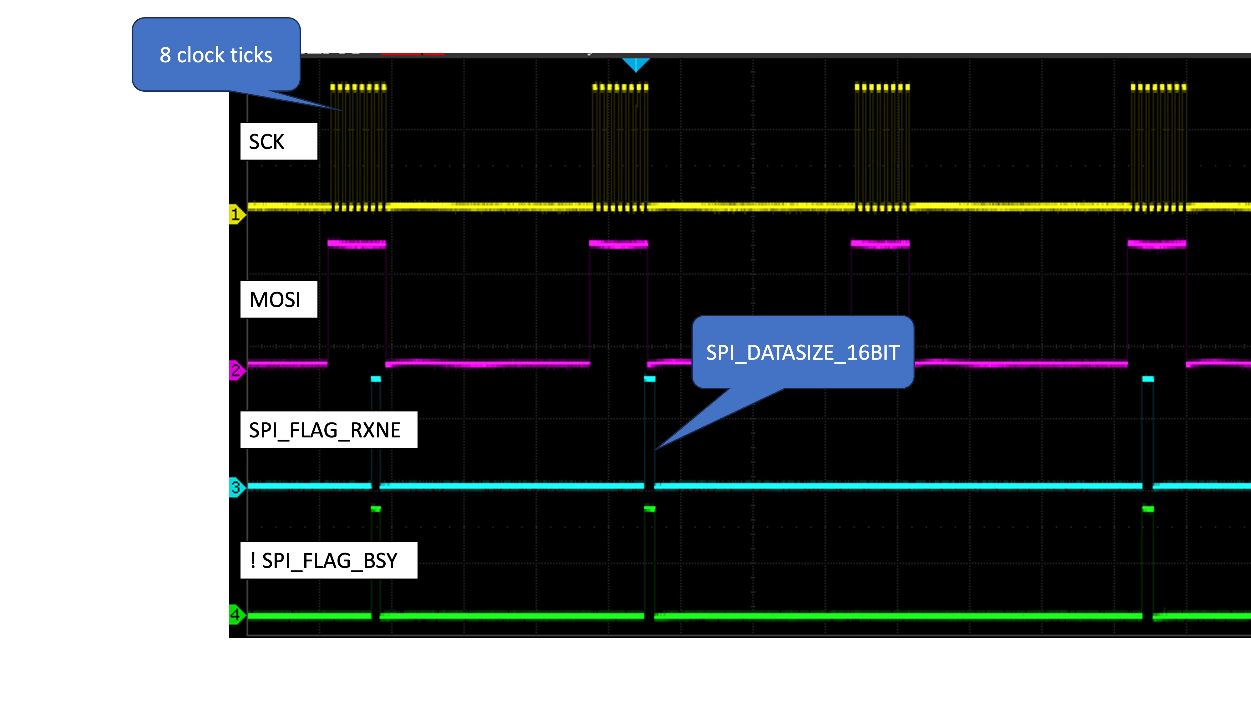

Increasing word size does have an impact, but the clock counter on slave still seems to be off...
October 25, 2023
I meant to suggest slower GPIO speeds, not SPI speeds. When you initialize the pins used for SPI in HAL_SPI_MspInit (or wherever if not using HAL), you give them a frequency. It's probably set to GPIO_SPEED_FREQ_VERY_HIGH which is default. Set it to GPIO_SPEED_FREQ_LOW instead which will still support up to ~2 MHz clocks. Doing this lowers the drive strength of the pin, which slows the edge down, which will be less prone to causing the line to bounce. A terminating resistor on the slave side would also help.
Edit: Oh, the STM32 is a slave so this isn't relevant. Well, maybe you can do something similar on the master side.
waclawek.jan
October 25, 2023
I believe TDK is right and this is consequence of SCK bounce; maybe inadequate ground/return.

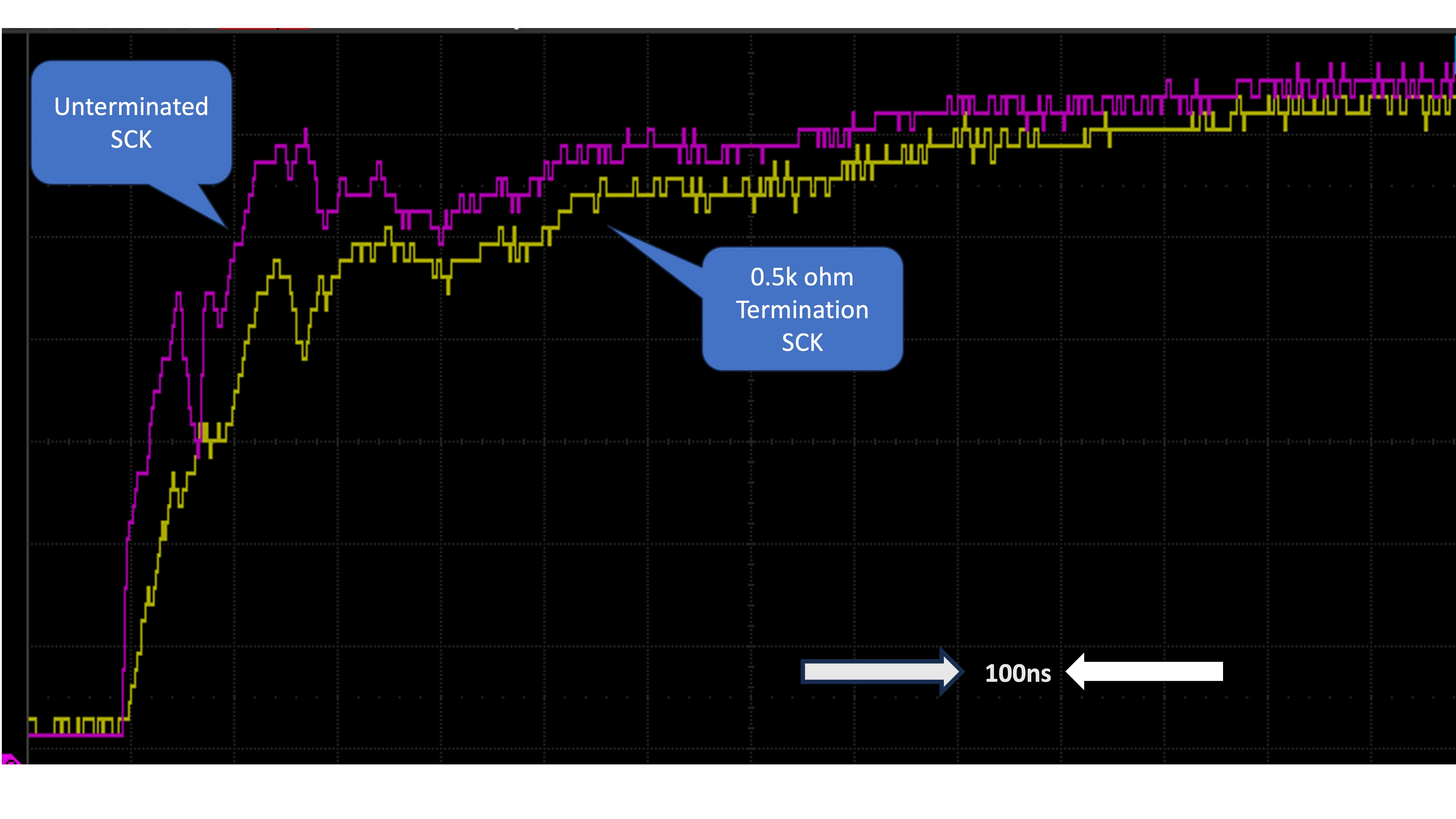

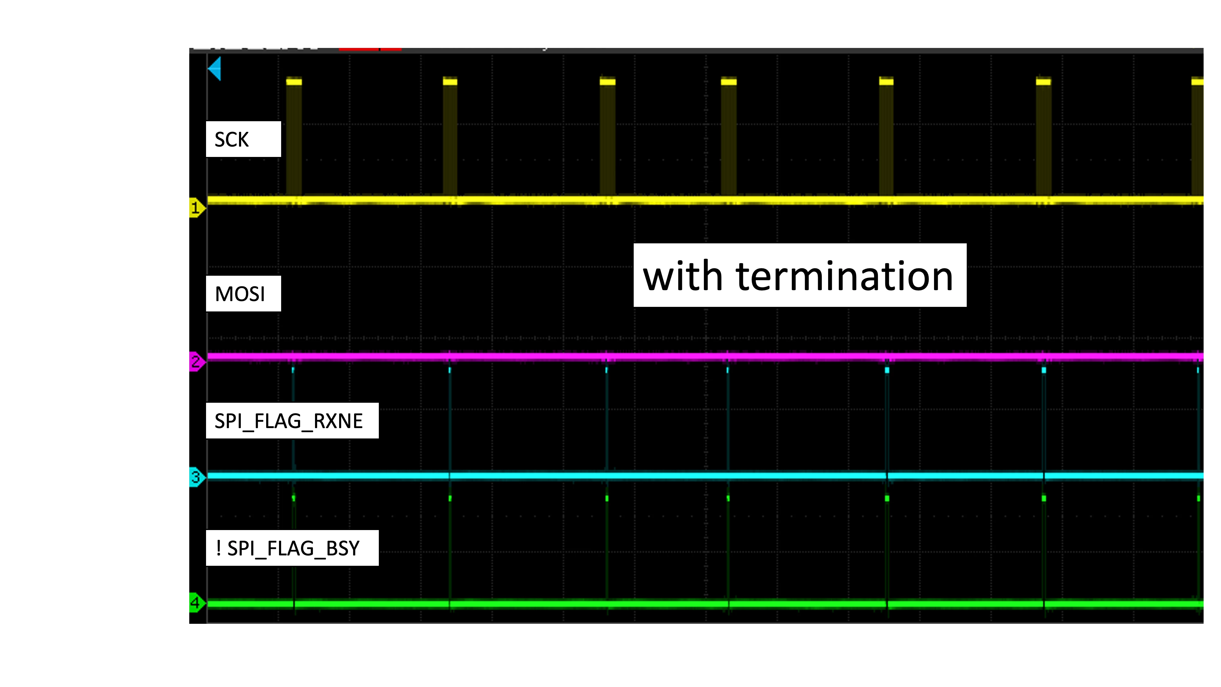

Terminating the SCK on slave stm side seems to help a LOT:
after adding a terminating resistor on sink of SCK:
much better--thanks TDK and waclawek.jan .
However the performance is still pretty poor--starts having errors around 200kHz .  The Slave SPI receiver must use analog logic to process SCK for this termination to make such a difference. Perhaps the termination scheme needs to be further optimized--over the exact same cable and setup the following bitbang version of SPI slave gets to around 1.2MHz :

October 27, 2023
with and without termination signals look like this on slow clocks:
around 200KHz there are single bit flip errors in about 10% of the data: if hardware slave select is enabled in receiver then the bit flip errors are the last bit.  otherwise they're the first bit.  at around 250KHz and above errors are equally distributed across bits. grounds are shared and no microwave, however a powerful subwoofer under the unit :)
The previous errors looked like bit shifts, and that's definitively caused by the spike in the edge, usually due to reflections. You should've experimented with OSPEEDR settings before adding the serial resistors.
Bit flips, however, are something else.

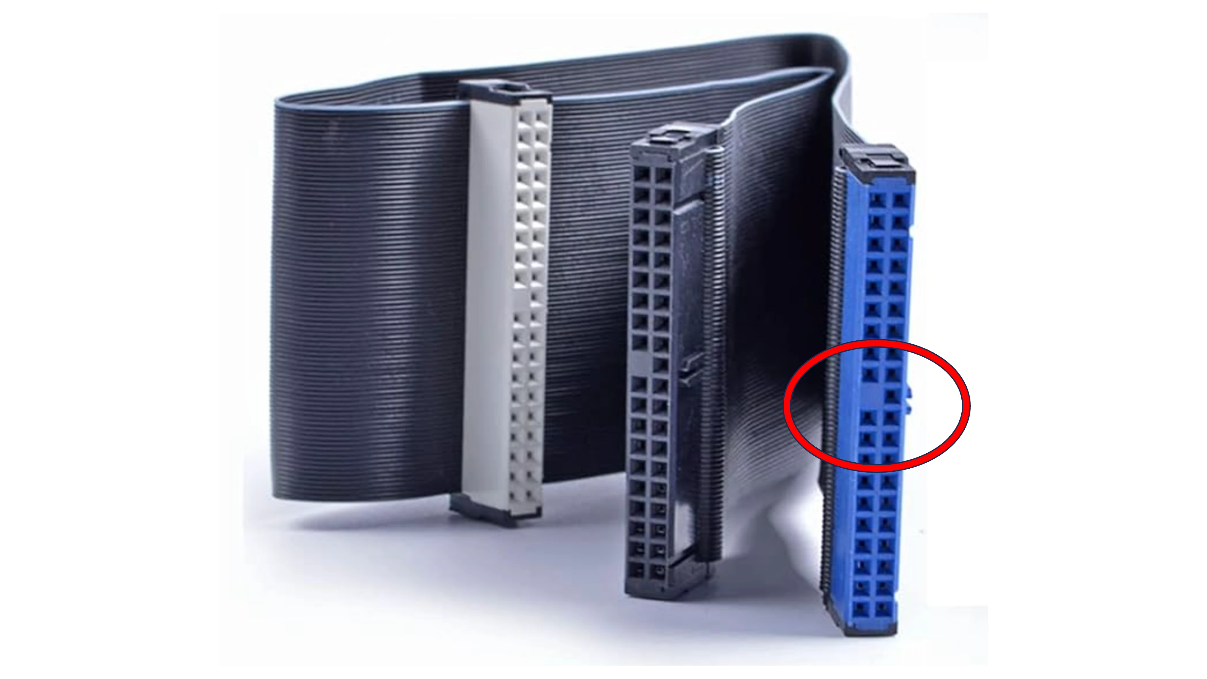

Ground/return should be every other line in the ribbon cable, and every signal should have its own return. Remeber the 80-wire "high speed" PATA cable?

Couldn't use the 80-wire "high speed" 40-pin cable unfortunately, because I found it has a missing connection:
I guess that's how they key it in. too bad :(
