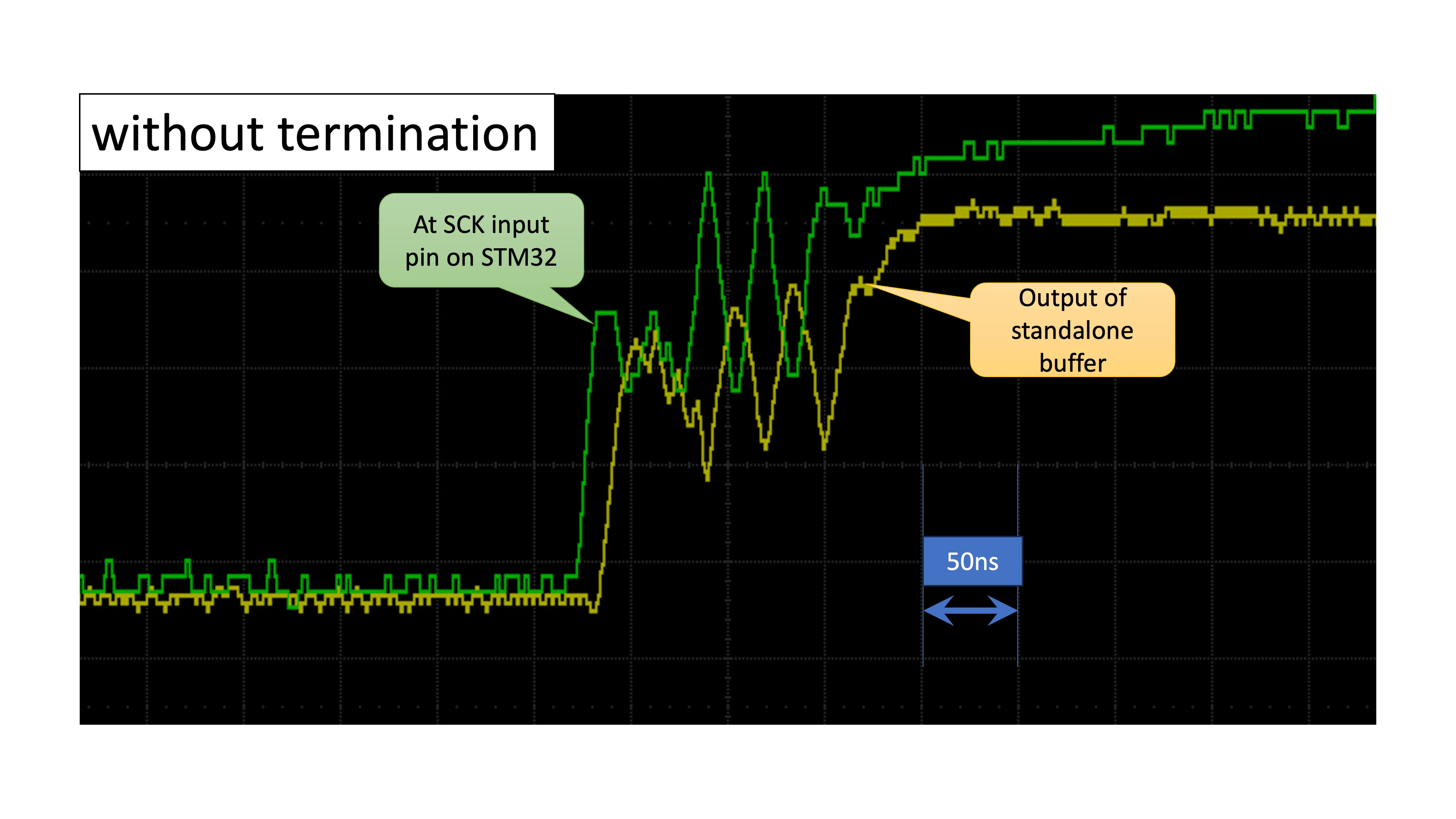

In these plots CH3 is connected to a gpio that tracks SPI_FLAG_RXNE, while CH4 is connected to !SPI_FLAG_BSY .
What I expect to see is SPI_FLAG_RXNE firing with the rising edge of SCK on the reception of the 8th bit like this:
 However with this SPI driver the SPI_FLAG_RXNE signal seems to look like this:
Result is wrong data received.  This happens independent of SCK speed.  Validated the STM32 slave inputs using a simple bitbang SPI slave, and data is received with no errors.

> single bit flip errors
The previous errors looked like bit shifts, and that's definitively caused by the spike in the edge, usually due to reflections. You should've experimented with OSPEEDR settings before adding the serial resistors.
Bit flips, however, are something else.
Ground/return should be every other line in the ribbon cable, and every signal should have its own return. Remeber the 80-wire "high speed" PATA cable?

When I return a known pattern from slave back to master, I still get garbage:
uint8_t txd [] = {0x11, 0x22, 0x33, 0x44, 0x55, 0x66, 0x77, 0x88, 0x99, 0xAA, 0xBB, 0xCC, 0xDD, 0xEE, 0x FF};

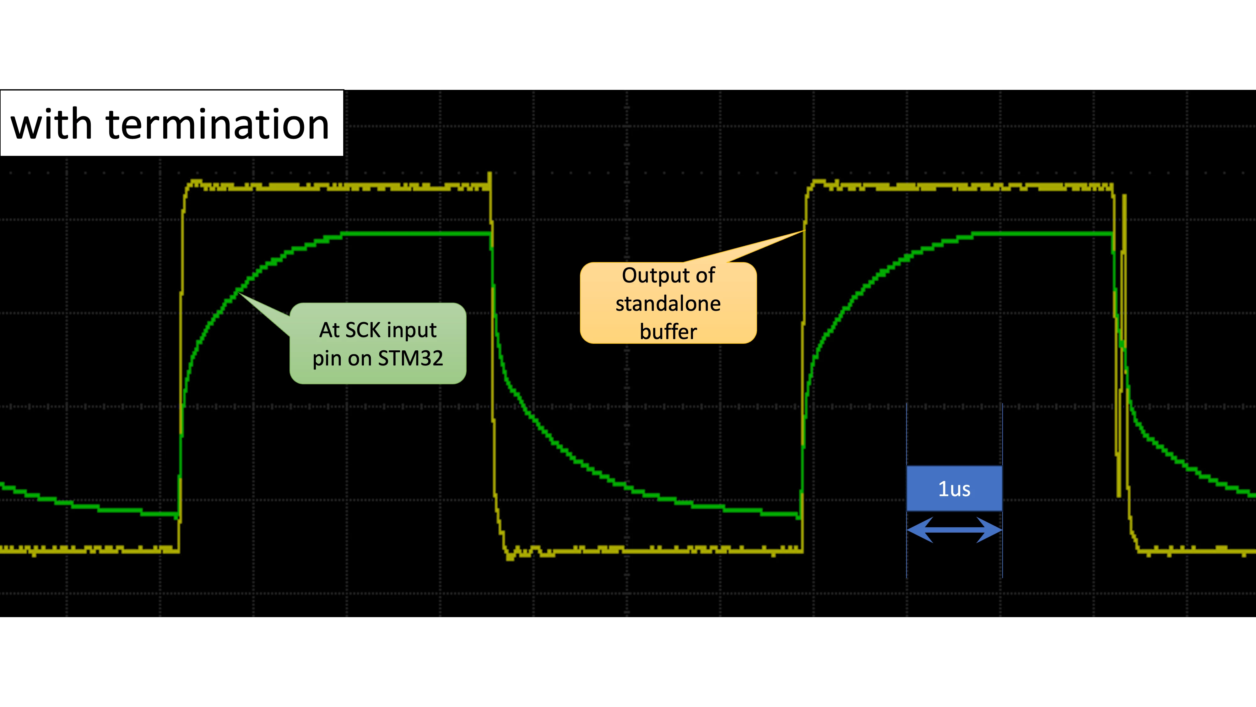

Noise on SCK signal means data is corrupted in both directions, as single posedge clock transitions are counted as multiple...
termination smoothes out the curves, but limits max speed:
the standalone buffer here is really a level shifter with all VDD connected to 3.3V and and all grounds shorted.  Just used as a proxy for what the SPI SCK input on stm32 might be getting after the first stage of IO.

Nov 6, 2023 9:18 AM UTC
Are you really sure that the power supply is powerful enough and the decoupling capacitors are sufficient and correctly placed? I've seen exactly that kind of SPI wobble before, and that was the problem.
