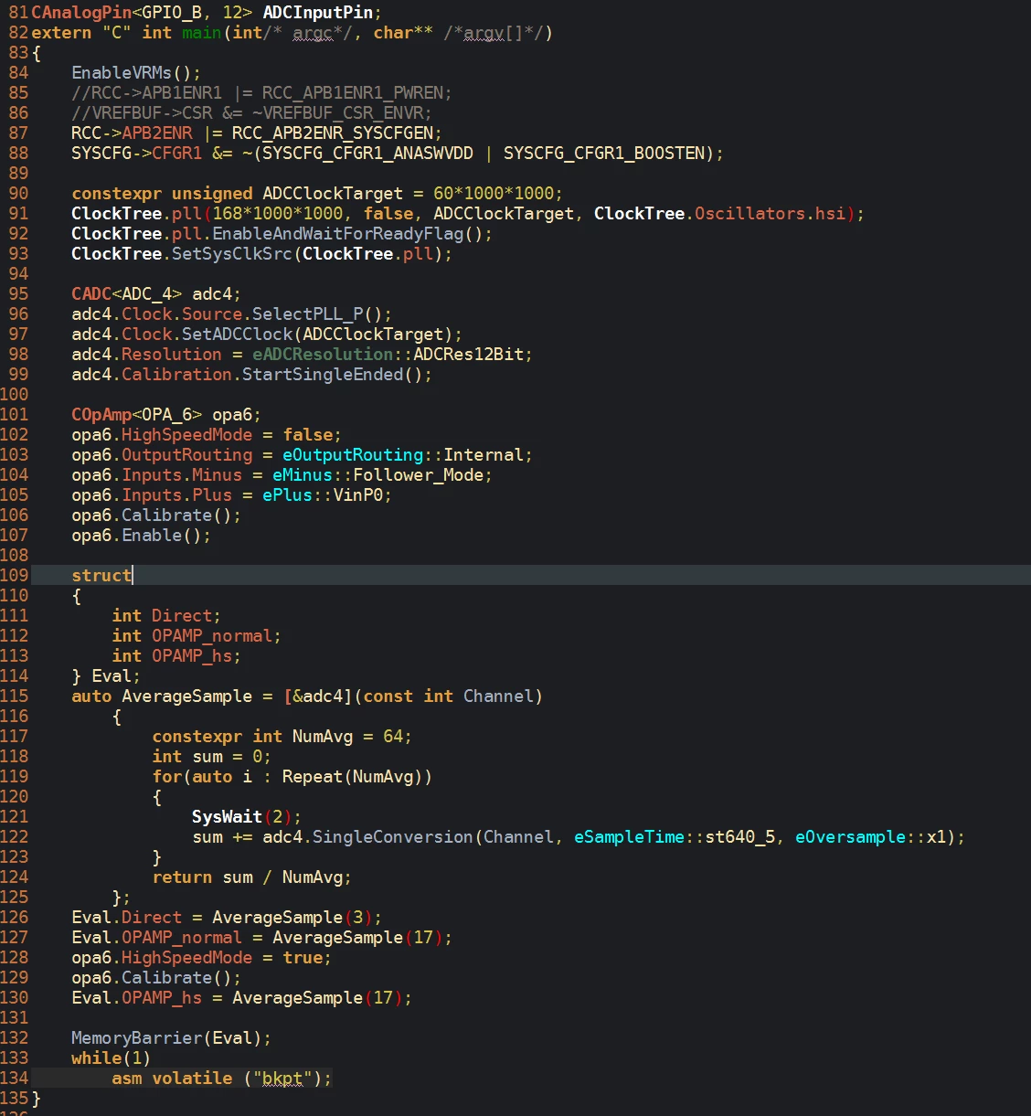

I am using the relatively new STM32G4(74).
I am currently implementing the OPAMP-abstraction and i am having issues with calibration.
The calibration works in general, if the output routing goes to the pin (OPAINTOEN = 0). (n&p is around 15/16)
The calibration does not work (OUTCAL always 0, no matter which trimming values) if the opamp output is routed to the internal connection (OPAINTOEN=1) for e.g. measuring it with the ADC.
Therefore i need to make sure that during calibration OPAINTOEN=0. this->behavior = !documented;
Further i noticed another issue:
When i calibrate (with OPAINTOEN=0), then switch to OPAINTOEN=1 to connect to the ADC, the ADC-Values arent even close to what I expect.
For example, with VREF=3.3V, the OPAMP in FollowerMode, external Voltage=2.413V, i expect a reading of 2995. What I really read is 3060 while the OPAMP is in highspeed-mode and 3420 while the OPAMP is in normal mode. (Sampling time is at maximum, but shorter sampling time does not worsen the behavior)
It seems like the internal connection is straining the OPAMP far beyond its output current capabilities. This would also explain why the reading changes, if high-speed mode is enabled.
And this output strain would also explain why the calibration fails.
I however dont understand why calibration is setting-depended, since the documentation states, that all switches should be opened.
I have tested all OPAMPs 1..6. They are all the same concerning the calibration miss-behavior.
The ADC-value desaster is tested with:
  • OPAMP2 connected to ADC2/Ch16 as Follower.
  • OPAMP6 connected to ADC4/Ch17 as Follower.
The ADC value seems independend of highspeed mode with
  • OPAMP4 connected to ADC5/Ch5 as Follower
  • OPAMP3 connected to ADC2/Ch18 as Gain x32
Does anyone know what is wrong here?
 It really seems strange, since the OPAMP->ADC connection is a highly advertised/mentioned feature in those chips. Yet, it really sounds like a silicon bug. Specially the calibration dependence on output routing....

Meanwhile i have tested the self calibration behavior on another chip. Same behavior.
Except OPAMP3... there changing the output routing just highly shifts the calibration values around.
Is this as silicon bug? It is clearly against the documentation.
Which information are needed to confirm this issue or diagnose the problem?
Is there any specific setting needed to operate on 3.3V @ VDDA and VDD besides disabling the analog boost in SYSCFG? What could lead to this misbehavior..
I am just not finding any information and the HAL-Code from CubeMX is some utter ********. There is only a comment /* Self calibration is successful */ but this fact is not checked at all. I think it is reasonable to consider any calibration a failure if the calibration value result is at its extremes (either 0 or 31) since there is no proof, that not a lower or higher value would be necessary.

I have verified it with CubeMX. I made a project which enables OPAMPS, configured the Outputs to internal and turned on self calibration.
I have updated the self calibration function to check if CALOUT has seen both states (1/0) since the datasheet says that the transition from 1->0 is the signal for successful calibration. If no transition happened, then the calibration is a failure. Currently i only run into a "asm volatile ("bkpt 0") instruction to trigger the debugger. This is the new cal-function with actual error checking.

I think the next step is that others could reproduce this hardware bug or maybe just by chips are bad.
I have attached the CubeMX project file (hopefully it is enough).
You can generate code, load the project, replace the HAL_OPAMP_SelfCalibrate with what i just posted above and just run. If the calibration fails, the debugger will automatically stop.
Can please anyone try this? I am quite desperate by now since i cant get usefull ADC data from the OPAMPs. :(

​Hi,
We have tested this and confirm it is a silicon limitation (this will be documented). As it is done today, the calibration method here-above only works with external output routing.
The work-around is to use the ADC to read the internal OpAmp connection, instead of the CALOUT bit, and decode the ADC value as a logical one or zero. The algorithm  is the very same, including the 2ms delay for taking a decision on the right trimming value.
Thanks for your feedback!
Vincent
PS: in parallel, we are also double checking your ADC reading error, we'll keep you posted.

I think the spirit of Vincents answer is to use the MSB of the ADC-reading as the CALOUT equivalent.
I wonder if one could actually extrapolate some ADC-Readings and predict the final reading and get a much faster calibration that way.
If the derivation over time of the ADC reading is not large enough (or has the wrong sign) to flip the MSB within 2ms, that would be interesting

Concerning the ADC reading error, i try to help you there. I have a STM32G747 in my circuit that has an external driven analog Voltage at PB12.
That pin can connect to ADC4(in3) and to OPAMP6 (VINP0) which gives the opportunity to test it all:
1) reading directly via ADC4 Ch3.
2) Configuring OPA6 in follower-mode (normal speed) and read ADC4 Ch17
3) Changing OPA6 into high speed mode and read ADC4 Ch17 again.

Hi Vincent,
i have tried the PB12 experiment. I have attached all relevant code concerning the test procedure:
  • maximum sampling time
  • averaging of 64 samples
  • 2ms wait time between sampling:
  • External voltage @ PB12 = 1.329V
  • VREF = 3.300V
  • VDD = around 3.3V
  • Expected ADC-Reading = 1.329/3.3*2^12 = 1650.
0690X00000ArLT5QAN.pngWell...
Eval.Direct = 1688,
Eval.OPAMP_normal = 1721,
Eval.OPAMP_hs = 1609
No where near... :loudly_crying_face:
Reducing the ADC-Frequency from somewhere near 60MHz to 6MHz:
Eval.Direct = 1720,
Eval.OPAMP_normal = 1704,
Eval.OPAMP_hs = 1736
Reduced effect, but still unacceptable. The change in the apparent absolute value is also a little strange..
There is some run-to-run variation of the ADC-readings. There might be some noise on PB12 in my circuit. However, no matter the values, the relative differences between measurement methods stay somewhat constant. Please consider the values above "representative". Especially have a close look at the influence of the OPAMP speed.
As you can see i am using my own C++ framework. It is entirely possible that i am missing an important bit/setting somewhere.. if so, it is practically undocumented or very well hidden.
Edit: i have done some signal analysis via FFT and stuff (using 2048 samples @ 10ksps).
  • My RMS signal noise is 2.3LSBs when i sample directly from the pin
  • 2.1LSB with OPAMP in high speed mode
  • 6.5LSB with OPAMP in normal mode...

HELP :( Anyone there? Shall i try new processors? Can someone from ST please confirm or deny that there was a bad batch or maybe that certain circuit behavior (like an accidentally bad power on sequence?) could damage the chip this way?
Vincent Onde
November 5, 2019
​Hi Albrecht,
Sorry, I was out for a while...
It's difficult to guess if there are issues with ADC configuration using the code attached. If possible, a register dump would be better.
Considering the code is fine, there may be 2 explanations for what you're seeing now:
  • the interval between 2 conversions is too large (there must be no more than 1ms idle time
  • the routing around ADC is not optimum. Eventually some ringing on the analog input(?), a Vref+ and/or Vdda decoupling not sufficient? The capacitor on Vref+ in particular is critical, it must bez located as close as possible from the MCU).
Are you facing the same issues with a Nucleo board?
Best regards,
Vincent
