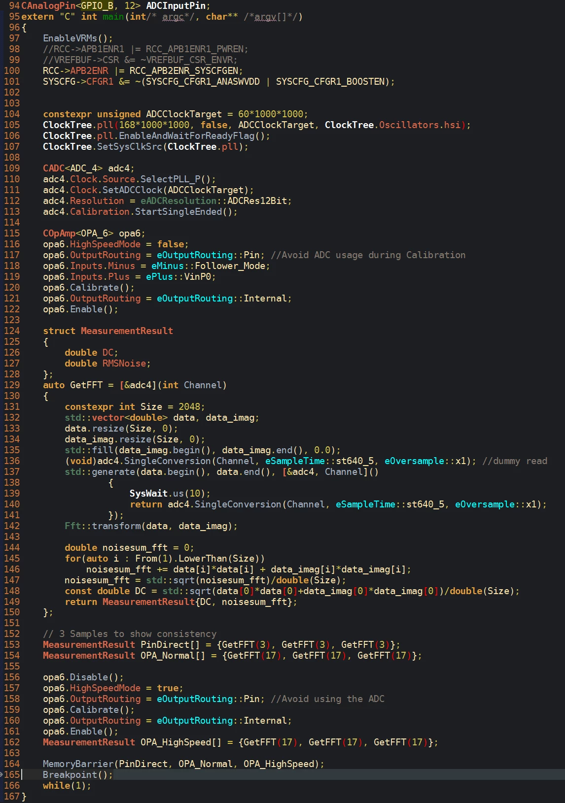

Concerning the weird OPAMP behavior: the new code for FFT analysis looks like0690X00000Aril2QAB.png
So i sample definitively quick enough (10µs artificial waiting time between adc invocations, Line 139)
The voltage at PB12 is 1.623V this should give an ADC reading of 2014.
The sampled data in reality is:
PinDirect.DC = {2107.349, 2107.374, 2107.426}
PinDirect.RMSNoise = {2.345, 2.297, 2.339}
OPA_Normal.DC = {2548.031, 2547.769, 2547.841}
OPA_Normal.RMSNoise = {3.308, 3.276, 3.203}
OPA_HighSpeed.DC = {1996.755, 1996.913, 1996.964}
OPA_HighSpeed.RMSNoise = {2.310, 2.32, 2.360}
The measured pin is driven by an TLV9064 in my circuit. The sample time at maximum.
I dont think any DC value is acceptable close enough to 2014 +/-noise. The OPA in normal mode is totally kaputt, the Highspeed mode performs the best, however this might be purely by accident. However the the measurement seems repeatable and consistently wrong.
Now it becomes more interesting. I agree that due to my own software framework a register dump would be helpful. I challenge you to tell me which peripherals need to be dumped in order to get a full overview over the important settings. Maybe you name things that i have missed which would already solve the problem.
I have ordered a Nucleo board. I can spare the 15€... but it will take time to arrive. However I use the QFN48-package on my board; can you tell me if the die of the nucleo board is comparable (same die, different bonding)? If it is a different die and the results are different, then the result would be kind of meaningless but interesting nevertheless (to confirm software correctness).
FunFact: the 1.623V is generated via the DAC=2048. The DAC output is used to set the DC-Bias of the TLV9064 output. Basically, DAC + uncalibrated PinBuffer-Offset + TLV9064-Offset = 1.623V. which should be 1.65V. The offsets summing up to 27mV is a bit much. It seems like all the analog things are just weird :( VREF is generated by REF3433. VDDA is derived from VDD at a 10uF MLCC through a 600R@100MHz bead, decoupled by 1uF+100nF close to the chip but both capacitors sit on the other side of the board. The VREF-Pin is connected through a via not more than 1mm away from the pad to the capacitors with the via ring touching the capacitor pads.

@Vincent Onde​ !!!!! I return in shame to tell you that i ****** up baldy.
Basically, because of the ADC register access is highly conditional (some registers may only be written under certain conditions), i gave up on keeping track of all the ifs and buts and flat out disabled the ADC to set up every single conversion in my SingleConversion(...)-function only to reenable the ADC and then trigger the conversion. AFAIK this is a behavior already covered in an errata or ADC related document and it should be avoided.
And indeed, keeping the ADC alive during all sampling makes all the difference. At least the OPAMP in normal mode is not crazy out of wack anymore. Still, i have some much higher than expected offsets, but there is an improvement.
I will add results later today.
