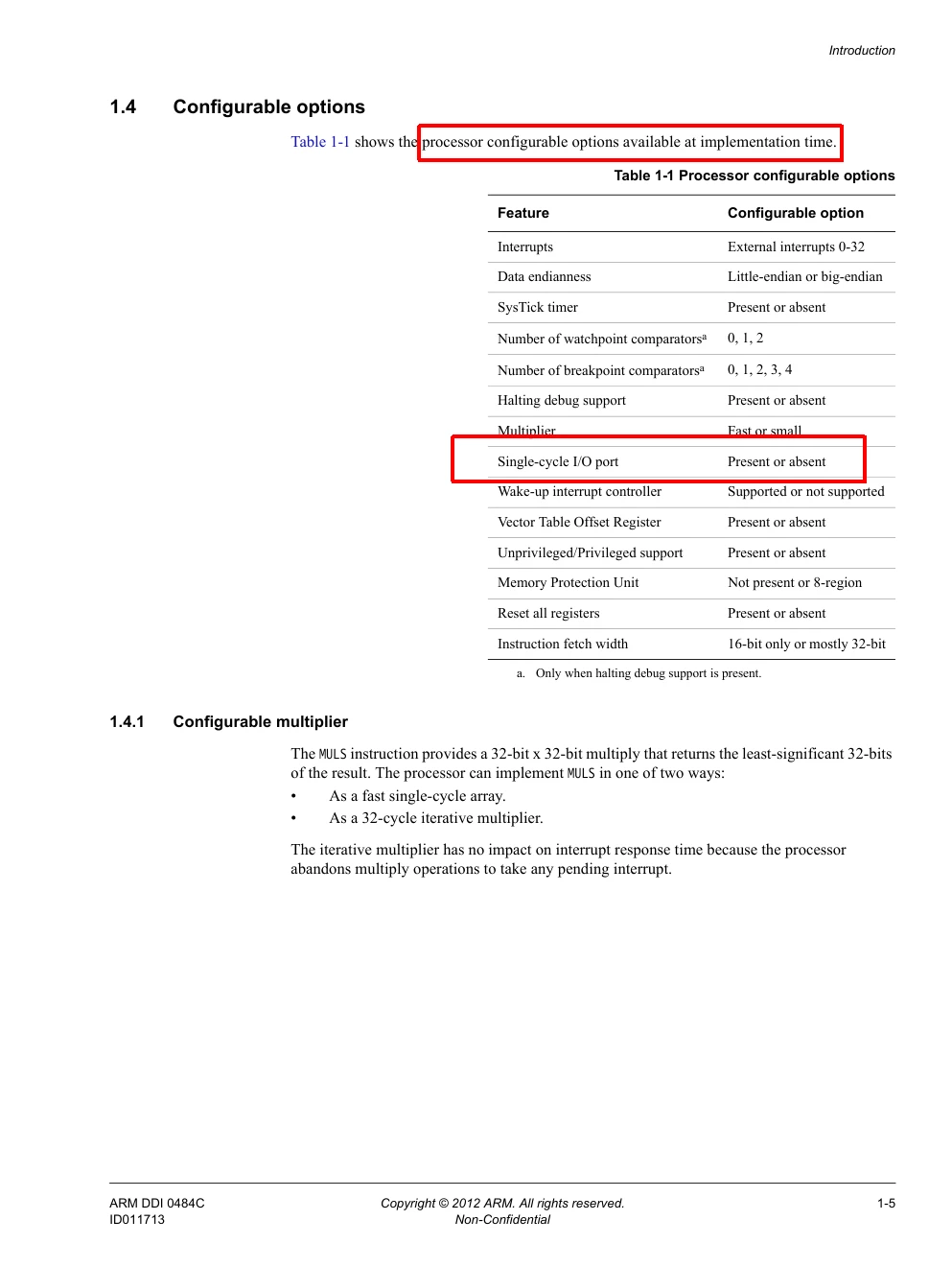

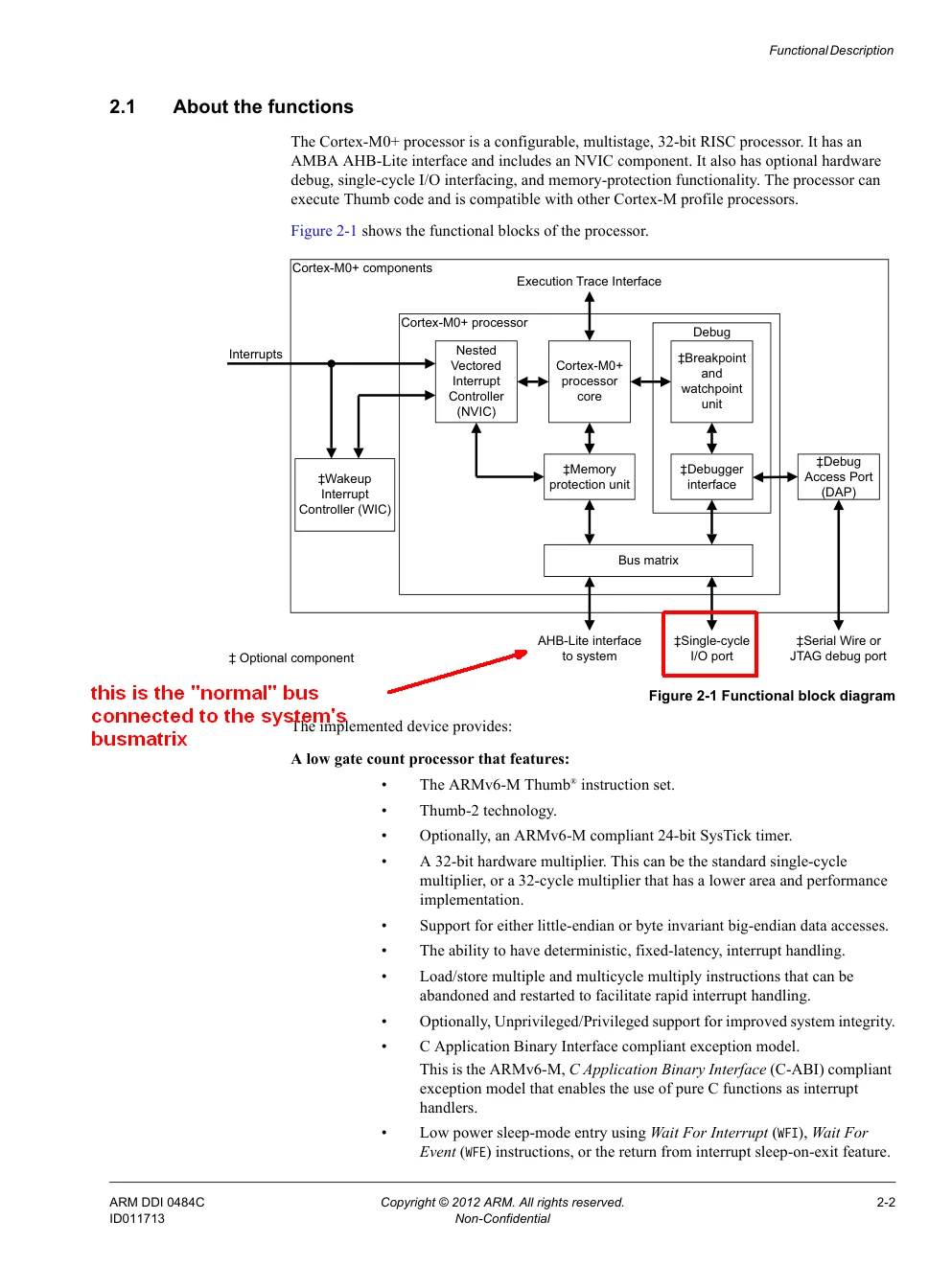

> 9. RM0503 page 56, figure 2: It is missing IOPORT address. See STM32G0 RM.
While true that it's not there, its not material, as IOPORT is not used in 'U0, in contrast to 'G0 (thus e.g. enabling DMA to GPIOs).
14, what a typo! :)
AA1
AA1Author
Senior III
February 17, 2026
IOPORT is GPIO and so it is used in 'U0'.
waclawek.jan
February 17, 2026
No, IOPORT here refers to a private bus of the processor, exposed as a separate bus, not accessible from rest of the system. The processor itself decodes the 0x5000'0000 addresses to it.
In 'U0, apparently, ST decided not to implement IOPORT, thus the 0x5000'0000 address is decoded to the system bus, where in the bus-matrix it's connected to the GPIOs.
But you can try yourself: try DMA to some of the GPIO in both 'G0 and 'U0.

I updated the post and removed this item.
