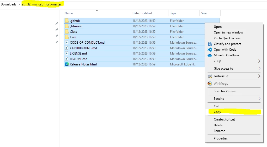

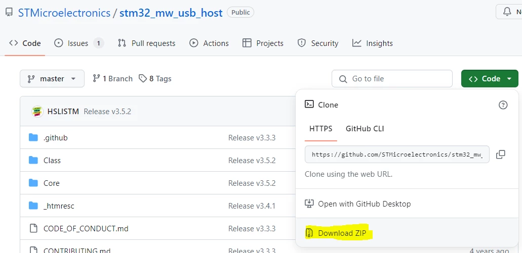

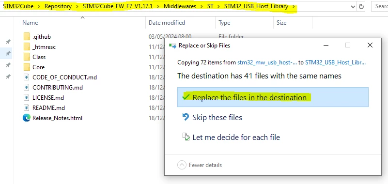

Best answer by KDJEM.1
Hi @MMARI.1 ,
Go on the GitHub - STMicroelectronics/stm32_mw_usb_host: Provides the USB Host library part of the STM32Cube MCU Component "middleware" for all STM32xx series and download as zip.
Unzip the files and copy all folders to   \Repository\STM32Cube_FW_F7_V1.17.1\Middlewares\ST\STM32_USB_Host_Library  by replacing the old files.
Then, open your HID_Standalone project in Repository\STM32Cube_FW_F7_V1.17.1\Projects\STM32F722ZE-Nucleo\Applications\USB_Host\HID_Standalone and Run.
I hope this help you.
Thank you.

KDJEM.1
May 2, 2024
Hello @MMARI.1 ,
Could you please try to upgrade the USB middleware to 3.5.2 version.
Please let me know if the issue is solved or not.
Thank you.
Kaouthar
MMARI.1
MMARI.1Author
Senior II
May 3, 2024
hi @KDJEM.1 @Pavel A.
i couldn't find any middleware update option menu in ioc or in the project file.
can you please tell me small procedure .
KDJEM.1
KDJEM.1Best answer
May 3, 2024
Hi @MMARI.1 ,
Thank you.
Kaouthar

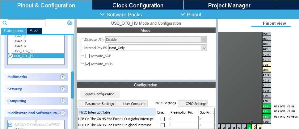

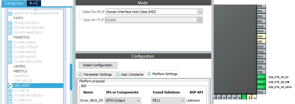

MMARI.1
MMARI.1Author
Senior II
May 3, 2024
hi, after USB middleware update keyboard started working with USB_FS via PA12 & PA 11.
then i disabled USB_FS (pin PA12 & PA 11) and enabled Internal_Phy_Fs via PB15&PB14 found keyboard not working .
i need 2 USB_FS line for different purpose
