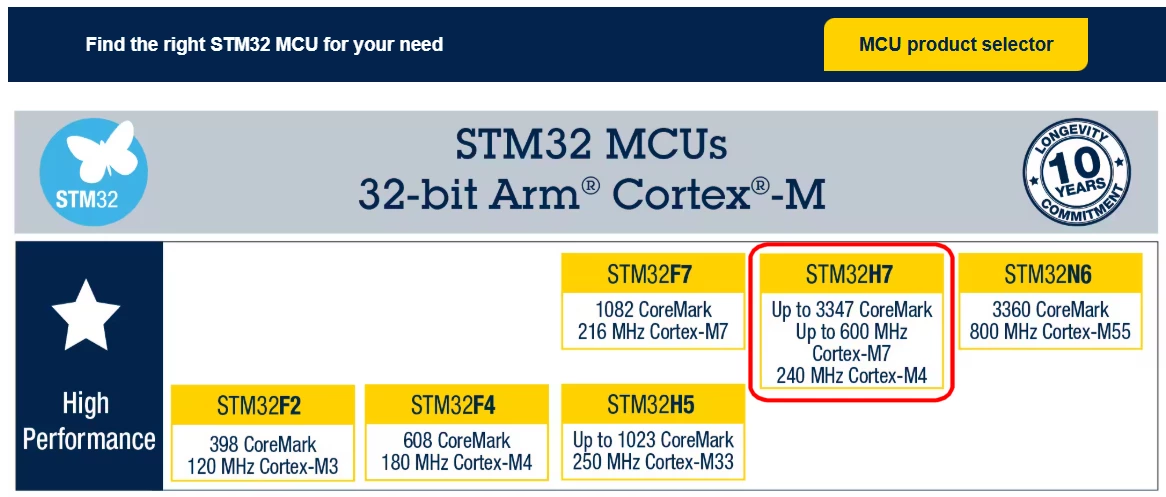

Overview of the STM32 Microcontroller range here:
https://www.st.com/en/microcontrollers-microprocessors/stm32-32-bit-arm-cortex-mcus.html
You can see that STM32H7 is the dual-core family
https://www.st.com/en/microcontrollers-microprocessors/stm32h7-series.html

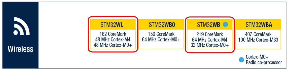

@STbeginner wrote:
  • Over The Air programming: Yes
So you want a radio?
Options there are:
But they may not fit your other criteria.
Perhaps explain your actual system requirements?
As @Ozone says, why specifically dual-core? What system requirement drives that?
Jul 22, 2025 12:53 PM UTC
Thanks for replying i don't need a radio it's more like an RFID reader controller, like an access control system.
Andrew Neil
Jul 22, 2025 1:05 PM UTC
@STbeginner wrote:
i don't need a radio .
You said you wanted Over-The-Air programming.
So that's not actually a real requirement?
Jul 22, 2025 8:22 PM UTC
Probably any STM32 MCU can meet your needs. RFID reader is not going to tax any onboard resources.
Narrow your search by choosing cost/size/performance. If these not restrictions, STM32H7 is going to be the most powerful. Single core will be much easier to work with. I am unconvinced that your project requires dual core. Obviously, it's up to you but expect the overhead and learning curve of a dual core to be significant.
