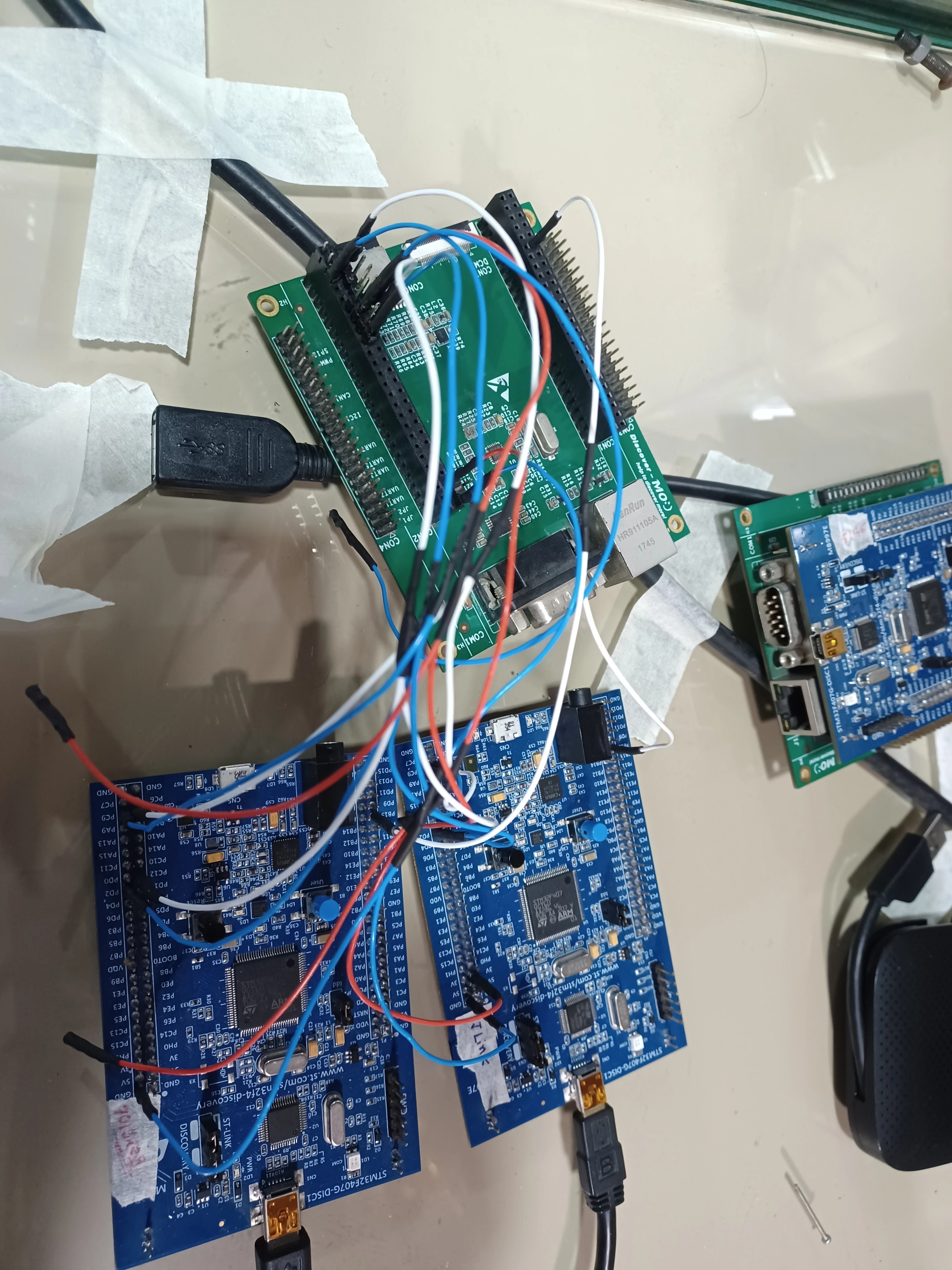

my observation: I took two STM32F407VGT6 microcontrollers and connect them the to same SDIO
source it(setup) is not working when both boards are powered on but when USB and FATFS works fine seperatly the problem is in two pins (PC10 and PC11) D2 & D3 please give me solution for the following:

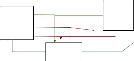

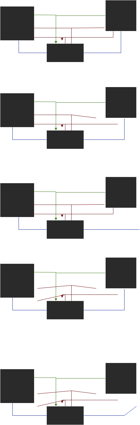

I am still facing issues in my project. I want to use USB functionality, but I am unable to do so due to a problem with SDIO pins PC10 (SDIO_D2) and PC11 (SDIO_D3). I am trying to connect two STM32F407VGT6 microcontrollers with the SDIO pins of the same discovery board (DM-STF4BB). We have uploaded USB (device-Mass storage device) code in one microcontroller, but that code only works when PC10 and PC11 pins are not shorted/connected. It doesn't matter if the second board is powered or not; connecting these two pins will always create a problem. And I want design a PCB in which only single controller will be powered at a time please guide me what to do, we can not use shottkey diode in PC 10&11 and VCC  because of voltage loss, will MOSFET work ?
Consider the two red lines as PC10 and PC11 (D2 and D3 respectively), green lines as other SDIO lines with ground, and blue lines as VCC. Two squares represent STM32F4, and the rectangle below represents the SDIO device with an SD card.
code is uploaded in first STM32 on the left side
USB and FATFS functionality will only work in the following configuration
where as the USB will not even detect by any of the following configurations:
