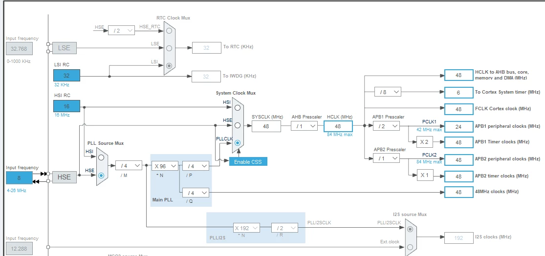

I had the same problem, 1 bit mode was working fine, 4 bit mode wasn´t.
In the end i got it working by setting the SDIO clock divide factor to 3 and set the clock configuration as the following:
