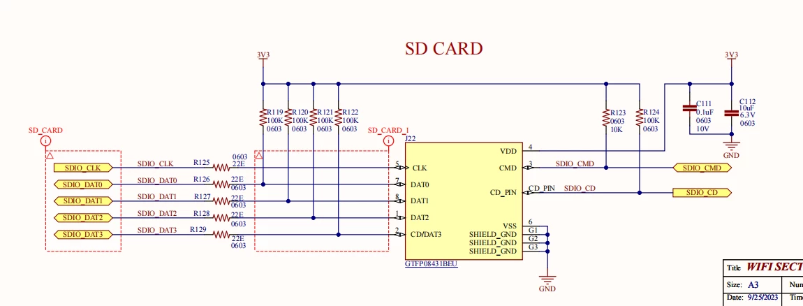

i get `FR_NOT_READY`, `HAL_SD_ERROR_REQUEST_NOT_APPLICABLE` errors .
/* If requested card supports wide bus operation */
if((scr[1U] & SDMMC_WIDE_BUS_SUPPORT) != SDMMC_ALLZERO)
return HAL_SD_
return HAL_SD_ERROR_REQUEST_NOT_APPLICABLE;
  }ERROR_NONE;
else
How do I fix this and make SD card work with 4bits wide bus?

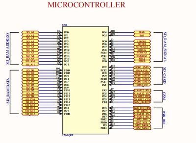

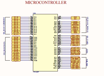

sd card scematic   (part number-GTFP08431BEU)
Microcontroller scematic  -

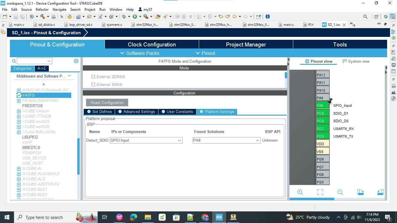

- How is your FATFS --> Platform settings --> Detect_SDIO pin configures and connected?

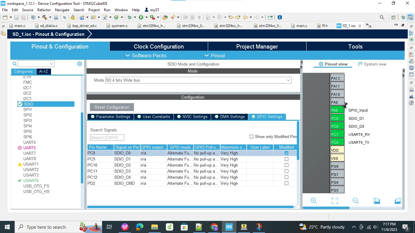

The exact san disk model? (So I can look at the datasheet)?
Possible to add a picture of the physical setup? Wires etc.
.IOC file pictures of:
-  FATFS Platform settings
- SDIO GPIO settings
November 6, 2023
sandisk model - SDSDQM-008G-B35
sd card schematic-
SDIO GPIO Setting
November 6, 2023
