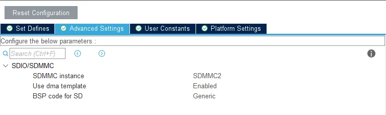

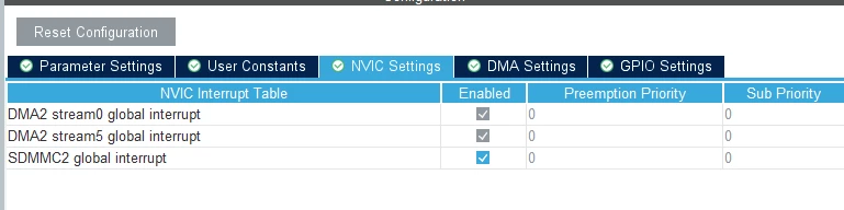

I reduced the speed of the SDcard to 400kHz and mounted it on a nucleo board. Still did not do it on the custom board. I now have the feeling something is not right with the custom board.

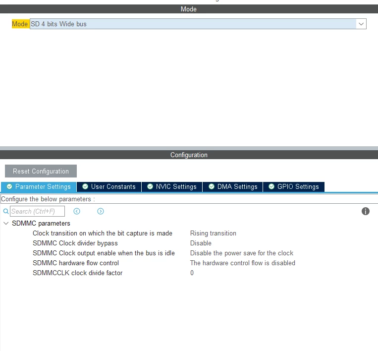

Try with 1 bit mode. If it does work see this thread.

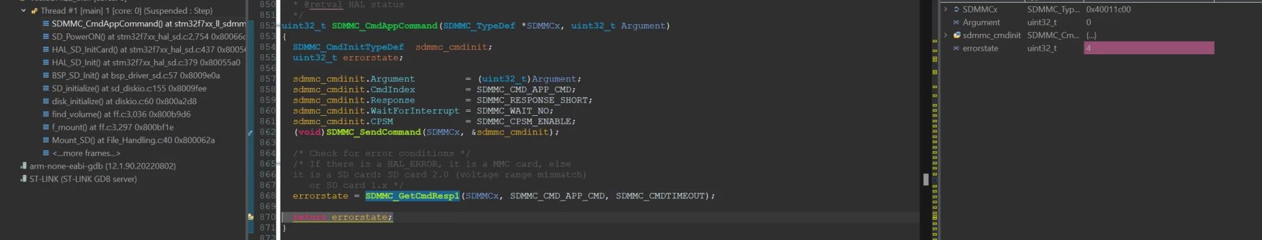

The code fails only after :-
 if (HAL_SD_Init(&hsd) != HAL_OK)
 Error_Handler();
It fails in the HAL_SD_Init() only even after changing to 1B.

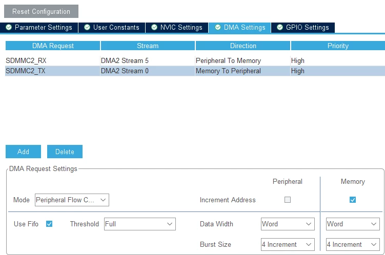

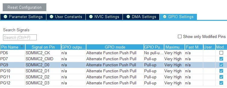

try simple setup for beginning with sd-card:
- 1 bit mode
- no dma template
- port/pins : all on speed: medium + pullup on
