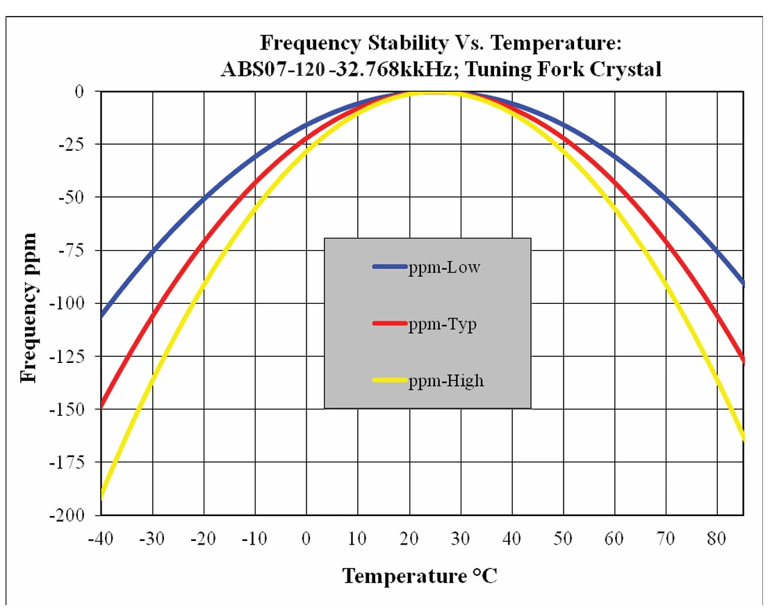

I'm developing a device with these requirements:
  • STM32F446RET6
  • No internet (NTP) or GPS connection
  • Real-Time clock, set manually (so, the less often a user has to set it, the better)
  • Outdoor -20°C~70°C temperature range (most installations in continental USA)
Ideally, we would like to get our total clock drift under 10 minutes/year (20 ppm) if possible.
I created one prototype using an Abracon 32.768kHz crystal for the LSE, with two C0G 6pF load capacitors. To test the prototype, I routed the LSE to the MCO1 and measured the clock frequency as we swept the temperature from -20°C to 70°C in our temperature chamber. I measured that and compared the ppm deviation to the expected deviation given by abracon (ppm = (T-25°C)^2 * (-0.035ppm)):

So, my next steps that I was planning was to:
  1. Test various load capacitances to try to bring the room-temperature error as close to 0ppm as possible
  2. Use software calibration to modify `CALP` and `CALM` on-the-fly according to the ADC temperature, to counteract (1) the room-temperature ppm offset of the crystal and (2) the offset incurred by high and low temperatures (abracon equation).
However after doing some research, I'm a bit less confident about my approach
  • The temperature slope I measured was different from the one given by the Abracon datasheet
  • The measurement period for the RTC after calibration (32 seconds) is very wide, and I'm unsure if our equipment is suited for it
  • I don't know how I will tune each device if the temperature slope differs for every crystal.
Is it feasible to tune a RTC like this to achieve 20ppm accuracy over a wide range of temperatures using only software? Or am I better off getting something like a temperature-controlled oscillator?
Thanks!
TDKBest answer
January 21, 2026
From the crystal datasheet, the range in accuracy varies by more than 20ppm over the 20-70 temperature range. Note the delta from the blue and yellow lines.
So that's not a viable solution unless you have the tools and time to calibrate each crystal independently.
You're better off with a TCXO.

January 21, 2026
Ah, yep. That's a good point, I should have noticed that.
In general, is this a viable strategy, assuming a wider ppm accuracy is acceptable?
Thanks
January 21, 2026
It's an okay strategy if the temperature is stable. It's not going to give you the accuracy of a TXCO though.
Your code will be more complicated, and you will use more power, it will be less accurate (compared to TXCO), but it will be cheaper in parts cost.
