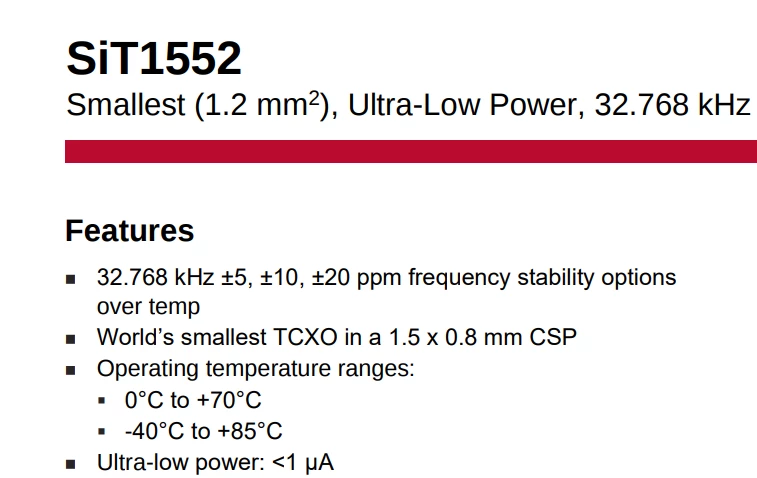

AScha.3
AScha.3Best answer
January 9, 2026
> range of -40 to +85C.
> target accuracy is +/-1 minute over 180 days.  That works out to +/-3.858 PPM.
Forget it. Thats not realistic, because :
A standard 32.768 kHz tuning fork crystal typically drifts by approximately -150 ppm to -180 ppm at the extremes of the -40°C to +80°C range.
And basic anyway only at +/- 20 ppm.
For anything close to your expectations you need a TCO , external oscillator: HSE bypass.
To maintain high accuracy across this wide temperature range, a Temperature-Compensated Crystal Oscillator (TCXO) or an integrated RTC with internal compensation (like the DS3231) is required to stay within ±10 ppm.
btw
I use a mems TCO :
https://www.mouser.de/ProductDetail/SiTime/SiT1552AC-JE-DCC-32.768D?qs=dMZC7um9hO%2FIvYvvHhpVFQ%3D%3D
18 replies
