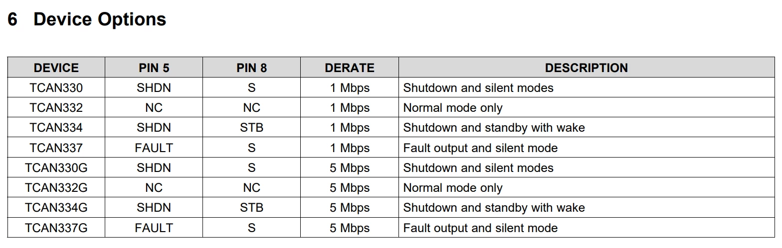

Firstly, the can transceiver may not support this speed.
The can transceiver I use is TCAN334D.
It says up to 1 Mbps in the datasheet, but I was able to get 2Mbps as well.
No, the TCAN334D datasheet says that it could reach 5Mb/s:
So that's normal you didn't get it worked at 8Mb/s but worked at 2Mb/s.
Replace the transceiver: example: MCP2561FD or MCP2562FD to reach 8Mb/s.
Meanwhile, read this article: STM32 FDCAN running at 8 Mb/s on NUCLEO boards: Same bitrates you are using
Hope I answered your question.

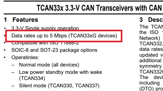

CANZT-FDAuthor
Nov 21, 2024 1:43 PM UTC
Thanks for your answer.
The speed up to 5Mbps is written for TCAN33..G series, I am using the D series. so it may not support 5Mbps speed..
I can change the transceiver. I can use MCP series, but I am wondering if it can be fixed with the functions written here..
https://community.st.com/t5/stm32-mcus-products/stm32h7-fdcan-8-mbit-s-setup-docum-unclear-sync-seg/td-p/79992

mƎALLEm
mƎALLEmBest answer
Nov 21, 2024 1:47 PM UTC
Ok but D suffix was not listed in their table:
Enable the delay compensation but the most important thing is to use a transceiver that can reach 8Mb/s.
And it worked at 2Mb/s because the chip manufacturer has a margin and that could not work for all the conditions.
Hope that answers your question.
CANZT-FDAuthor
Nov 21, 2024 1:40 PM UTC
If it could support up to 5 Mbps speed. It should have supported 4Mbps speed, but it does not work at 4Mbps.
