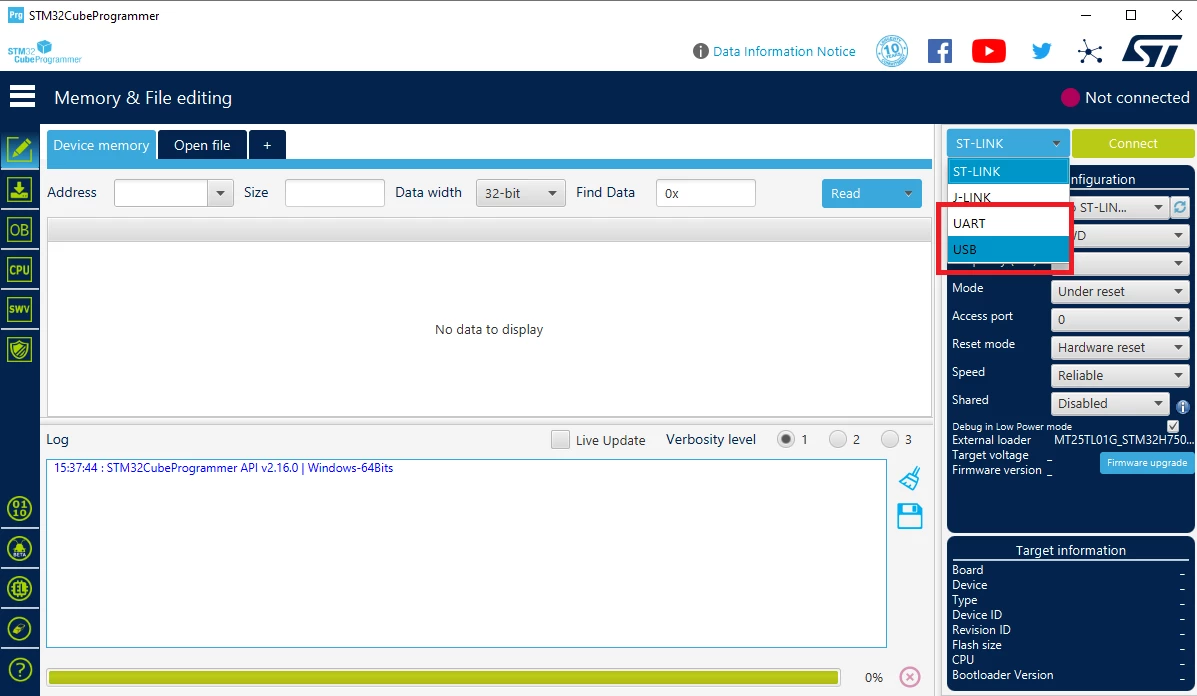

1. is there any tool (GUI) to update program using executable?
2. How to have different modes of programming? (UART/ USB/ sd card)
Using STM32CubeProgrammer tool
Read AN2606 STM32 microcontroller system memory boot mode / Read the table " configuration in system memory boot mode" that corresponds to your device. It describes the different resources and which interface is used for bootloader for that device. SD card is not a part of the ST bootloader you need to develop it yourself.

I tried using STM32CubeProgrammer and was able to program using ST-Link.
but I tried USB FS device with DFU, and STM32CubeProgrammer was able to detect USB and when connect is pressed...the bottom bar keeps on searching and never finishes...this is with STM32F469 discovery kit.
