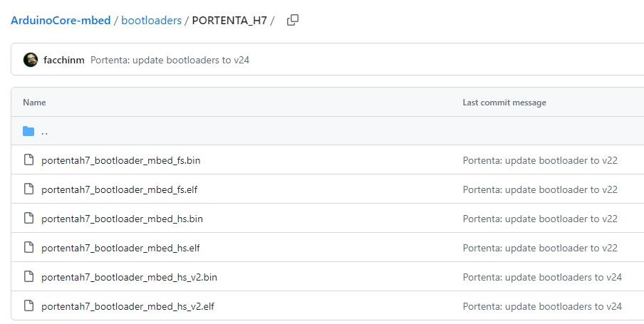

What you describe could be caused by the corrupted Arduino bootloader!
I don't know but I see that in the official github repo there are different versions that operate in USB FS or HS. https://github.com/arduino/ArduinoCore-mbed/tree/main/bootloaders/PORTENTA_H7
As the code is not available, could you ask to the Arduino community for help?
I don't have the hardware diagram of the Portenta H7 but I assume that their bootloader firmware configures the internal SMPS then the clock of the STM32H747I to ensure correct boot sequence.

Thank you for your advice. My bad for not being a little (lot!) more specific. I am very intimate with the STMCube family of developer tools. I have been battling loading a simple blink program from the STMCubeIDE to the H7 via the JTAG connectors on the Portenta Breakout board. I have indeed crushed the H7 bootloader several times but I am successful in re-flashing it (portentah7_bootloader_mbed_fs.bin) at address 0x08000000 via the STM32CubeProgrammer and the requisite hardware (ST-Link, JTAG 2.54 mm to 1.27 mm pitch adapter). Though it seems to have lost the DFU pieces as my PC won't even recognize it and assign a COM port. This is the first thing I must fix. Any help there would be greatly appreciated. Note that because of this issue flashing the bootloader from the Arduino IDE is not an option (there is no COM port). It is my understanding that when the H7 is connected to the breakout boards JTAG connectors the ST Link does not need the COM connection to flash the bootloader or code.
I have made adjustments to the linker file to accommodate the flash address for the size of the Portenta H7 bootloader (portentah7_bootloader_mbed_fs.bin).
I have resorted to using the STM32CubeProgrammer to flash the CM7 and CM4 .elf and or .bin file at addresses 0x08040000 and 0x08100000 respectively (everything compiles just fine, as expected). STM32CubeProgrammer reports success every time for flashing the bootloader and the CM7 and CM4 code. But the H7 does not run the blink program. Ironically, the STM32CubeIDE reports problems when trying to run the blink program in either Debug or Release.
