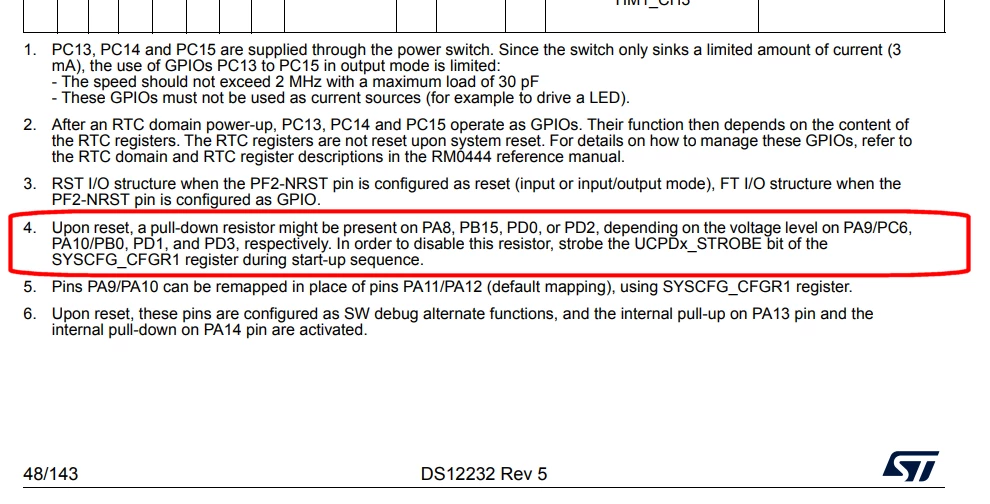

https://www.st.com/resource/en/datasheet/stm32g071rb.pdf#page=48

July 16, 2025
Which board do you use?
In DS12232 section Pinouts... PD0 and PD2 are said to have an IO structure of "FT_c" where the _c means "USB Type-C PD capable" and they have an additional function of UCPD2_CC1 resp. UCPD2_CC2.
Does your board have an USB port connected to them?
Andrew Neil
Andrew NeilBest answer
July 16, 2025
@KMill did you see my PS?

AHA! A smoking gun!
Thank you - that sounds like exactly the sort of thing that would cause this. I'll try strobing that bit and see what happens.

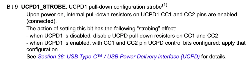

July 16, 2025
@Andrew Neil Thank you!
The STOBE Bit was the issue.
I set the appropriate bit in SYSCFG1 and now it all works as expected.
You have saved me a lot of grief! Who would have thought the Pull-Downs would be enabled when the UCPD Device is disabled?
Always good to check those little footnotes on the the pinout table - there's a few gotchas!
