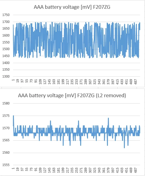

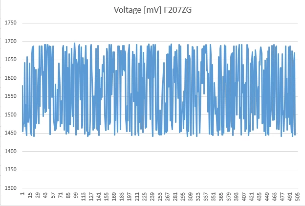

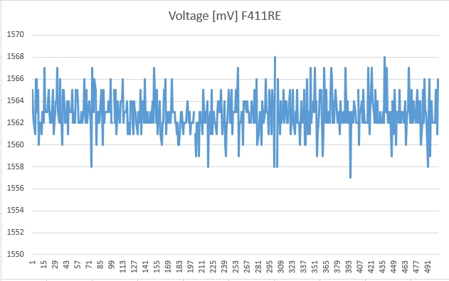

For test purpose I chose 1.5V battery to be measured and I realised that unfortunately only F411 returns stable voltage. I mean the noise was Vpp=10mV. Whereas the other mentioned boards delivered really unstable values (noise Vpp=250mV). I don't understand what is going on :frowning_face:

The author of the solution said that Ethernet PHY causes the ADC noise problem and recommended to remove L2 coil which turn off this interface. I did so and below there are results before and after:
Standard deviation of measurement dropped hugely from near 90 to 1,5.
It seems to be problem with every H7 Nucleo board as each has PHY. The conclusion is that there is no way to use both Ethernet and ADCs, since ADC averaging/oversampling isn't possible in every situation.
