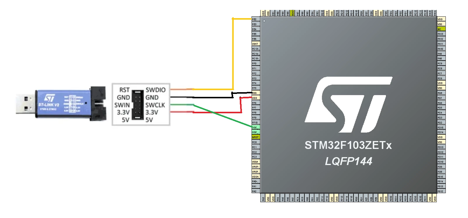

Im very stuck to reading pinout from datasheet, but I try configuration like this:
But still not connected. Btw, I just want to connect it for read flash test.

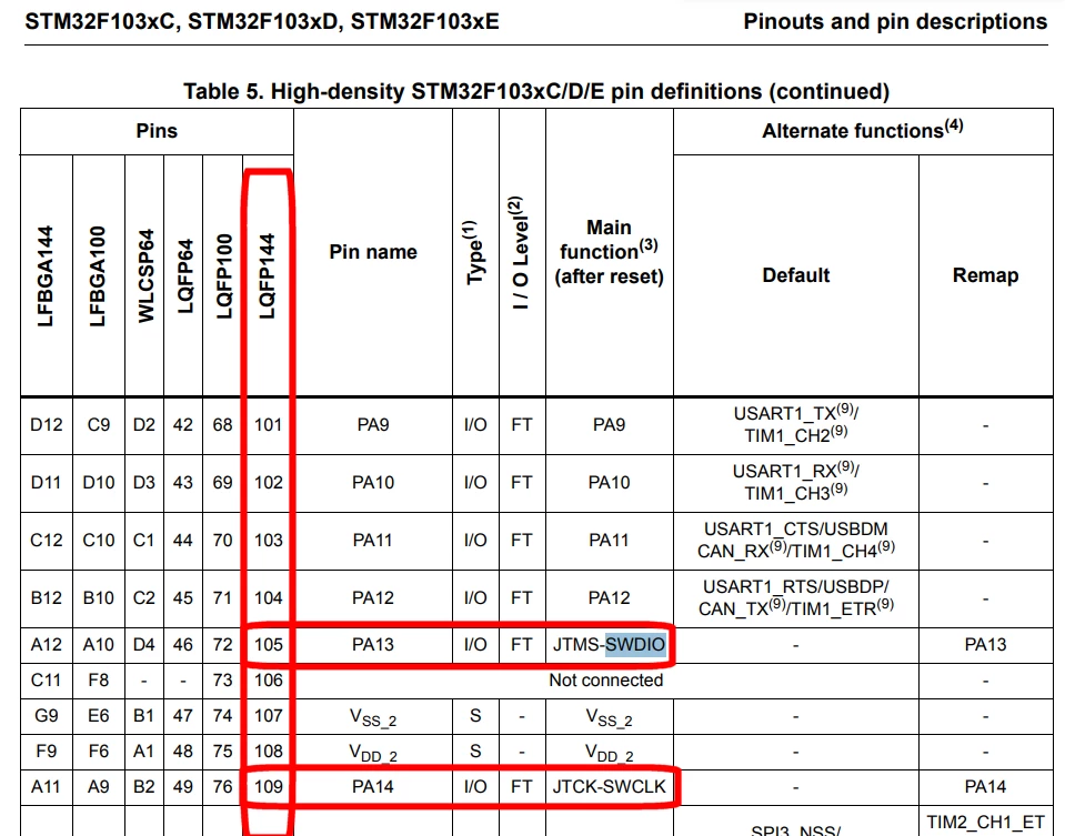

It's all in Table 5:
https://www.st.com/resource/en/datasheet/stm32f103ze.pdf#page=35
via: https://www.st.com/en/microcontrollers-microprocessors/stm32f103ze.html#documentation
Note that this is not a genuine ST-Link - it's a clone:
See How to recognize a genuine ST-LINK/V2 versus a cloned one; in particular, this comment.
Double-check that you have the pinout correct for the actual clone you have - as noted in the above comment.
You need to connect:
  • SWDIO pin from the ST-Link to the SWDIO pin on the STM32;
  • SWCLK pin from the ST-Link to the SWCLK pin on the STM32;
  • RST pin from the ST-Link to the NRST pin on the STM32.
Plus 3.3V and GND

Is your STM32 on a development board? or a bare chip? If its on a board then tell us about the board like its name and make. Other wise if you are using bare chips, it still need few more connection in order to work. Like there are so many VCC pins but you have connected only one of them. Proper level on RESET and boot pins also required and decoupling capacitors also.
avinash_elec
June 21, 2025
You will also be needing decoupling capacitors on all VCC/GND pair. And BOOT pins to select booting from FLASH or RAM and avoid the bootloader.
avinash_elec
June 21, 2025
VBAT pin must also be at VDD level 3.3V
avinash_elec
June 21, 2025
See BOOT0 and BOOT1 pin truth table in Reference manual.
