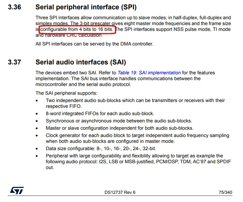

@mfgkw wrote:
That depends on the comm partner.
The STM32L552ZE SPI hardware can't do 32 bits as such - it would have to be synthesised from smaller "chunks" of 4-16 bits.
Andrew Neil
Oct 1, 2025 9:56 AM UTC
That would be down to the MCU - nothing to do with the board - so check the MCU's datasheet.
The datasheet - and other documentation & resources - will be found on the MCU's Product Page:
https://www.st.com/resource/en/datasheet/stm32l552ze.pdf#page=75
via: https://www.st.com/en/microcontrollers-microprocessors/stm32l552ze.html
But, of course, you can send a 32-bit value as 8x4 bits, or 4x8 bits, or 2x16 bits.
Or even 2x8 bits plus 1x16 bits - if you really wanted to ...

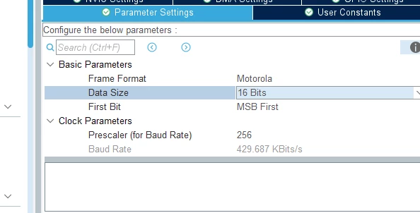

Thank you! What do you mean by  /SS? I am relatively new to programming microcontrollers. I am using the board as a master to control another chip. Basically, if I want to control the second bit of the first register high and the 4-th bit of the 15 register high, seeing something like this should be correct or .....? Can you maybe provide some more insights, please? Because I see here some idle time after 16 cycles and I am not sure which chucks of information are together

So here, presumably, you have your STM32 set to 16 bits?
You can tell that by the groups of 16 clock pulses - one clock for each bit.
