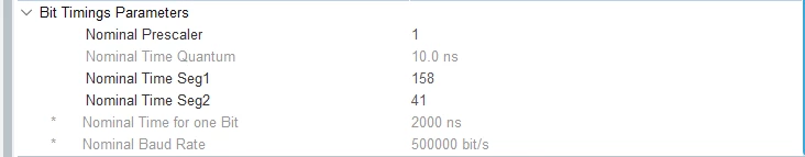

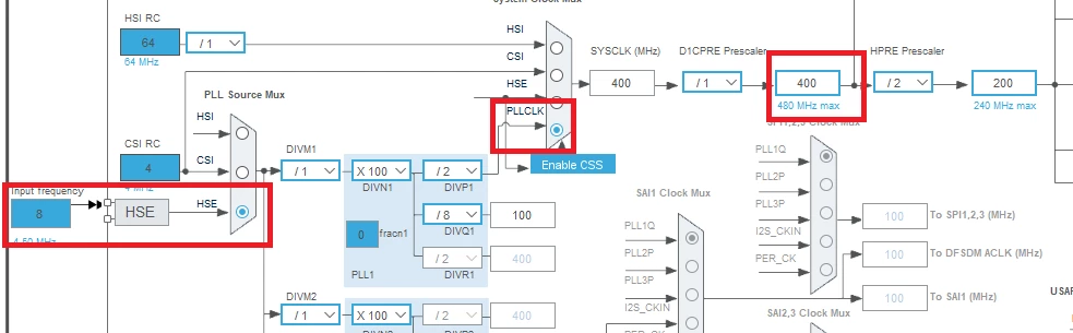

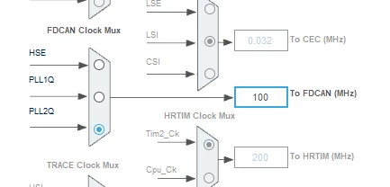

Hello @KT_Matt ,
I would suggest these timings @500kb/s for FDCAN in classic mode/ MCU running at 400MHz with an extarnal precise crystal (in your case 8MHz using STLINK MCO in Bypass mode):
I've attached the updated ioc file.
Hope it helps.
