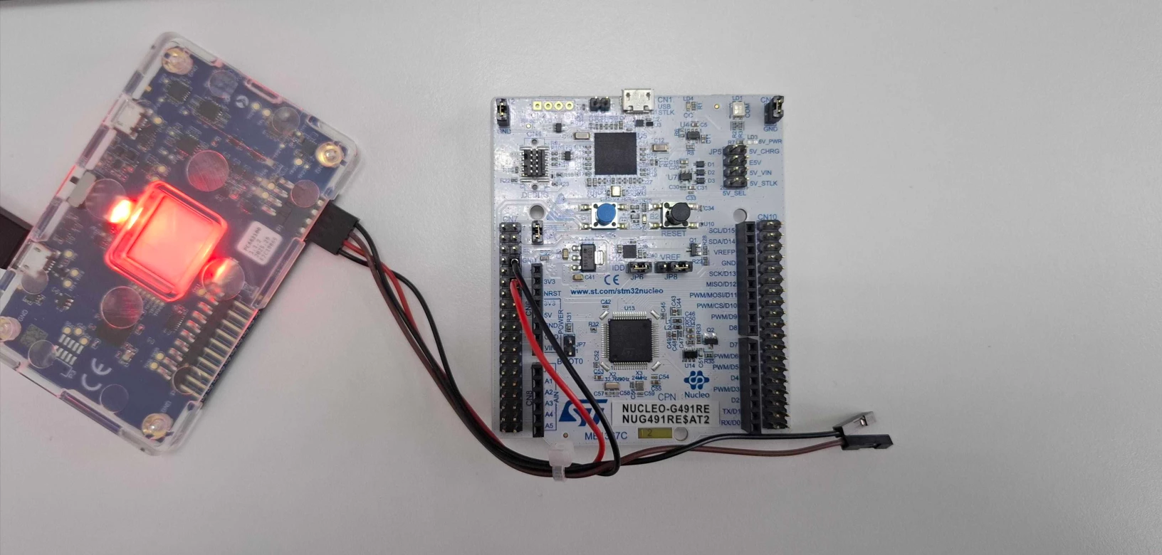

NUCLEO-G491RE Standby mode power consumption test
I have ordered NUCLEO-G491R to test STANDBY mode power consumption. The power consumption measurements are taken via the PPK2 from Nordic.
https://www.nordicsemi.com/Products/Development-hardware/Power-Profiler-Kit-2
The steps:

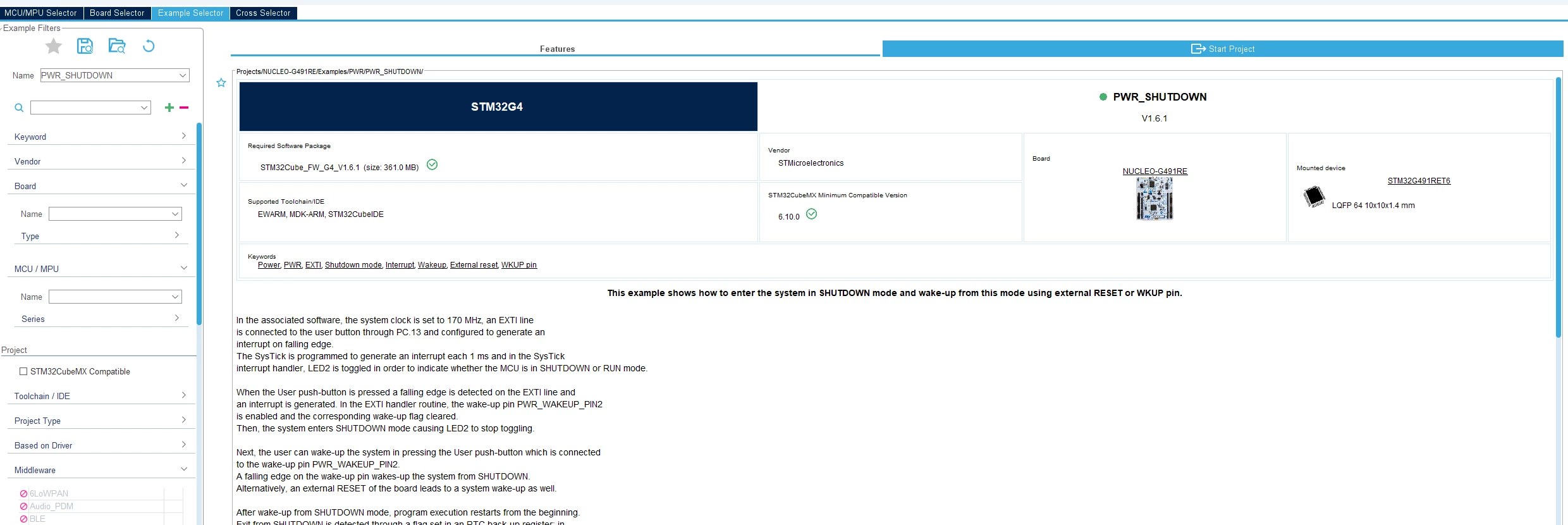

1. Take STM32CubeMX example project PWR_SHUTDOWN that is available for the Nucleo board.
2. Program the board (ensure the JP5 jumper is at the 5V_STLK position)
3. Remove the JP5 jumper because we will be powering the board via the external 3V3 (PPK2)
4. Connect the PPK2 to 3V3 and GND on the board.
5. Start sampling

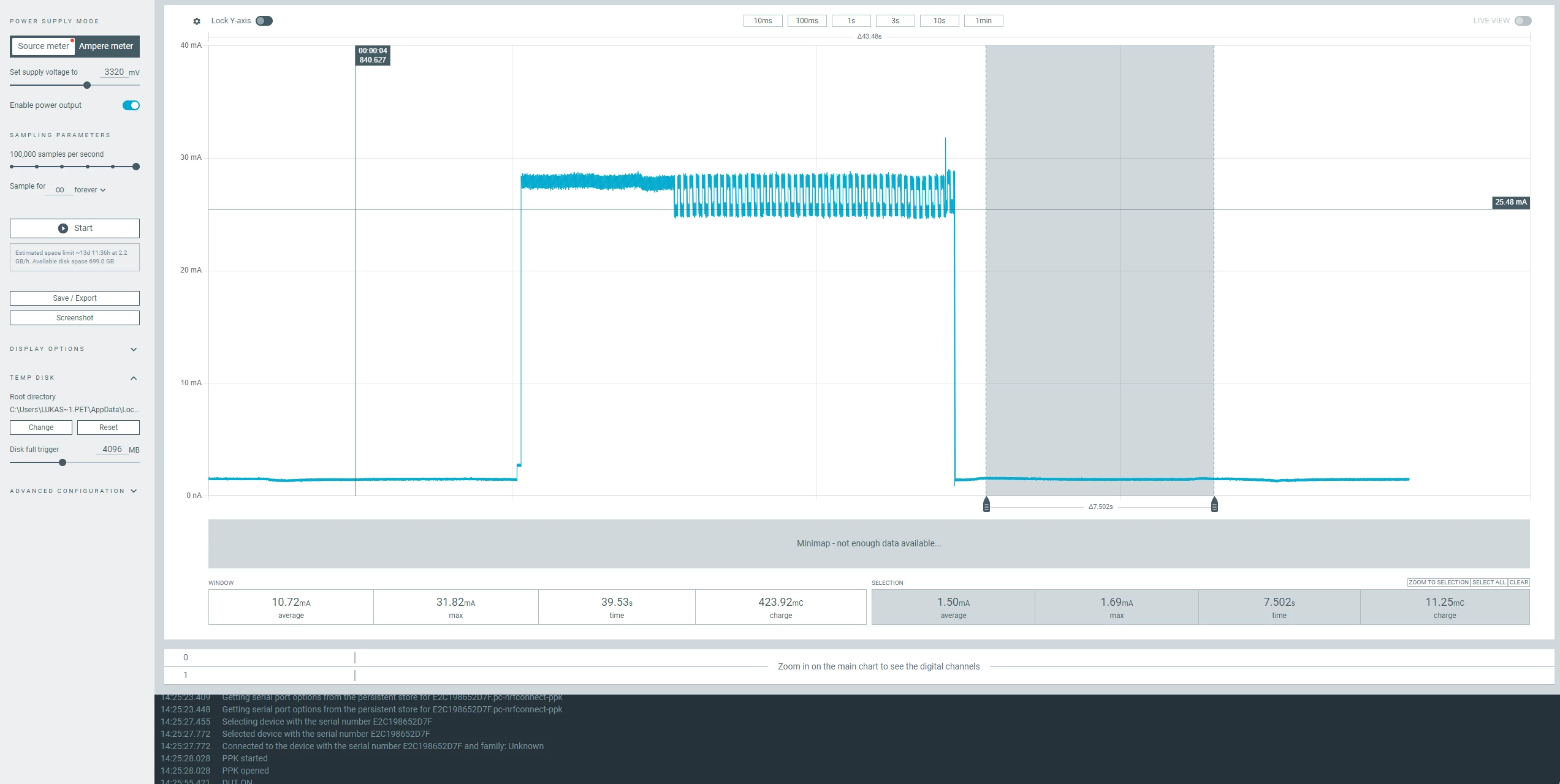

See the results below:
When the device enters STANDBY, the current consumption is measured at about 1.5mA which is way above what is declared on the datasheet.
What could be the reason that I cant achieve the declared current consumption for the STANDBY mode via the official example project? I am convinced that measurements of the PPK2 are valid as I have used this board in the past to measure very low currents and it was showing reasonable results.
Thanks in advance for any tips/suggestions.
Gyessine

Hello @LPetr.1
After further investigation, higher power consumption results from two main causes:
  • PB8-BOOT0 pin: Based on the product datasheet  it's not recommended to leave this pin unconnected, because it does not support analog input mode. If the pin is configured as BOOT0, set a defined logic level to ensure proper entry into the bootloader. If the pin is configured as PB8 by reprogramming the nSWBOOT0 option bit, it operates as a standard GPIO; however, analog input mode is not available. You likely removed jumper JP7 (BOOT0 jumper) on the Nucleo board, so pin PB8-BOOT0 is floating and causes power consumption depending on noise on this pin. Touching this pin changes the power consumption.
  • Debug registers: You probably tried to debug the project, which activated the debug registers and caused the 1.4 mA consumption. You must clear the debug registers manually after each debug session when you want to run the project again. Try to insert the appropriate code to clear the debug registers.
    You can use this code sequence :
  • DBGMCU->CR &= ~(DBGMCU_CR_DBG_SLEEP |
     DBGMCU_CR_DBG_STOP |
     DBGMCU_CR_DBG_STANDBY);
     // If your device has APB1/APB2 freeze bits and you want timers to run
     // while debugger is attached, clear those as well.
     DBGMCU->APB1FZR1 = 0x00000000U;
     DBGMCU->APB1FZR2 = 0x00000000U;
     DBGMCU->APB2FZ = 0x00000000U; /* USER CODE END Init */
Here is a screenshot where I managed to get nA consumption with these tips.
If your issue still persists, please do not hesitate to provide feedback.

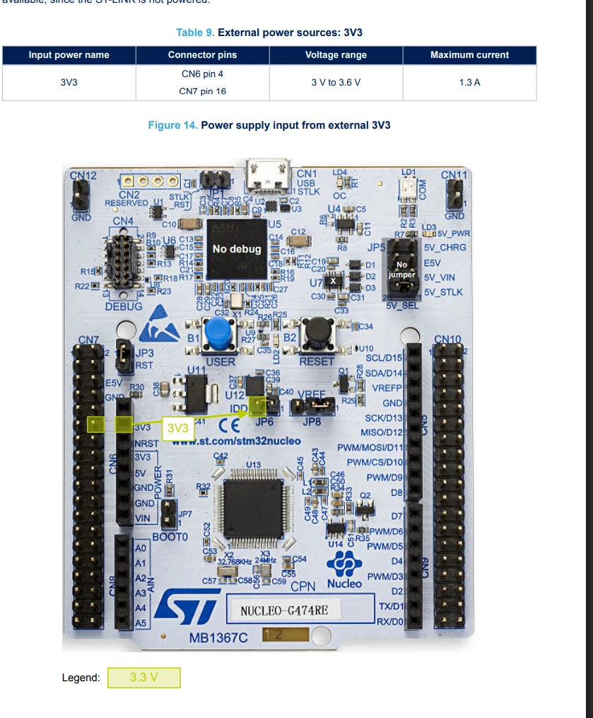

mƎALLEm
January 19, 2026
According to picture you shared, you seems measuring the current consumption of the board not the power consumption of the MCU.
You need to measure the power consumption on JP6.
LPetr.1
LPetr.1Author
Senior
January 19, 2026
Thanks for reply. Il measure the current via the JP6 tommorow.
Can you explain what else could be consuming so much power on the board?
mƎALLEm
January 19, 2026
You need to check the board's schematic. Any component consuming from 3.3V could be a source of current consumption. Check for example the availability of pull-up, pull-down resistors etc ..
When you measure a MCU power consumption, the chip needs to be isolated from any other extra components.

I have performed more experiments with the NUCLEO-G491RE board:
I have opened the following solder bridges:
1. SB17/SB23 (STLINK RX/TX)
2. SB15 (debug trace)
3. SB38
4. SB25/SB26/SB31/SB30  (external crystals)
5. SB6 (LED2)
6. SB16 (User button)
7. SB1
8. SB27
9. SB40/SB41 (SWD/SCLK)
The lowest current consumption I have captured is 170uA with all of those disabled which is still above the declared.

January 20, 2026
What is also concerning that when measuring the total board power consumption when powering the board via external 3V3, its about 1.4mA (even with all the SB's opened and disconnected)
And when measuring via JP6 is around 260uA
So despite the fact that the current consumption of the MCU is way above what it should be, I also cannot wrap my head around why the total board power consumption is 1.4 mA, even with all pins configured as analog. What could be drawing so much current ?
