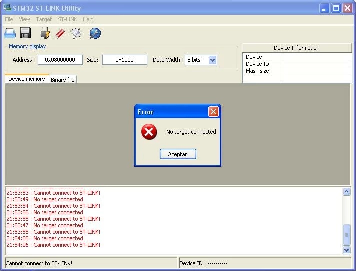

    Posted on March 23, 2011 at 22:03
    with the STM32 ST-LINK Utility also don't work. Where is my problem?
    The problem is the WinXP? The St Drivers? ...
    Thanks!
    Dunno, perhaps your ST-LINK is busted, try it on a different PC.
    If this is a VL discovery, do you still see the ''flash drive'' instantiation with the webpage/links to the documentation files when you plug it in.
    Does your account have administrative rights? Do you have some AV software that might interfere with normal operations?

    Bad News, after test with 3 STM32VLDISCOVERY and one ST-LINK in 3 differents PC's, the result is the same: ''NO STLINK Detected''. Now, I think that the problem maybe the Windows XP in Spanish. I will try to test in one PC with XP in english.
