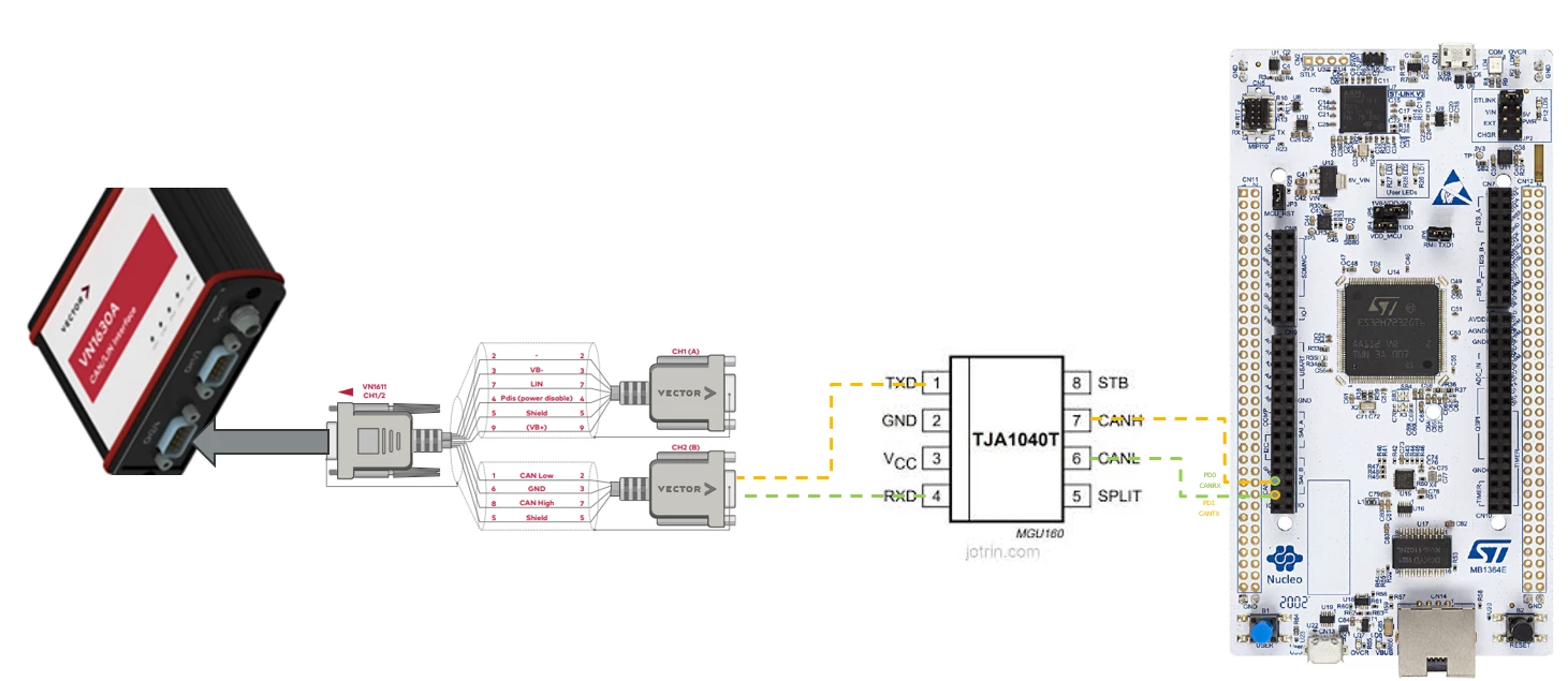

WIth the terminator resistor it works. I can now see the Transmission.
But I dont see the reception. I am sending the can frame and dont get the inteerupt hit. ANy idea what can be the problem.
mƎALLEm
May 15, 2025 3:19 PM UTC
Please be more specific and provide more details. We cannot help you if you don't share enough information with us:
1 - Please provide a clear sketch of the complete CAN bus: the two nodes + their transceivers + the two terminating resistors.
2 - Share your project, a minimal but with a complete software that can be run from our side.
Without the requested information, I cannot help you further.
Thank you for your understanding.

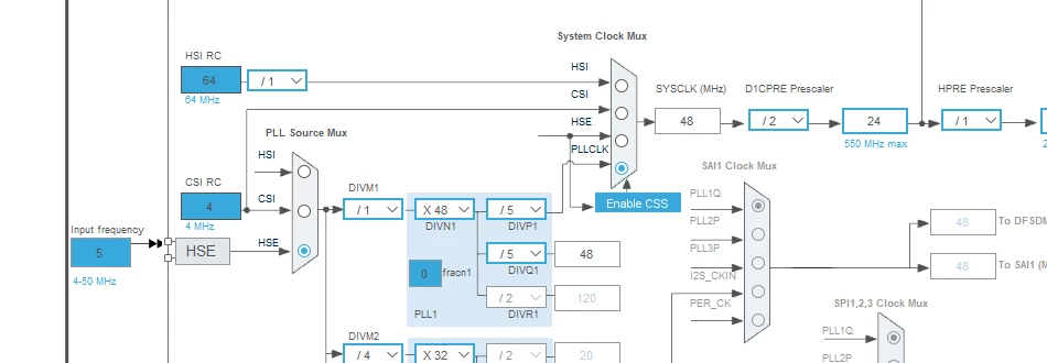

Thanks for your support @mƎALLEm  & @Tesla DeLorean   - I got the RX interrupt running.
Can you please let me know the clock settings I am using are correct. I have attached the ioc file here.
We will soon work on ADC, SPI & I2c.
mƎALLEm
May 16, 2025 8:14 AM UTC
What about the Hardware and the sketch? I cannot go further with you if I don't have a clear view of your hardware.
So please provide a complete view of your CAN bus.
I've attached the ioc file with the correct settings in RCC section.
Did you check if you have 5MHz at the output of STLINK V3 like described in the article How to use STLINK-V3 MCO output on Nucleo boards as a precise clock source for STM32 / section 2. How to get MCU target HSE fed by STLINK-V3 MCO with an accurate clock source ?
mani9989Author
May 20, 2025 12:57 PM UTC
Hello @mƎALLEm ,
I have attached the HW sketch and the IOC file.
Can you please let me know if the clock settings are right.
I am looking for can clock 8Mhhz
BR
Mani
mani9989Author
May 20, 2025 2:06 PM UTC
hello @mƎALLEm
Yes you  are coorect. So you go the picture of the setup.
CAn you check ioc for the clock config where I am looking for can clk with 8Mhz and Input Freq 24Mhz
mƎALLEm
mƎALLEmBest answer
May 20, 2025 4:13 PM UTC
No. You need to use 5MHz as Input frequency as I shared in the ioc file I've attached previously. You don't have any 24MHz source on the board. If you need your system clock set to 24MHz with a 5MHz as HSE input, this is the right configuration:
And you need to check if the STLINK-MCO is set to output 5MHz as stated in the article: How to use STLINK-V3 MCO output on Nucleo boards as a precise clock source for STM32
