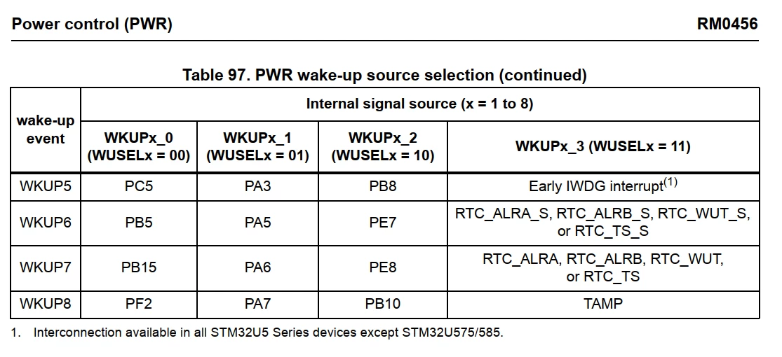

The only think I don't understand is
HAL_PWR_EnableWakeUpPin(PWR_WAKEUP_PIN7_HIGH_3);
why It's needed and is not documented ? I find that solution in another thread in the forum ( Link1, Link2 )

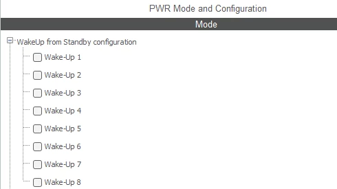

Inside IDE configuration there is the following section inside PWR
has something related? If I select WakeUp7 I only see interrupt pin PA6
Why inside IDE there isn't something related to RTC?
Can someone explain better?
