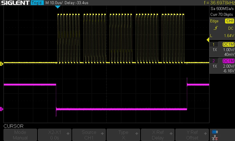

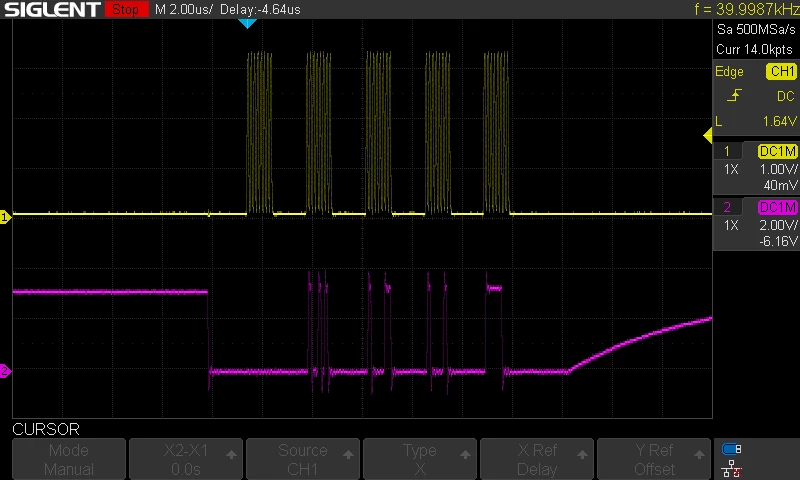

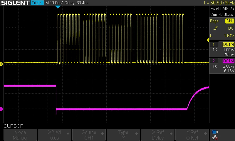

I want to make a multi transfer bytes thanks to SPI Bus. I initialize my CS as a GPIO to control it manually. My CS, MOSI and CLK works well but my MISO always return me 0...
This is some screen of the signals :
CS :0693W00000Ba11uQAB.pngMOSI :
0693W00000Ba12YQAR.pngMISO :

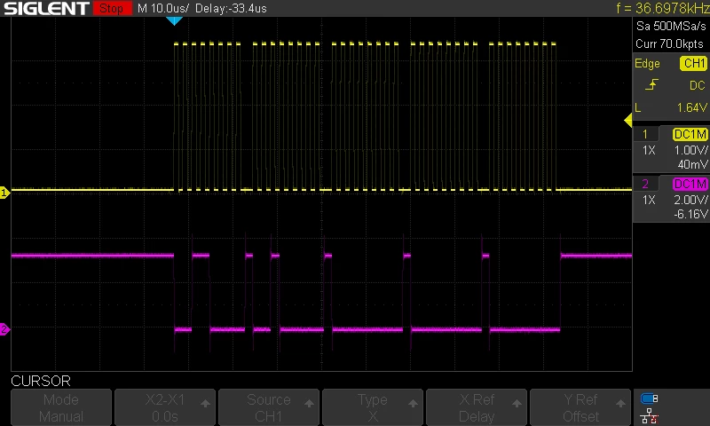

I have a screen of a workwell MISO (in the same case) if you want to see how it's should looks like :

So a STM32 is the master and the SAM3X8E is a slave? In that case, the MISO line is being driven by the slave and the STM32 has no control over it.
PierreBoss
June 3, 2021
No the slave is a screen : (https://fr.rs-online.com/web/p/ecrans-tftlcd/1931154/) and the SAM3X8E is the master

Regardless, the screen is the slave, so you'd need to verify you're taking with it correctly. Maybe returning all 0s is what it's supposed to do here.

No look at correct MISO screenshot the screen need to return me some datas ! If he returns me 0 he can't continues his initialization.
