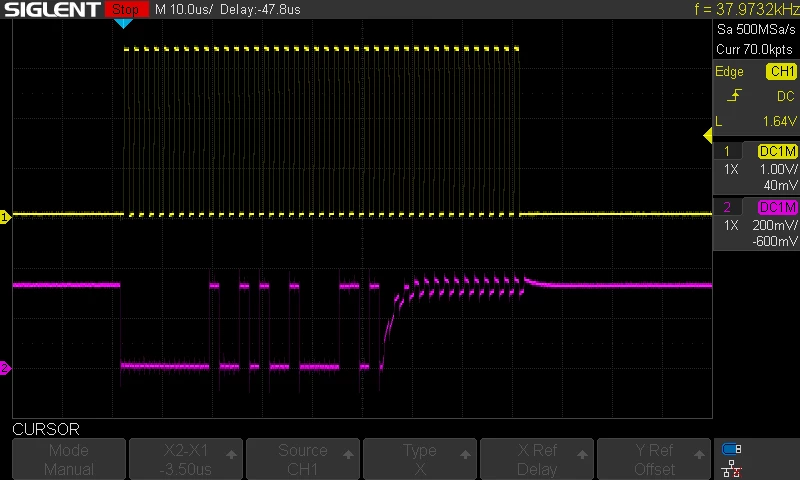

My MISO signals (SPI) always return 0 during a multy transfer bytes
  • June 3, 2021
  • 21 replies
  • 7932 views
I work with SAM3X8E microcontroller (datasheet : https://ww1.microchip.com/downloads/en/DeviceDoc/Atmel-11057-32-bit-Cortex-M3-Microcontroller-SAM3X-SAM3A_Datasheet.pdf, page 676 to 707 for SPI)
I want to make a multi transfer bytes thanks to SPI Bus. I initialize my CS as a GPIO to control it manually. My CS, MOSI and CLK works well but my MISO always return me 0...
This is some screen of the signals :
CS :0693W00000Ba11uQAB.pngMOSI :
0693W00000Ba12YQAR.pngMISO :

I have a screen of a workwell MISO (in the same case) if you want to see how it's should looks like :

I try to change my SPI settings, SPI PIN settings (MISO in input, ...) but nothing make my MISO works....
PierreBoss
June 7, 2021
Hi, I have some news!
I thought the problem was with my SPI or PIN setup but after many changes it didn't do anything.
I reworked my functions and there I have a result (which does not work yet but encouraging).
Here is my MISO signal:
We can see that there is a response from the screen. However, the 8-bit multi transfers are maybe a little too stuck (no cut between 5 transfers) and my CS resets to 1 before the end of my multi transfer.

PierreBoss
June 7, 2021
I found the solution of my problem. Everithing work thanks to this function :
static inline uint8_t transmission(uint8_t data, uint8_t reception)
	spi_write(SPI0, data, SPI_CHIP_SEL, 0);
	while ((SPI0->SPI_SR & SPI_SR_TDRE) == SPI_SR_TDRE);
	if(reception)
		uint8_t data_read, Chip_Sel_read;
		spi_read(SPI0, &data_read, &Chip_Sel_read);
		//return 0;
		return data_read;
	else
		uint8_t poubelle_data, poubelle_CS;
		spi_read(SPI0, &poubelle_data, &poubelle_CS);
		return 1;
