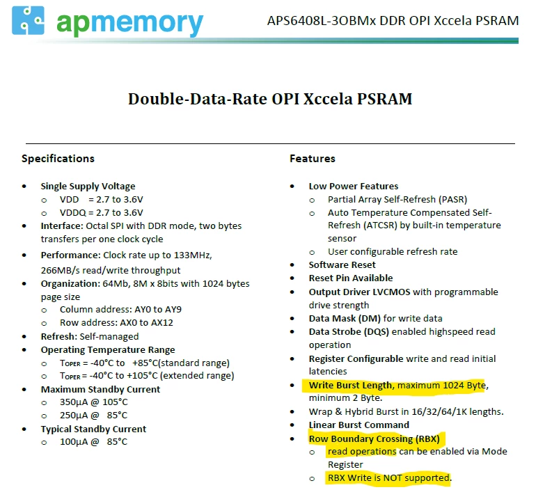

@Alex - APMemory I am trying interface APS6408L on the B-U858I-IOT02A Discovery Kit in OSPI DTR memory mapped mode for both read and writes. The datasheet for APS6408L mentions that the page size for it is 1Kb.
In the memory mapped mode, is it possible to write in a chunk greater than 1Kb for the RAM? I am read this for the memory in the datasheet,
"Burst Type & Length
Read and write operations are default Hybrid Wrap 32 mode. Other burst lengths of 16, 32, 64 or 1K bytes in
standard or Hybrid wrap modes are register configurable(see Table 20). The device also includes command for
Linear Bursting. Bursts can start on any even address. Write burst length has a minimum of 2 bytes. Read has no
minimum length. Both write and read have no restriction on maximum burst length as long as tCEM is met."
I am using memcpy for writing the data in the memory mapped mode. My question is, is it possible to write in blocks greater than 1Kb for this memory?

Hi Rikesh,
Maximum Write is 1 page (1024Byte for 64Mb, 2048Byte for 256Mb), and not limited for Read (RBX), subject that maximum burst length as long as tCEM is met.
I hope this help to reply to your question
Alex

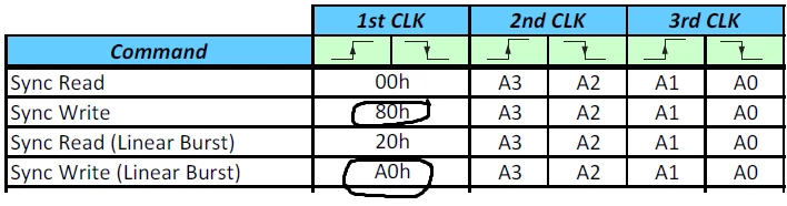

@Alex - APMemory , Thanks for your prompt response. I was assuming that the maximum write burst length of 1024 is only applicable for linear burst write(A0h). Is this true for sync Write(command 80h) as well.
I was using memory mapped mode and trying to write data using etl::copy functions,
                volatile uint8_t* flash_ptr = reinterpret_cast<volatile uint8_t*>(OCTOSPI1_BASE + address);
                etl::copy(data, data + size, flash_ptr);
Does the maximum write burst length limitation of 1Kb apply to all the write modes,
both indirect and memory mapped modes?
-Rikesh
Alex - APMemory
April 23, 2024
To your question:
  1. I was assuming that the maximum write burst length of 1024 is only applicable for linear burst write(A0h). Is this true for sync Write(command 80h) as well      =>Yes, the operating is allowed.
  1. Does the maximum write burst length limitation of 1Kb apply to all the write modes, both indirect and memory mapped modes?   => Yes, it’s correct.
Alex

@Alex - APMemory @alister One additional question, how does Row Boundary Crossing affect the memory mapped mode?
Alex - APMemory
April 17, 2024
Hi Rikesh,
Linear Burst Commands are required to support RBX Read
To write 1024B you need to write 1 full page, not crossing the Boundary (no RBX write)
This is apply to memory, whichever memory mapped mapped mode or other
Alex
April 17, 2024
@Alex - APMemory Does this mean I cannot do operation like memcpy for sizes greater than 1Kb?
HOw can I handle sizes greater than 1Kb in memory mapped mode? Appreciate if you could elaborate .
-Rikesh

I'm sorry I can't study the circumstances in detail. My understanding is:
  • You've memory-mapped the APS6408L PSRAM. That places it at an internal address space of the STM32U5. Your code may access any address of the APS6408L PSRAM via that space. For each transfer on the OSPI bus, the address phase value will be the offset of the data from the base of that space, which will be the its address in the APS6408L PSRAM.
  • If D-cache is disabled, when the CPU accesses that internal address space, the STM32U5's CPU will stall (wait) while the STM32U5 completes its transfer to/from the APS6408L PSRAM.
  • If D-cache is enabled, when the CPU accesses that address space and finds it's not in cache, the STM32U5 will first read a cache-line size of data containing the addressed data from the APS6408L PSRAM into its cache, perform the CPU's access against that, and that will remain in the cache. If the access was a write and it changed the data in cache, the cache-line will remember it's been changed and when the CPU next accesses somewhere in the internal address space that's uncached and it must free that cache line for it, it will stall the CPU for slightly longer while it first flushes the line to the APS6408L PSRAM and then proceeds to read the new cache line as described above. If your code manually flushes the cache, the STM32U5 does this for each of the lines in cache if the addresses being flushed whose data had been changed. There are several other cache circumstances that behave much like these and you can find the details on ARM's web or in ST's applicable programmer's manual. A cache line size is 32-bytes. Each cache line address is 32-byte aligned.
  • For most code circumstances, D-cached enabled will operate faster.
  • Neither the CPU nor any STM32U5 bus can perform an access at an address that isn't divisible by its access size. So memory-mapped mode should never care about row-boundary crossings because they can't occur.
Is your enquiry only technical curiosity? If you've observed an errors with memory-mapped mode, you should probably check whether the OCTOSPI's configured to wait long enough for the erase/program to complete.

@alister , I am working on a PSRAM, so I believe no erase is necessary here. My initial assumption was that with memory mapped, I would not need to worrry about the Row boundary crossing. However, I am unsure about it.
alister
Senior III
April 18, 2024
Duh. Of course!
alister
Senior III
April 18, 2024
As I'd said earlier, neither the CPU nor any STM32U5 bus can perform an access at an address that isn't divisible by its access size. So memory-mapped mode should never care about row-boundary crossings because they can't occur.
